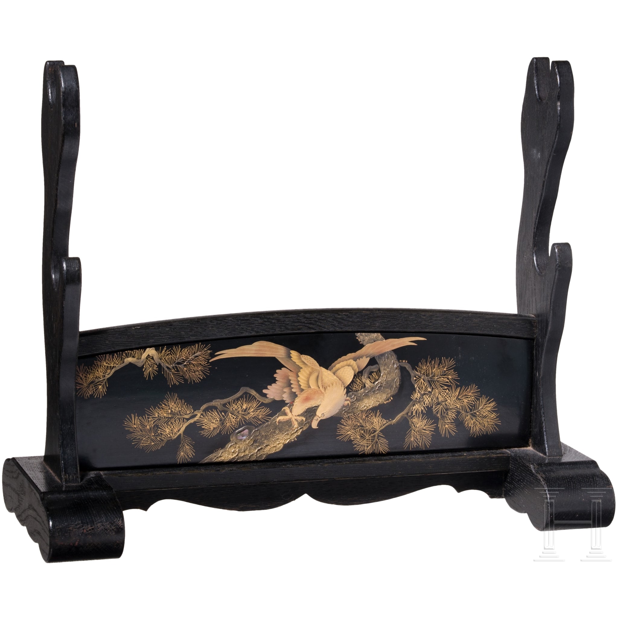

GreyVR Posted June 9 Report Posted June 9 I don't really know on this piece, (I know I don't like it.) But for the sake of debate, I'll take the opposite tack, and ask what makes one suppose it's not old? Now, before we continue, I'd like to put forward that the link claims this item is Meiji period, which means it might have been made to what the Japanese at the time believed European/American tastes were, and it was made for export. (assuming it isn't fake to start with.) The thing that stands out the most is that the people in the boats on the left side of the composition look ... like posts with heads, and the people on the right side look like people. That's a very strange artistic choice. On the other hand the dot pattern looks pretty good, so it seems likely at a minimum a real Tsuba was used to make this, wouldn't it? I also recently say in an auction a sword stand from the Meiji period that looked like it had a Japanese idea of an American Bald Eagle, (again perhaps for export?) https://www.hermann-historica.de/en/auctions/lot/id/1577041 Sold for 950 Euros. Add about 25-30% to that for commission. 2 Quote
Brian Posted June 10 Report Posted June 10 That eagle is very much a traditional Japanese depiction. Don't read too much into it. 1 Quote

GreyVR Posted June 10 Report Posted June 10 (edited) 9 hours ago, Brian said: That eagle is very much a traditional Japanese depiction. Don't read too much into it. Oh I don't mean to express a theory as a certainty.... and I agree eagles are a frequent theme, this is just suggestive by the pale head of the eagle. The American Bald Eagle stands out by it's white head feathers. On the other hand, I did find this, and it's from the Early Edo Period, significantly predating America arrival or indeed the founding of the county.... https://collections.mfa.org/objects/26037 Even so, while I might be mistaken on that object, the fact that some things were made for export is still true... Edited June 10 by GreyVR Pictures needed to be moved. 1 Quote

GreyVR Posted June 10 Report Posted June 10 (edited) 12 minutes ago, Matsunoki said: It would be good to stay on topic. From a useful detailed look at a dodgy tsuba we go onto the use of eagles in Japanese art through the ages and we bring in a sword stand for good measure. I apologize, I had wanted to bring up art for export, and it seems that took up more time then I expected. (And further investigation shows that the white tailed eagle includes Japan in it's range, and it sometimes looks just like this.) Perhaps I should delete/edit the posts to remove eagle references? I will try. (EDIT, no they have been up too long.) Edited June 10 by GreyVR Quote

GreyVR Posted June 10 Report Posted June 10 Just now, Matsunoki said: George, we have a separate forum section under “forums”…. “related subjects”…”other Japanese arts” It can be frustrating when an informative specific discussion is dragged off course….. Any aspects of export art can be kicked around happily as their own topic. Sorry, I’m just a grumpy old man🙂 Well, you ARE grumpy, but art for export is on topic, even if my example was a bad one, because "If this Tsuba was genuine, but junky... it might be junky made for the idea of what Foreigners want to buy." Which if true, would make it real. Now, I believe @brian is right and I was in error with my example of the stand, but that doesn't remove 'export intent' as an explanation for this Tsuba's look. Quote
