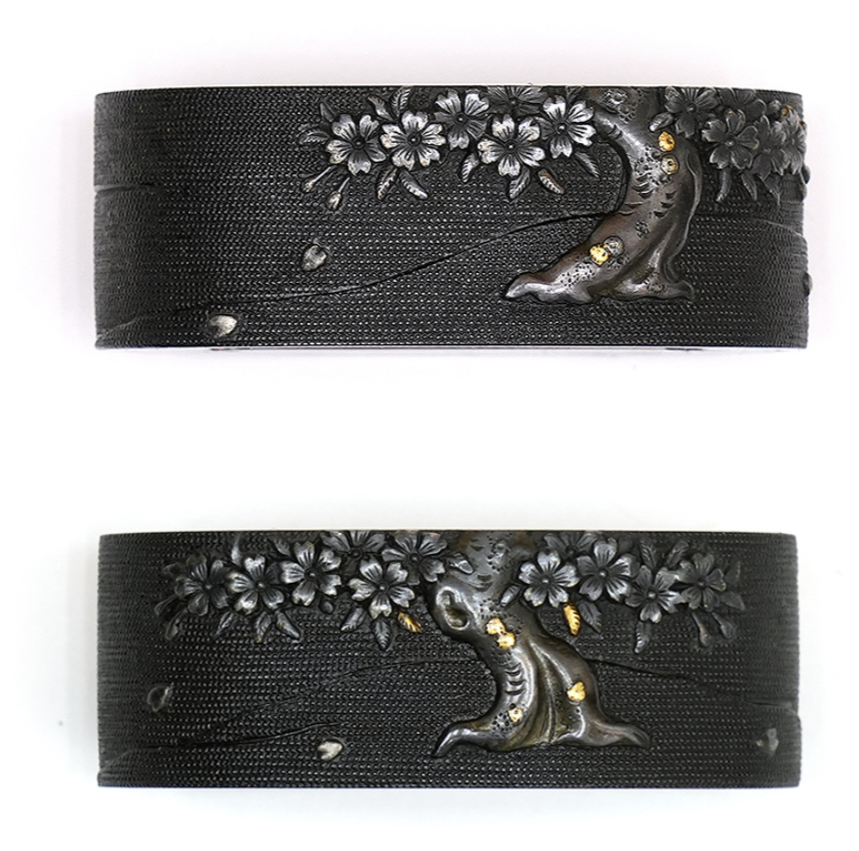

Take this matched set of two fuchi, which I'm honestly tempted by if one of you doesn't beat me to it, which feature Sakura trees in the moonlight. (For sale at Toshin, a set for paired swords. )  https://shop.nihontou.jp/products/detail/30227
But, if I bought them to someday assemble into something, what would I pair them with? I think they might look a bit odd with the somewhat generic endcaps like
