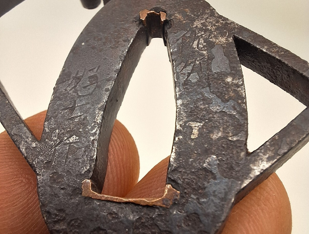

Kiko Posted June 25 Report Posted June 25 Hi everybody, talking about coating and R. E. Haynes, I got this tetsu-sukashi piece depicting koto bridges and signed Yoshitaka from the Czerny's auction of his study collection (n°154). Does this looks like characteristic urushi flaking out to you ? 1 Quote
ROKUJURO Posted June 25 Report Posted June 25 No, this looks very much like scale, so this TSUBA has likely been in a fire. Usually, URUSHI does not flake off. The photo quality does not allow to read the signature. Is it a KINAI TSUBA? 1 Quote
Kiko Posted June 25 Report Posted June 25 (edited) Thanks Jean ! The piece is said by the catalog to be inscribed Sashū jū 佐州住, so Sado province / island, but honestly only the second kanji seems still readable to me. I didn't expect the fire to produce a surface texture that looks so much like peeling paint, I’d really like to understand the chemical process. But are you referring to exposure to a fire, or to something intentional during the manufacturing process? Edited June 25 by Kiko Precision 1 Quote
Bugyotsuji Posted June 25 Report Posted June 25 Nicolas, nice design! Can you get a clearer shot of the Mei? Quote
ROKUJURO Posted June 25 Report Posted June 25 7 hours ago, Kiko said: ....I didn't expect the fire to produce a surface texture that looks so much like peeling paint, I’d really like to understand the chemical process. But are you referring to exposure to a fire, or to something intentional during the manufacturing process? It is certainly not intended but accidental fire damage. Scale is highly oxidized iron (Fe2O3 x FeO = Fe3O4). It is called magnetite, and in case you can peel off a tiny bit*, you will see that it sticks to a magnet. Peeled-off paint will not do this. Other than sword blades, TSUBA do not lose their functionality after being in a fire, but scale is considered a KIZU. * It will not come off easily as it is harder than the base material, but quite brittle. Usually, you will have to tap it carefully will a small but hard tool like a metal-file. You could also try to scrape it off carefully (again) with a sharp knife without damaging the metal underneath. 1 Quote
Kiko Posted June 25 Report Posted June 25 (edited) Thanks again Jean, I should have thought of the magnet test! Just tried but unfortunately (?), the layer doesn't come off as easily as one might have expected, and I have to admit that—while I’m very keen on gaining knowledge—I’m a bit afraid of damaging the piece further. The last time I faced the dilemma of using a saw for scientific purposes, I eventually pulled some strings to get the tsuba into a public lab for a quick CT scan, so perhaps I’ll think up another scheme… Thanks, Piers ! I admit I was won over by its elegant simplicity. Here are the best photos I managed to get of the signature; it is truly very shy and difficult to reveal. I hadn't paid any attention to the signature until now; even with the best will in the world, I really wonder how one is supposed to find "Yoshitaka saku" (吉高作) there, as stated in the catalog! If it is a mistake—and it wouldn't be the only one in this auction—perhaps someone who owns Haynes's *Gai So Shi* could take a look at entry number 131 to see what it says; unfortunately, I do not have that publication. Edited June 25 by Kiko Precision 1 Quote
ROKUJURO Posted June 25 Report Posted June 25 Nicolas, your photos are good but the condition of your TSUBA not so much... I think I can read SASHÛ, but I don't think YOSHITAKA would be correct as YOSHI appears to be chiseled just before SAKU. So TAKAYOSHI would be closer, but the first name KANJI is not TAKA I think. But we have experts here in the TRANSLATION section who will certainly help, so please try it there! Concerning the condition of your TSUBA, I think it could be restored, but not with little effort. Scale will come off with moderate blunt force, that is, you tap on it and it comes off - or not! This method may leave marks on the metal underneath. A mechanically softer but in fact more brutal method is the use of acetic acid ('concentrated vinegar'). It will strip the TSUBA from the scale, but you will need a complete patina restoration afterwards. And of course scale is TSUBA material (= iron) turned into oxide, so there will be a loss of material. Another thing is the thickness of the scale. It builds up as long as the object is exposed to high heat. In your case, the scale layer is quite thick in my observation, so it must have been quite a big fire it was in. Quote
Kiko Posted June 25 Report Posted June 25 (edited) I quite agree, Jean; the condition of this guard is rather sorry—and I must say, my photos reveal this even more starkly than I had previously noticed. Had I made the trip to Italy in person, I likely would have passed on it, despite its undeniable aesthetic appeal. However, since one cannot bring items back directly—as obtaining export papers often takes a good two months—I preferred to bid cautiously from Paris; in the end, the guard cost little more than the shipping itself. Consequently, I am inclined to preserve it exactly as it is: it was a study piece, and a study piece it shall remain—plus, I am now better equipped to appreciate certain surface details in the future! As for the signature, I fully agree there as well; I cannot imagine by what miracle it could be read as "Yoshitaka." I’d also like to take this opportunity to apologize to Hokke for shamelessly hijacking this thread! Edited June 25 by Kiko Compulsory editor there 1 Quote
MauroP Posted June 27 Report Posted June 27 The signature is indeed Sashū jū Yoshitaka saku, but written 佐州住 好古作. 2 Quote
