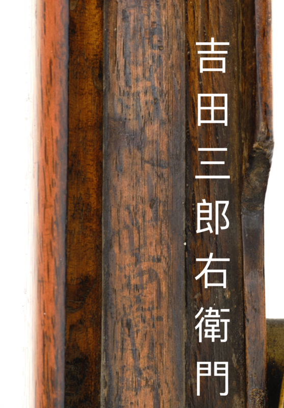

The stock is also signed, but harder to decipher. The regular camera doesn't pick up much but with an infrared microscope I've managed to read some more and I'm certain of:
 . 田 . . 右衛門 . .
Possibly 吉田三郎右衛門 Yoshida Saburouemon?
Does anyone here have access to lists of stock makers to see if we can find him? Enju was active around the mid-19th century.

One of the few characters that's crystal clear is 右 (and 門) so it cannot be either of those two.
On the rest I'm not so sure. There are marks of gouges for cutting the channel dat have darkened, creating lines that are easily confused for strokes which makes it difficult.

Here a possible interpretation. Notice that for example with 田 two gauge cuts that turned dark make it look more like something like this 羽 but the true character is still seen faintly. I am the least sure of 三郎, that's mainly a guess because it is so common.
  • Wow 1
Often I have been surprised to find that these two 左右 look very similar in grass writing, almost indistinguishable to my eye. In this case however, the mouth part does look relatively clearer. The records often confuse the two, (gun registration cards are particularly bad), so I would not be unduly worried if they don’t match up.
