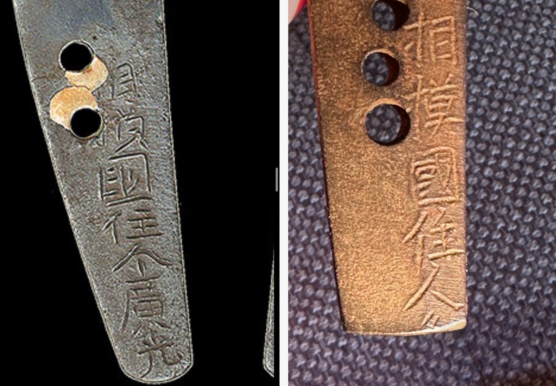

8 minutes ago, Bugyotsuji said:
相模国住人久義
Have you considered?
Hisayoshi is an ingenious suggestion! Thanks Bugyotsuji. My thoughts are that the blade came from a Nanbokucho tachi, I am reading that two Soshu-den Hisayoshi’s worked in the Muromachi, and later Shinto eras. So, chronologically it might not fit, unless I’m wrong about the Nanbokucho tachi. Hence my focus is on Nanbokucho smiths. Thank you very much for taking the time to share your thoughts though :)

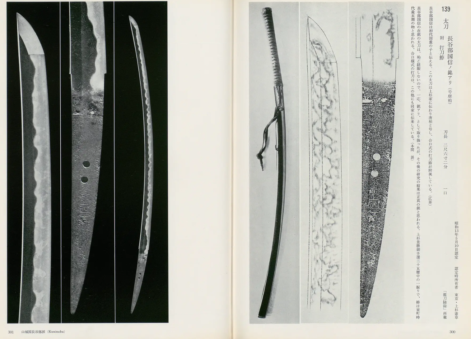

Soshu works are mostly Mumei, but here are a few examples.
(Juyo Bijutsuhin Hasebe from Nanbokuchou, Mei on Hakiomote)
图像
(Juyo Bunkazai Akihiro, specifically labeled as Kodachi at 63cm, Mei on its Hakiomote)
(Many, many signed Soshu master Shizu Kaneuji's Tachi from Nanbokuchou, Juyo Bijutsuhin and Bunkazai, the go-to when praising a later-time Soshu style work, "Wow! this sword reminds people of Shizu!")
Actually, I would love to see enough exceptions from the Soshu masters where their Mei on Sashiomote and being labeled as Tachi or Kodachi by the officials.

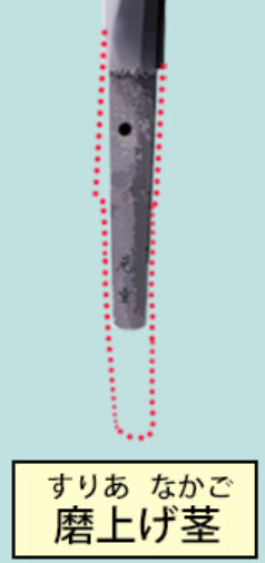

Lastly, I'm going out on a limb here, asking, is there a little confusion about how the Suriage process works...?
Because a sword like this could never reach 69cm in its original size. Suriage is a one-directional process, cutting a sword's Nakago and turning the bottom blade part to new Nakago part.
(In this case, like this.)

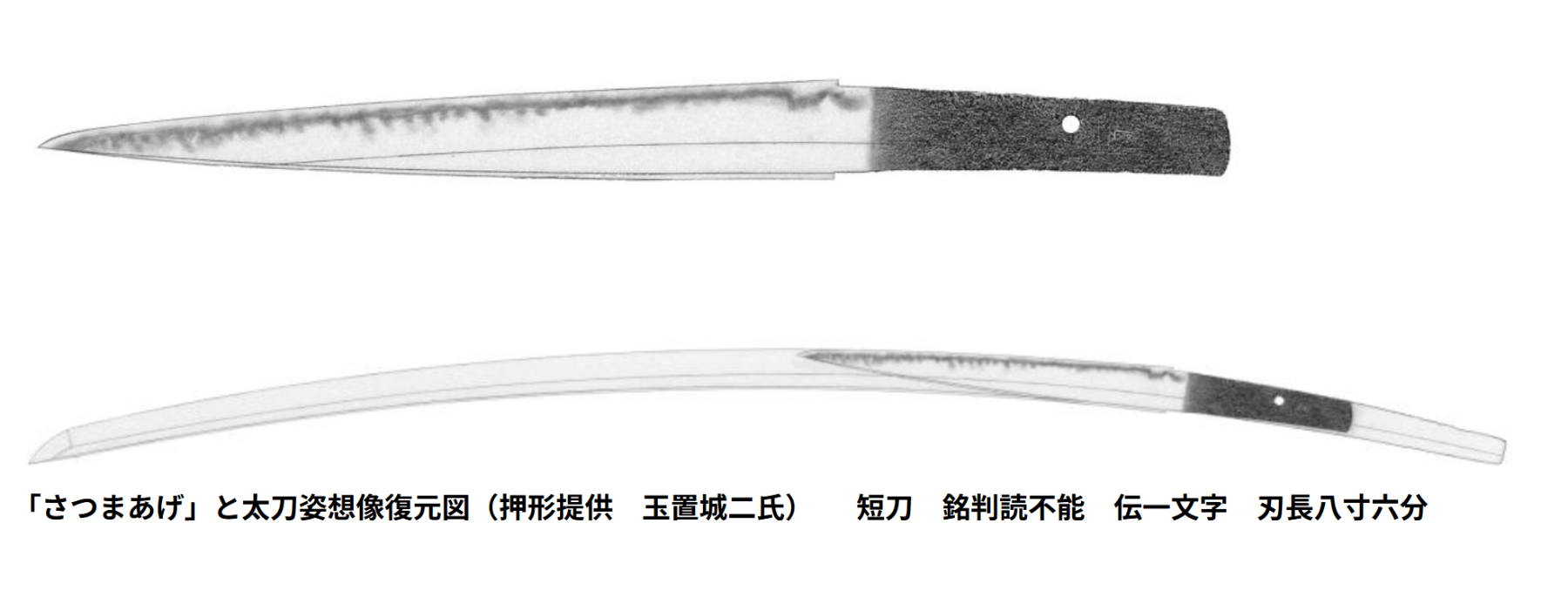

Many people would get this wrong, but one can not Suriage a Kissaki (unless an unlikely scenario of an Ichimai Boshi), they are shortened mostly due to damage.
Because Boshi, like Hamon, are fixed, and a sword loses most of its value when the last of the hardened are on Kissaki is lost.
(in extreme cases, a Boshi-less sword became what we call Satsuma-Age.)
(And the Kissaki of your sword seems fine, I think. Perhaps 1 or at most 2cm lost?)
So you can't "gain" extra original length from the Kissaki part, just the bottom,
which is very limited because of the remaining Mei part, giving no more than 10cm of room in the most ideal circumstances,
making your sword no longer than 60cm originally, like other has pointed out.

I want to add that the overall signature style does not seem to coincide with known signatures of Hiromitsu, take this signed Juyo Wakizashi below:
(It is signed Sagamikuni Jyunin Hiromitsu not Sagami Koku Junin, but you can clearly see the differing execution and position of Mei.)
