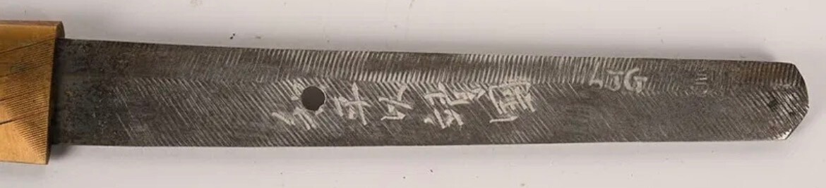

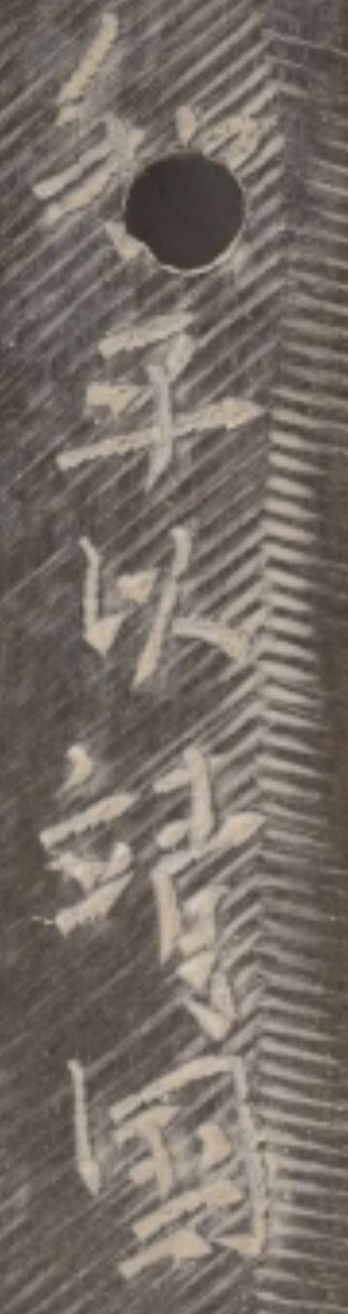

I found this mei on internet. So I try to translate the kanji.
I have identified the first part of the inscription as 和平以, but I am having trouble deciphering the last two characters.
I would be very grateful for any help in identifying them.
For reference, there are no other inscriptions on the opposite side of the blade.
Thank you for watching this.

Hi! The last two characters are 靖国 (usually read as Yasukuni).
和平以靖国 might read something like 和平を以って国を靖んずる in Japanese (to make the country peaceful/well with peace).
Edited: random(?) fact, 靖 and 安 are both Yasu in Japanese with similar meaning and usage, so......

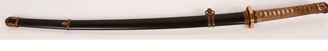

Watch out there tiger :] it’s a match.
https://casiberia.com/product/yasukuni-captains-gunto/sh2444
https://www.samurai-katana-shop.nl/en/katana-samurai-sword/buying-sword-paul-chen/forged-katana-sword/yasukuni-captain-s-gunto
@Scoggkick it to fakes

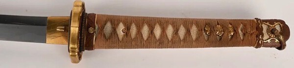

These guys bought replica and gave it to their dog for some bite marks.
It must be made with fraud in mind, tassel is obviuously wrong.

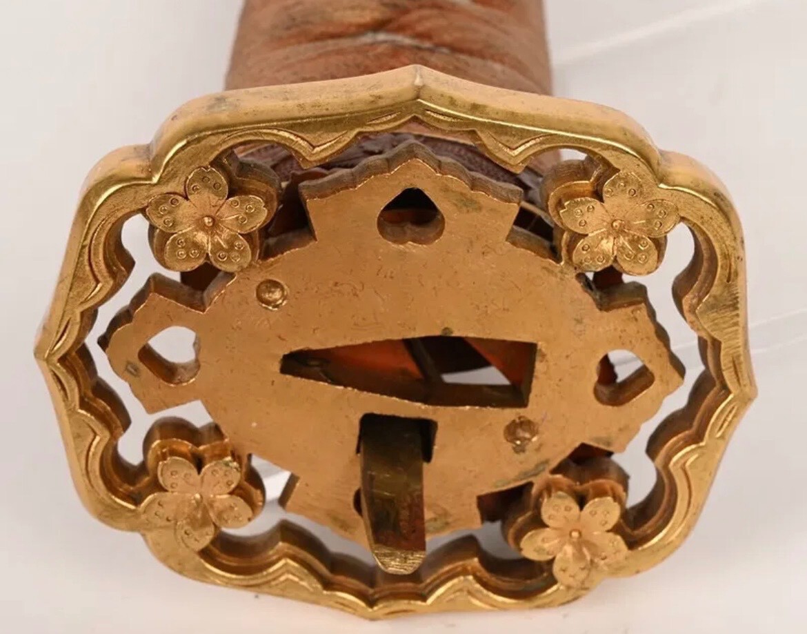

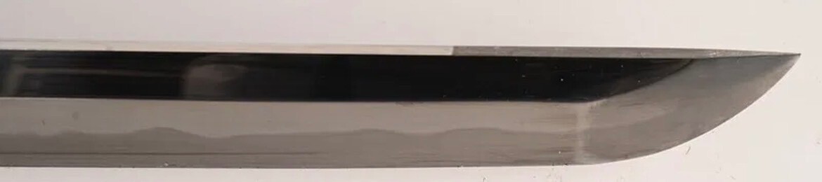

"Beautiful Katana with bright blade with 26" cutting edge. The blade is bright with an active hamon. The one hole tang is signed. The Katana has shin gunto mounts and saya. The tsuka has ray skin grip and silk wrap. CONDITION: The Katana is very clean throughout and only shows minor wear. A very well preserved example. Excellent"
I wrote to them. 200$ bp isn't worthy bad reputation.

Second version "colonello" :D Production started 2009
Paul Chen Yasukuni Captains Gunto swords PC2444

T98 looks to fresh. Could this be this Yasukuni replica? It came in 2 types.
I forgot the auction. Because I decided to buy another good sword. Also I didn't find same tang information and this was a big clue. Wow, fake.. very intersting. Thank you so much! Have a good day!!
