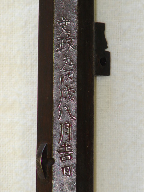

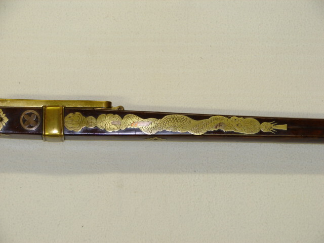

This gun is signed made by Kuniyasu, and is dated 9th year of Bunsei, ( 1825 ) a lucky day in August. Overall length is 51 1/2 inches. The caliber is 11.5 mm ( .46 inch ) or in Japanese measurement 2 monme. Barrel is octagon tapering towards the muzzle which is bulbous. The front sight has an inlaid silver bead to aid in sighting. The top of the barrel is inlaid in brass, silver, and copper with a depiction of KWANYU ( a celebrated Chinese General of the 2nd century, diefied in 1594 as the God of War ). He is depicted carrying his large spear. The depiction is flawlessly inletted into the steel barrel.

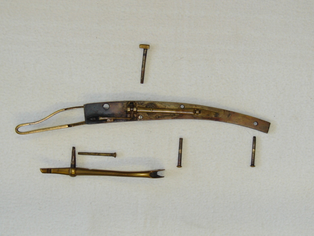

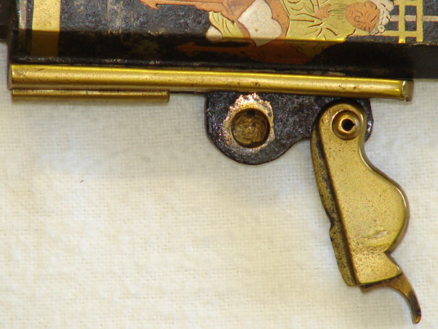

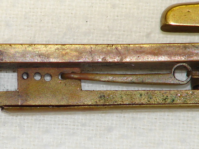

The brass lock is of the outside spring type, but the inside has a small coil release on the sear re-lease arm. There are no less than 5 adjustments fot trigger pull. In order to prevent the corrosion and burning associated with the ignition of black powder, the flash pan is lined with gold. The entire lock mechanism works like a fine tuned clock.
The stock is of fine grained burl oak, and the escutcheons over the pin holes are large and ornamental. In addition a single brass band ( not counting the large breach band which are always present on Tanegashima ) helps anchor the barrel to the stock. The floorplate of the stock has a well executed brass dragon entwined around a silver ken sword. The inletting of this huge piece of metal must have taxed the stockmaker. A circular mon in silver of the Abe family is also inlaid. Near the forend another brass plate depicting a dragon helps strengthen this vunerable area of the stock. The offside of the stock butt has a Chrysanthemum in alternating rings of brass and silver, the hole in the center is meant to accomodate the excess of match cord, and keep it firmly secured to the stock.
The condition of this firearm is excellent, and would be quite safe to fire. This short article, and accompanying photos are respectfully submitted for the study and enjoyment of the NMB membership ..... Ron Watson

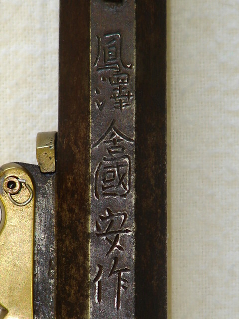

Ron, the signature is quite interesting, but I think whoever took the photos must have missed the first characters for Kunitomo, which made my search a bit longer!!! All you have posted seems to be:
鳳澤 舎 国安 作Ho-sawa (-zawa?) sha Kuniyasu saku
First I found that the Mei Ho-sawa is recorded in a list of gunsmiths in Ko-shu 甲州 (甲斐)the present-day Yamanashi Ken, whence Takeda Shingen came. The third character has the meaning of Yadoru, 'temporarily living', or 'temporary abode'. Later following a few hours searching (!) I found that Kuniyasu is listed as a Kunitomo smith, but was he temporarily living in Yamanashi when he made this gun? The full signature should therefore be Kunitomo Ho-sawa (-zawa) Sha/Yadoru/Mi-o-yoseru/kari-ni-sumu Kuniyasu Saku, right?
Admittedly the gun looks like a Sakai-zutsu, but being in fierce rivalry with each other , many Sakai and Kunitomo guns were almost indistinguishable. It may be that your gun looks restrained because it is in fact a Kunitomo gun, which were not generally as flashy/bling, or ostentatious as you say, as Sakai.
PS I think you'll find the Chrysanthemum is an ashtray, for extinguishing the matchcord after use.
In the records of gunsmiths there is
国友平八国安 甲斐国住 享和三年
国友鳳澤舎国安 甲斐住
There are also a couple of smiths listed not under Kunitomo, but like this:
鳳澤国重 甲斐住
鳳澤金平左衛門国重 甲斐住
鳳澤舎 国久 甲斐住
Those are all the recorded smiths of this school (?) that I can find.

The inlay work on the barrel, .... the stock, ... I most definitely attribute to the Sakai. It has been written ( bottomley & Hopson ) that Daimyo often sent barrels by other makers , .. eg. the Kunitomo to Sakai for mounting. I believe this to be the case in this example. This is the most logical explanation, .... and given the final work was carried out by the Sakai, ...... I assigned the gun to the Sakai verses the Kunitomo.

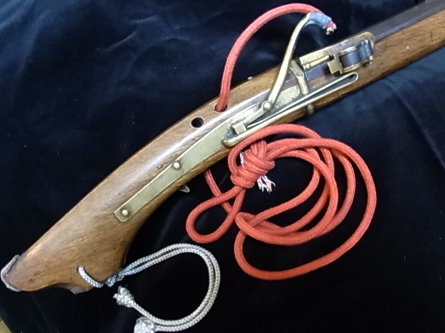

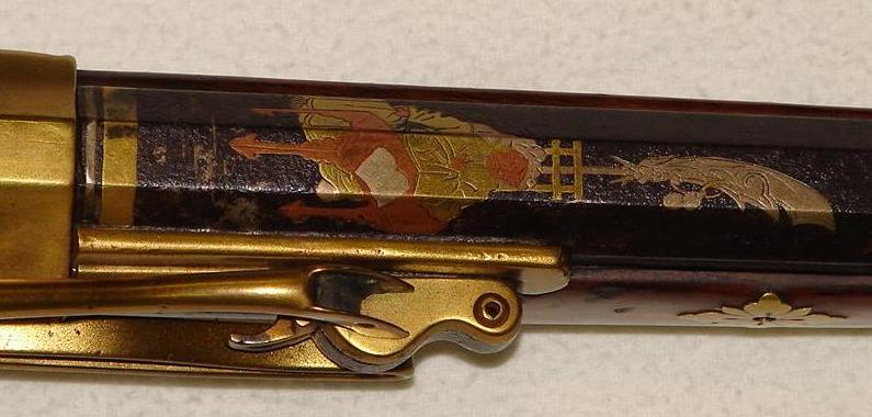

Next, ...... the idea that the Chrysanthemum on the off side is really an " ashtray " as opposed to a match holder I again dispute, ... please see the photograph I add to this posting showing another Tanegashima with the same Chrysanthemum. NOTE, ... the natural alignment of the match running from the serpentine thru the stock, and into the Chrysanthemum. This should be proof in itself that these Chrysanthemum stock inlays are for holding the butt ( un-lit ) end of the match. They may well have served as a convienient ashtray, but I heartly dispute that this was their intended purpose. They are DEEP in all examples I have observed, .... making it all the more plausible they are indeed match holders. One does not need an ashtray on a firearm to extinguish the match. Perhaps this is erroneous information came from your Japanese firearm instructor, ... and I would suggest he is quite incorrect.
I thank you all for your interest, and hope the attached photos will aid in further study and understanding of what is a most interesting field of Samurai weapon/art. ...... Ron Watson
NOTE: First photo shows a Sakai style Muzzle.
Second photo shows the natural alignment between the serpentine and the Chrysanthemum Match Holder.

PPS Your gun also has influences of Sendai in it! (The trigger etc.)(Or am I beginning to see things?) :lol:

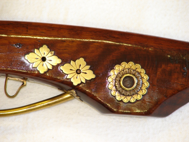

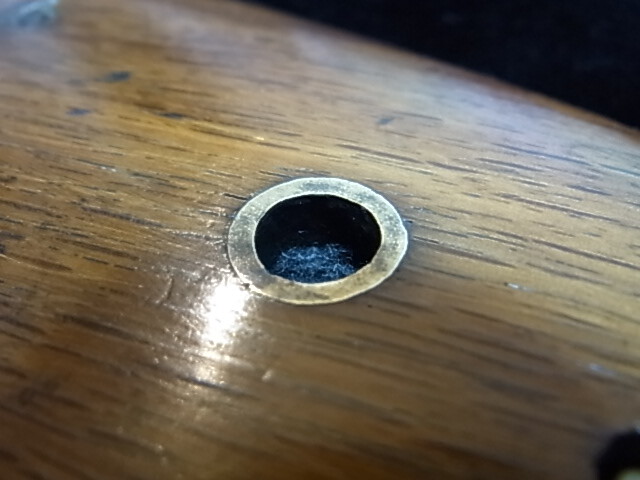

Here is a little more food for thought regarding the decorated Chrysanthemum stock cavity question.
1. The depth on both examples I have in my collection measure 3/4 of an inch, .... a little deep considering the diameter for an ashtray ( fuse extinquisher ).
2. If they were meant as a convenient way of extinquishing the match ( in lieu of a little spit in the palm of the hand for example ), ... why are they never located on the lock side of the stock which would be more convenient.
3. The other gun stock example I pictured shows the hole drilled thru the stock not perpendicular to the gun's axis, but rather on an angle leading directly next to the Chrysanthemum cavity indicating it was meant to lead the match in that direction.
4. A small amount of pitch if necessary at all ... would have been more than adequate to hold the match secure. Personally I think given the depth, friction fit would have been quite sufficient.
5. This Chrysanthemum feature IS NOT found on most " combat " guns, ... but rather on guns obviously of high class meant for show, or for the target range, ... in which not a great deal of match was necessary. At any rate allowing the match to hang would have easily allowed for a couple or even three feet of match, ... more than enough for the purpose at hand.
6. Certainly a great length of match might or would be desirable when going into actual combat, and of course wrapping the match about the arm was the more practical, and consequently the Chrysanthemum feature is not found on these plainer weapons.
7. I have serious doubts about Sugawa san being deemed an expert on firearms. He is at best a collector who published a primer in English on the subject. He certainly has not spent the greater part of his life in the study of firearms, ... albeit he is to be credited with introducing the Tanegashima to the average Westerner who until his publication had very little in the way of material to study.
I think if you will consider the above, ... you might if not agree concede that what I say has validity. Being a smoker myself, ... I find using a lit cigarette in the serpentine beats using a piece of clothes line. I've just never considered butting my smoke out in my Tanegashima :D ;) . ..... Ron Watson

Hi Ron, some quick thoughts regarding your points above.
1. Yours are very deep. Mine is shallower. I am beginning to wonder whether the original straight-through hole was under-used and someone tried blocking it with whatever, and then they disovered you could get away with half the hole and half the decorations (= half the labor/labour) during manufacture. This may explain why there is so little literature on this feature, and only later guns seem to have it in this form.
2. From personal observation I agree that it is located in an inconvenient place for me, especially when my hands are full of other clobber. The other side would be better. Our matches are seriously hot however, and even with a large dollop of spit you would have to have very horny hands to avoid getting burnt. You would then have the problem of relighting if such became suddenly necessary.
3.About the angled hole you mention, my long gun has two of these in parallel. These holes would be the ones mentioned in the line above the line quoted, in the description web page.

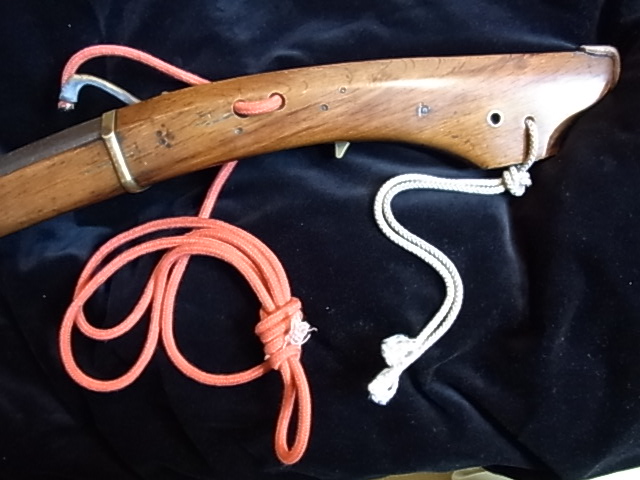

All, I have just had a look at the chrysanthemum hole on my Sakai gun and it is drilled all the way through, being as near as enough the same diameter as the diagonal match tunnel. There is therefore nowhere on this gun to stub out the match. It would be possible to thread a length of match through the tunnel and then through the hole to the right side of the stock.

Ian, if that is a sheath for a pricker, I can imagine it would stay in if the gun was pushed down into a horse's holster, but would it not slide back out when lifted up into the firing position? Thought-provoking pics. Many thanks.

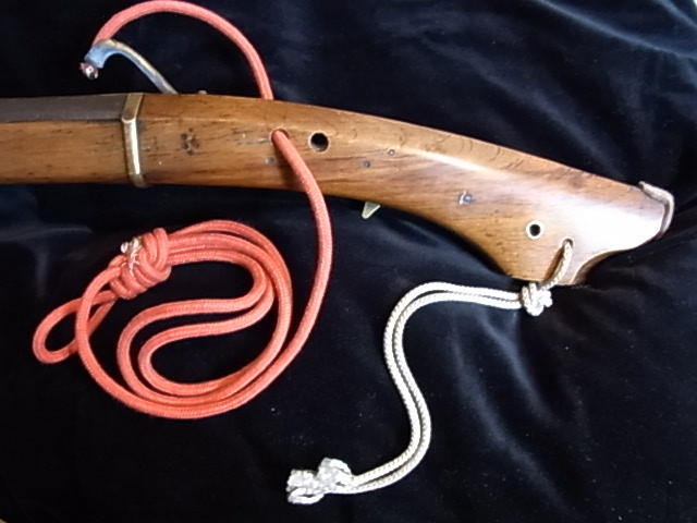

Further to the above post, I include some shots of the quite shallow ringed hollow in the butt of my Kumamoto Castle gun. (I think a small bird might have made a nest in there.) You can also see the two parallel match holes and a separate narrower hole for a decorative lanyard.
Dear Ian,
As you state the Chrysanthemum cavity on your gun could NOT have been a snuffer, ... I would then conclude it held the unlit end of the match. I am beginning to think that this feature found on some tanegashima started out as a match holder, and as time progressed eventually became shallower until as in Pier's gun is very shallow becoming as Piers argues a match snuffer. An evolutionary sequence, or a feature that some gunsmith invented for one purpose ( holding the match ), and some more distant ( without our communication systems of today not necessarily very far ) gunsmith mistaking the original idea to be a match snuffer and consequently building his Chrysanthemum cavity not nearly so deep. This may be the plausable explanation, as I must agree that the example on Pier's gun is no where deep enough to hold the butt end of the match securely, .... whereas the examples I have, and you possess would.
