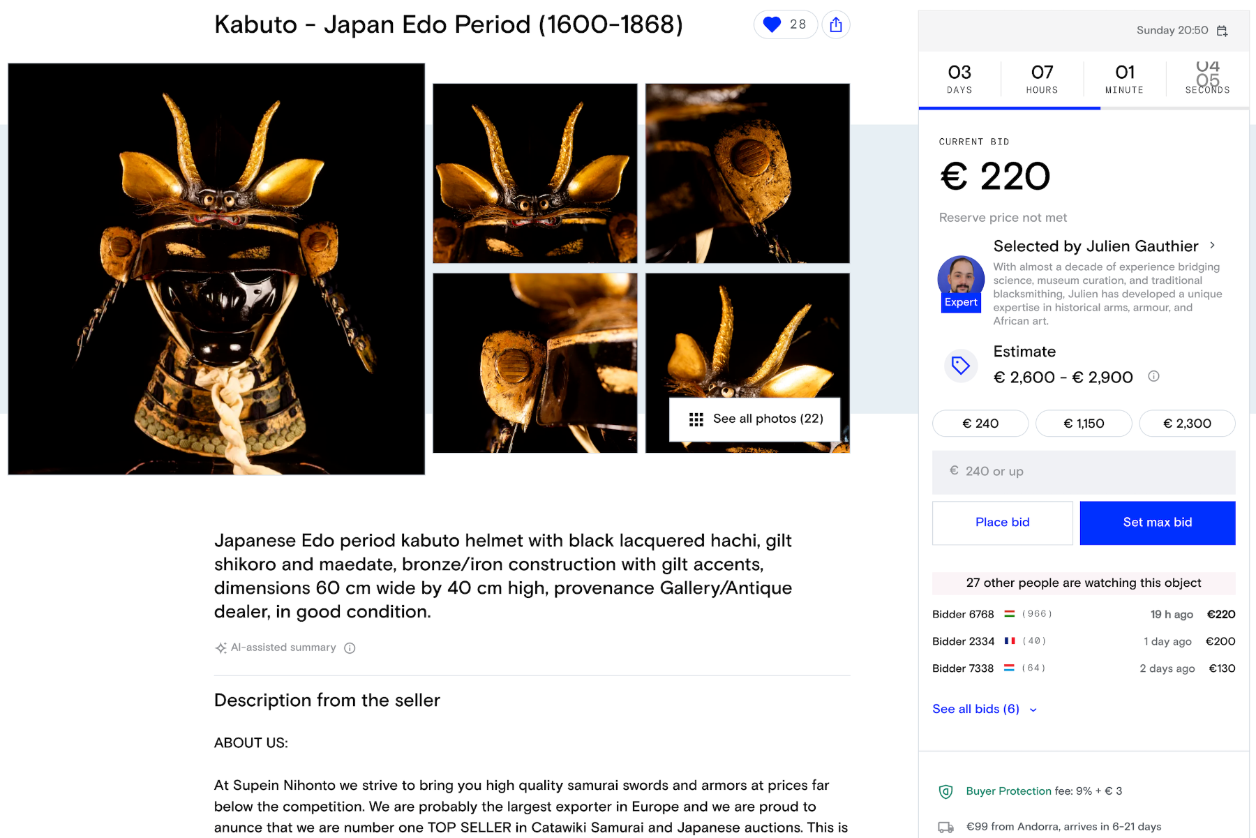

Now I came across this Catawiki auction for a kabuto that sparked my interest such that I'm considering buying it. The problem is however that A. it's Catawiki where provenance and experts don't mean anything, and B. the seller is Supein Nihonto, while researching this seller I came across this message board with it's wealth of information warning that one should be wary of this seller. Hence I registered and posted this topic :)
Before moving to purchasing I have so many questions, but I think the most important ones are:
  1. Does this set look period correct to be from the Edo period?
  2. Is it likely that all pieces are from the same set, or is there something clearly sticking out here as it looks to be made way later or earlier than the other pieces?
  3. If it is period correct, is this worth anything near the estimate? I know that worth is subjective and it's very difficult to answer this, but I have zero clue if this is even in the ballpark.
I'm grateful for all answers, it would be great to learn what to look for and why you think this or that based on specific details, but even a simple answer is already very welcome.
Here's the link to the auction:
https://www.catawiki.com/en/l/102449382-kabuto-Japan-edo-period-1600-1868
For future reference here's a screenshot of the Auction:

it is a Momonari kabuto (peach shaped helmet). Unfortunately, the pictures saying next to nothing. Black pieces in front of a black background 🫤
Images designed to make it look dramatic without really showing anything (as Uwe says above). That alone makes me very suspicious. Also the black finish on the shikoro does not look like old lacquer. Also the “gold” plates on the shikoro are heavily worn but the lacing looks brand new. Also the missing rivets holding shikoro to hachi suggest it does not fit correctly…..possibly a marriage?
I am also a novice collector of armour and my opinion is worth little but I try to look closely at images to spot things that make me nervous.
To my uneducated eye this looks highly dubious. Parts may well be old but………

There might be a fair chance that the pieces (except the maedate) are/ were Edo period. But it seems that somebody had his hands on it…at least on the lacquer…
I won’t dare a reasonable assessment based on these pictures!

I agree, it's very hard to see the black on black... When turning the monitor brightness up quite a bit it does show things more clearly but it would've been better if it were just about any other background color there is.
Good catch on the rivets, there's only one there, I didn't spot that before!
What is the giveaway that the maedate isn't Edo period? The seller even lists it has a 'period correct way of attaching'.
