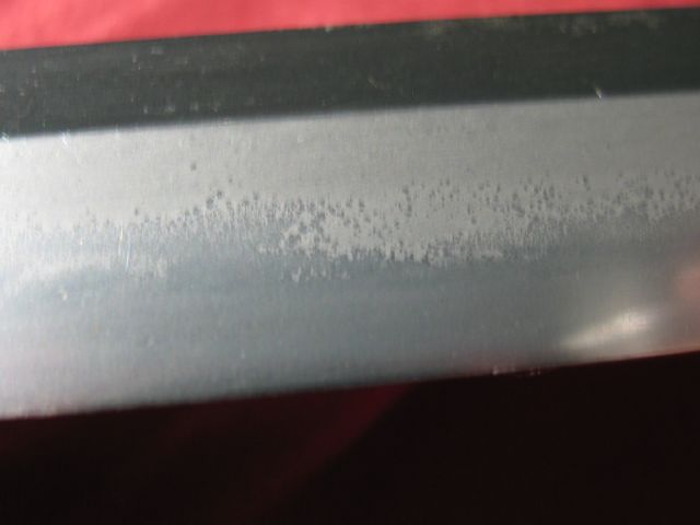

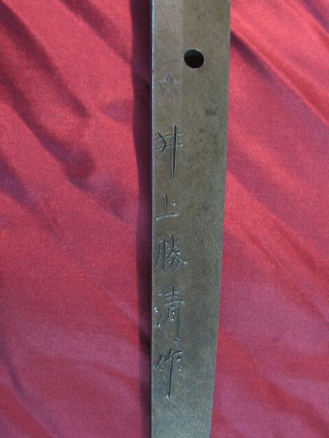

Blade photos attached:Inoue Katsukiyo/Sadakane
I've a star stamped gunto signed "I (no) ue Katsukiyo saku", dated "autumn 1944".
I know (through communicating with Geo. Trotter-who dredged up the details) that Katsukiyo was the name used by the "future" Sadakane while studying with Sadakazu/Sadakatsu.
Question: When did Sadakane begin using the "Sadakane" mei, and was there a son/student using the "Katsukiyo" mei?
My thanks.

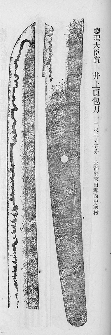

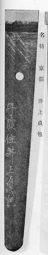

Attached tang photo is:
It is an Oshigata of the sword that he won the Prime Minister prize in the Japanese sword exhibition in 1936.
He already used "Inoue Sadakane"mei(貞包).
I believe, KatsuKiyo was 1gen-Sadakane, Katsuhiro was 2gen-Sadakane.
hi Todd,
I think Morita san's explanation must be correct...Katsukiyo is the personal name of Inoue Sadakane and seems to have been his toshomei before he was given "Sadakane" by the Gassan Sadakatsu/Sadakazu school (from Uchiyama sensei articles in NBTHK), and he must have used Katsukiyo in gunto, as your sword is dated 1944 and a Sadakane blade is dated from 1936 (Morita san's oshigata pic). I suppose another similar example of a tosho using a different name (I just remembered) in certain circumstamces would be Miyaguchi Ikkansai Toshihiro (who became Yasukuni tosho Yasuhiro in 1933) who used Ikkansai Kunimori when working swords at Okura Tanrenjo from 1937. The location of the forge and purpose of the work sometimes affects the use of mei.

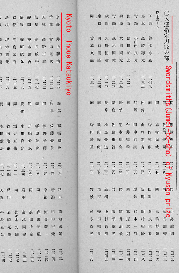

Morita san's 1944 Jumei Tosho prizewinner list is very interesting...it looks familiar, what book is it from?...I notice my own star stamped sword dated 1944 is by a swordsmith in this list...Nagao Kunishiro of Aomori.
Regards to all,
George.
Regards to all,
George.
Hi George san,
Oh yes, It contaeins Nagao Kunishiro, and also Ichihar Nagamitsu,Akimoto Akitomo,Tanaka yoshimitsu,---etc,.
The Gunto-exhibition was opening in December 1944.
As you know, The name-list of this Gunto-exhibition appeard on [Nihonto oyobi Nihonshumi] 1945,#1.
Unfortunately, Oshigatas were not appeard in this issue.
