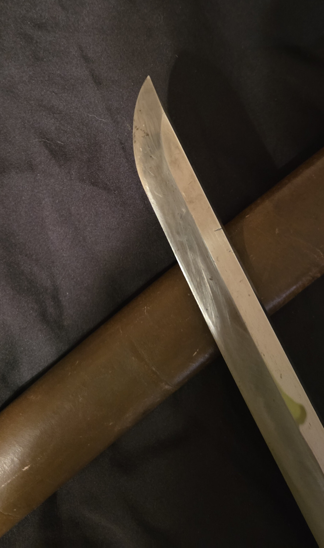

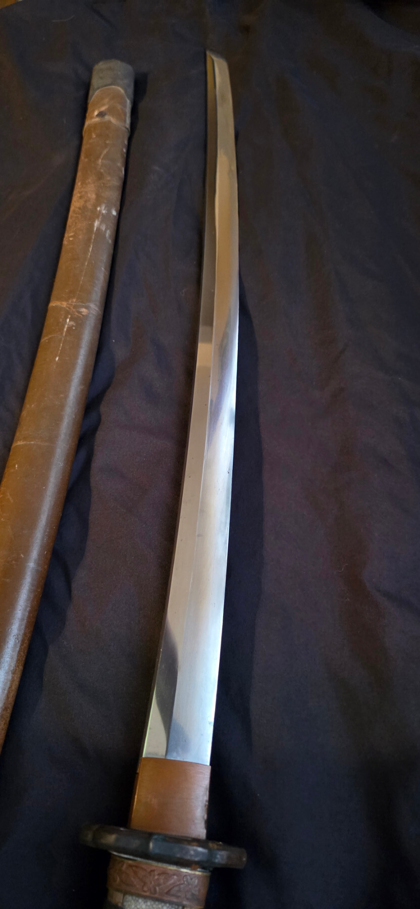

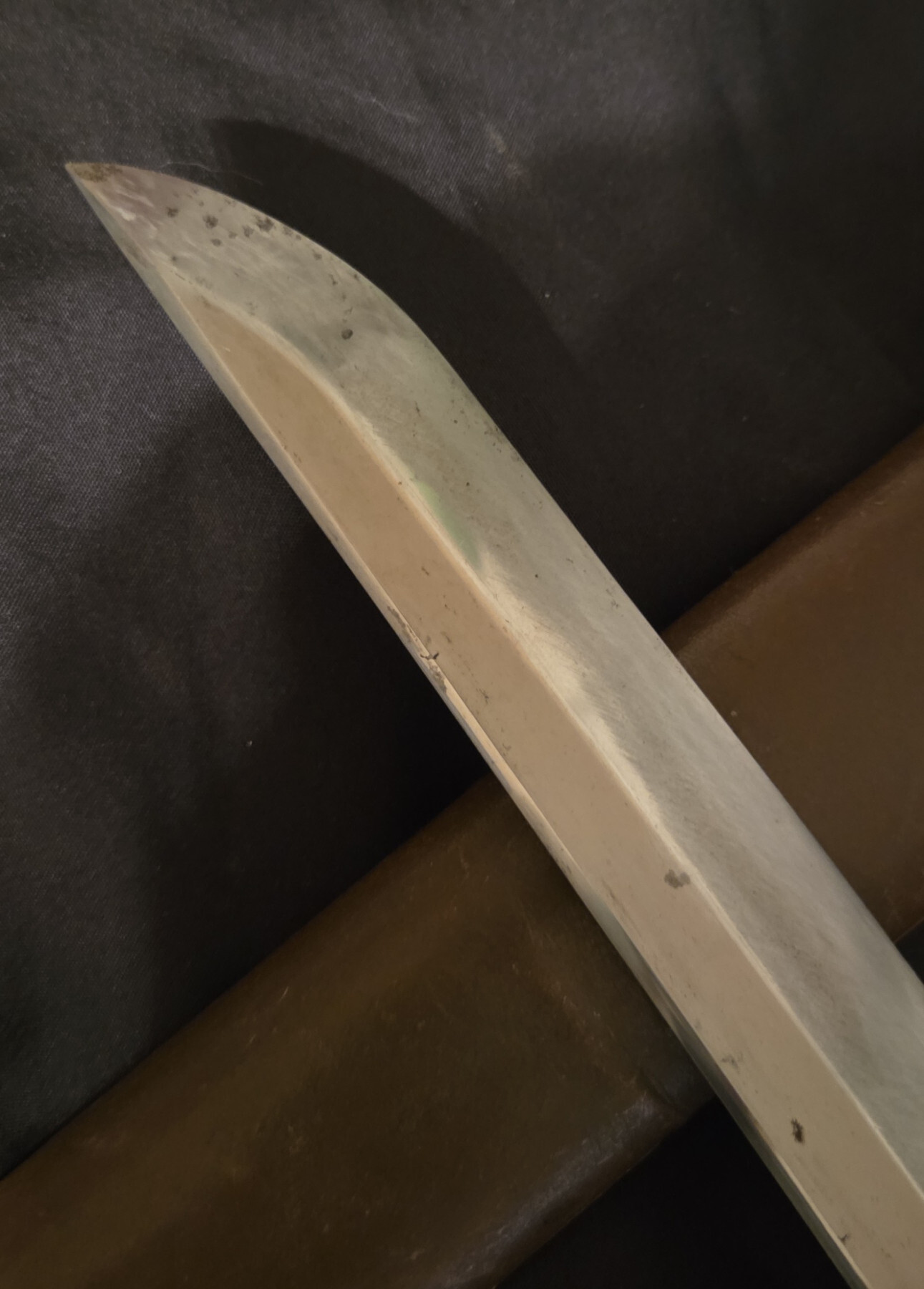

Love to hear what you guys think of this sword?
This is my first hand made sword. Practically I know nothing about swords other that I love them.
What I know is info got from the seller.
Shin Gunto Type 98
Japanese army officers Samurai sword from World War 2.
The blade is signed Amachi Kanenaga
Traditionally made Gendaito
The mountings are high end Type 98 Shin Gunto
One half of the koiguchi at the throat of the scabbard is missing.
Blade length of 26 inches (66cm).
Soshu-style notare hamon that is present the length of the blade, photos dont show well.
Your opinion will be very appreciated.

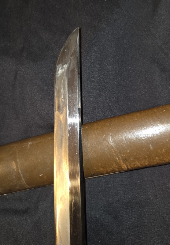

Kris:
Probably just the wrinkle in the fabric, however the kissaki looks odd. How does it look in hand?

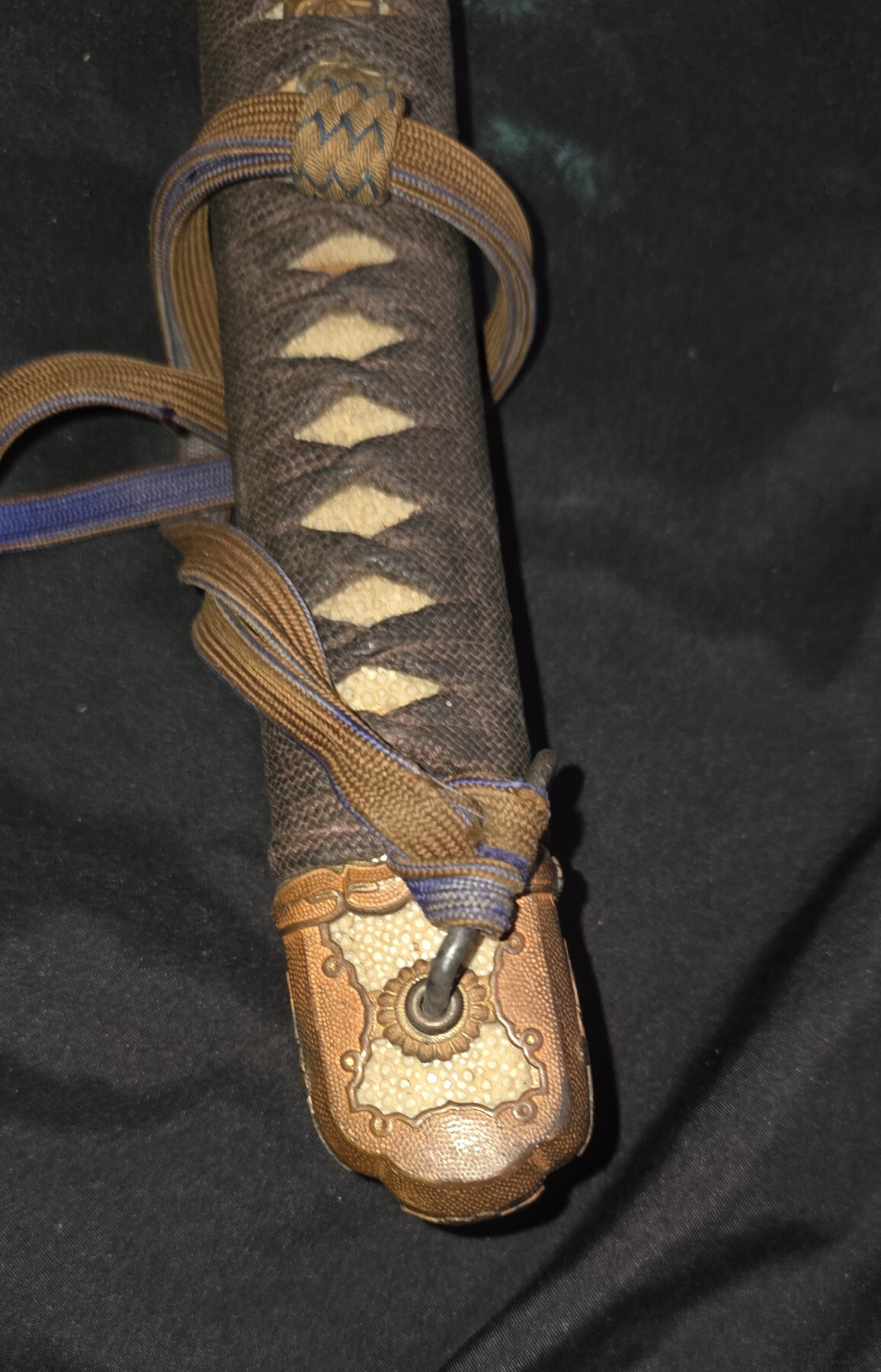

Also, and you probably already know this, the tassel is a company grade tassel meaning Lieutenent or Captain (or could be warrant officer as well).
John C.
Kris,  pic better this way.  More on swordsmith (also see Naval Swords part 1 in NMB Downloads at top of page for examples)
Looks to be well made and saya looks interesting custom work?
Kanenaga, Amaike Ginjiro (包永天池 銀次郎) (older brother of Masatsune)
born 4 September, 1884 (Showa 17), registered as Seki smith at Seki 15 June, 1941 (Showa 16) and living at Daimon-cho, Seki-machi. He may not have made (many) Navy swords.
Kanenaga died March 8th 1958 (Showa 33, his posthumous Buddhist name was Enkaku Chikyō (円覚智鏡).
Common mei: Nōshū Seki no jū Kanenaga kore saku (濃州関之住包永作之), Kanenaga (包永)
  • Like 5
You did well, Kris.  We often see spots and stains, especially at the tip, both officer and NCO blades.  I think moisture gets in and sits in the end of the saya causing the stains.  My RJT blade has even more stains than that.
