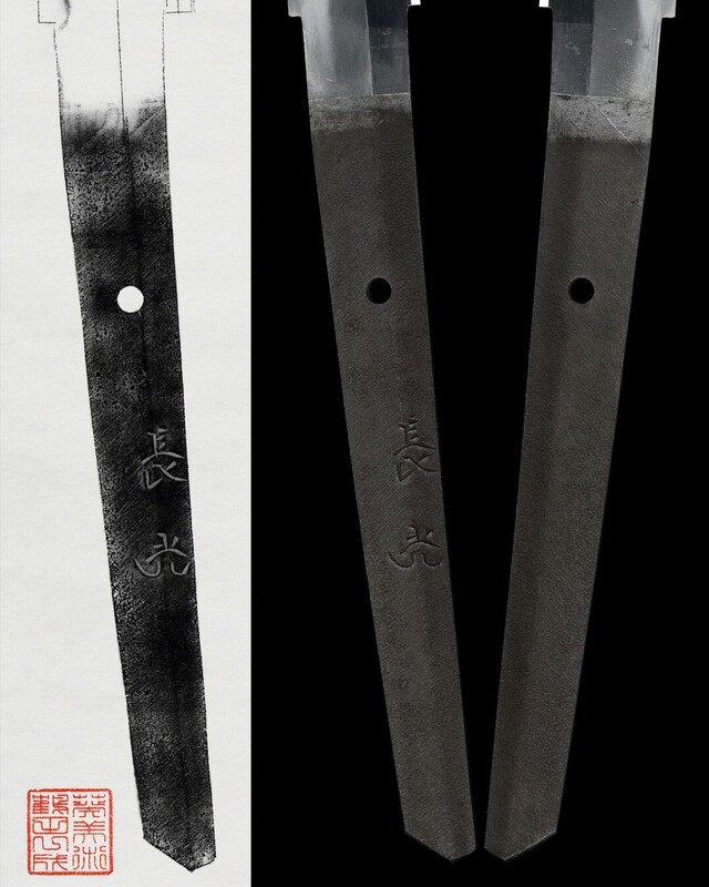

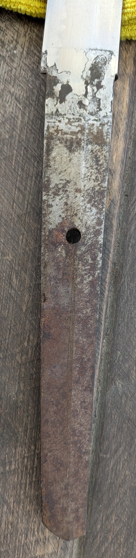

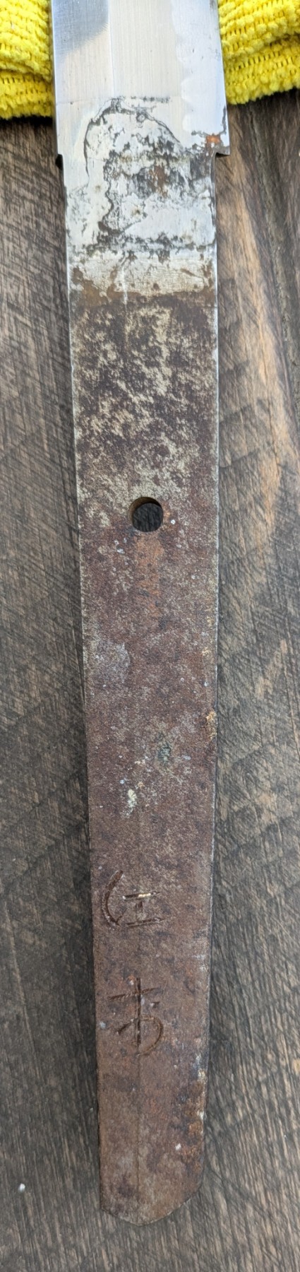

Rawa Posted October 11 Author Report Posted October 11 (edited) Niji mei [tachi] nakago jiri different then samuraimonkey video example. Edited October 11 by Rawa Quote
Rawa Posted October 11 Author Report Posted October 11 (edited) 26 minutes ago, Pav said: Very similar mei, also tachi Thank you. If you have nakago jiri picture please share. What's nice here is some lines looks like writing brush. I had theory that only 2 kanji mei or with dedications [slough/example F] are made as tachi but no longer viable. Edited October 11 by Rawa 1 Quote
Rawa Posted October 11 Author Report Posted October 11 (edited) On 10/2/2025 at 10:14 PM, Kiipu said: Do not recall seeing this before either. Possibly a Japanese katakana NA with an Arabic 8? ナ8 = Katakana NA 8. Mei have 8 kanji and is consistant with 6 kanji mei carved at nbthk papered example. So maybe we could find there 6 accordingly. Those blades with longer mei could be signed by different person. Edited October 11 by Rawa Quote

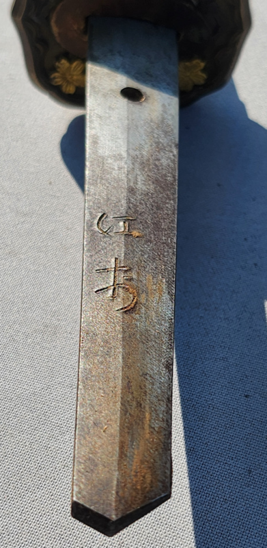

Pav Posted October 11 Report Posted October 11 Different photo of the same nakago All the best Pav 1 1 Quote
George KN Posted October 11 Report Posted October 11 1 hour ago, Rawa said: I had theory that only 2 kanji mei or with dedications [slough/example F] are made as tachi but no longer viable It's an interesting theory, mine is also tachi; 1 Quote

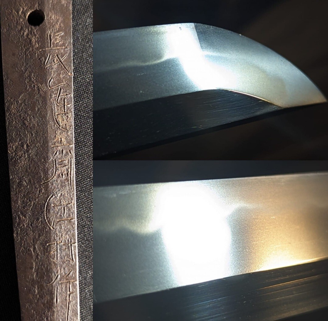

Rawa Posted October 11 Author Report Posted October 11 (edited) 39 minutes ago, George KN said: It's an interesting theory, mine is also tachi; Third example with same nakago jiri. Mine 4th niji mei is different here which is disturbing [yasurime mached at least] and here comes Nagamitsu... "During wartime, Shigetaro Emura, the warden of Okayama Prison, aimed to rehabilitate well-behaved prisoners by having them craft swords. He invited Ichiryushi Nagamitsu, a swordsmith from Okayama, to supervise and teach the inmates. Nagamitsu, known for being a Rikugun Jumei Tosho (army-appointed swordsmith), guided the prisoners, leading to variability in the craftsmanship and sometimes rough finishes. However, well-polished examples reveal high-quality jigane. Nagamitsu's signature can vary, including "Nagamitsu," "Ichiryushi Saku," "Ichiryushi Nagamitsu," and "Bizen Kuni Oju Ichiryushi Nagamitsu Saku." Edited October 11 by Rawa 1 Quote
George KN Posted October 11 Report Posted October 11 If we're making an everything-Emura thread, here is what Sesko's Swordsmiths A-Z has on him (hopefully nobody will mind me copy pasting - I highly recommend buying the pdf, it's great for this!): Quote EMURA (江村), Shōwa (昭和, 1926-1989), Okayama – “Chōunsai Emura saku” (長運斎江村作), “Emura saku” (江村作), “Bishū Chōunsai Emura saku” (備州長運斎江村作), “Doshū Chōunsai Emura saku” (土州長運斎江村作). Emura came originally from Kōchi (高知) what was the former Tosa province and was from aroud 1940 onwards the head of a prison in Okayama (岡山). He returned to Kōchi in 1943. His gō was Chōunsai (長運斎). In the prison, he operated a forge and a kind of swordmaking school that trained several students. These students in turn worked from time to time as daisaku-daimei for him. It is said that he was a self-taught swordsmith and we know reports that mention that his blades were polished by prisoners. He signed the left radical (氵) of the character for E (江) as curve like ( and the character for mura often like the hiragana syllable o (お). Emura died in 1960. One thing I have noticed with Emura though, not just in this thread, but in my own research too, is just how beat up most of the examples are. Pics of mine when when I first got it can be found here, but most of the ones in this thread are scratched badly too. I also find it interesting that a lot of examples have silvered habaki. Unsure I'm able to extrapolate anything from this yet, but it's fun comparing and contrasting with other surviving blades. 1 Quote
Rawa Posted October 11 Author Report Posted October 11 26 minutes ago, George KN said: If we're making an everything-Emura thread, here is what Sesko's Swordsmiths A-Z has on him (hopefully nobody will mind me copy pasting - I highly recommend buying the pdf, it's great for this!): One thing I have noticed with Emura though, not just in this thread, but in my own research too, is just how beat up most of the examples are. Pics of mine when when I first got it can be found here, but most of the ones in this thread are scratched badly too. I also find it interesting that a lot of examples have silvered habaki. Unsure I'm able to extrapolate anything from this yet, but it's fun comparing and contrasting with other surviving blades. Thank you! Share any info you came across. Akihide from self taught smith over couple of years turn out to have many teachers way before establishing Nipponto Tanren Denshu Jo. With Emura having so many different types of mei in multiple examples we have a lot to unravel. 1 Quote

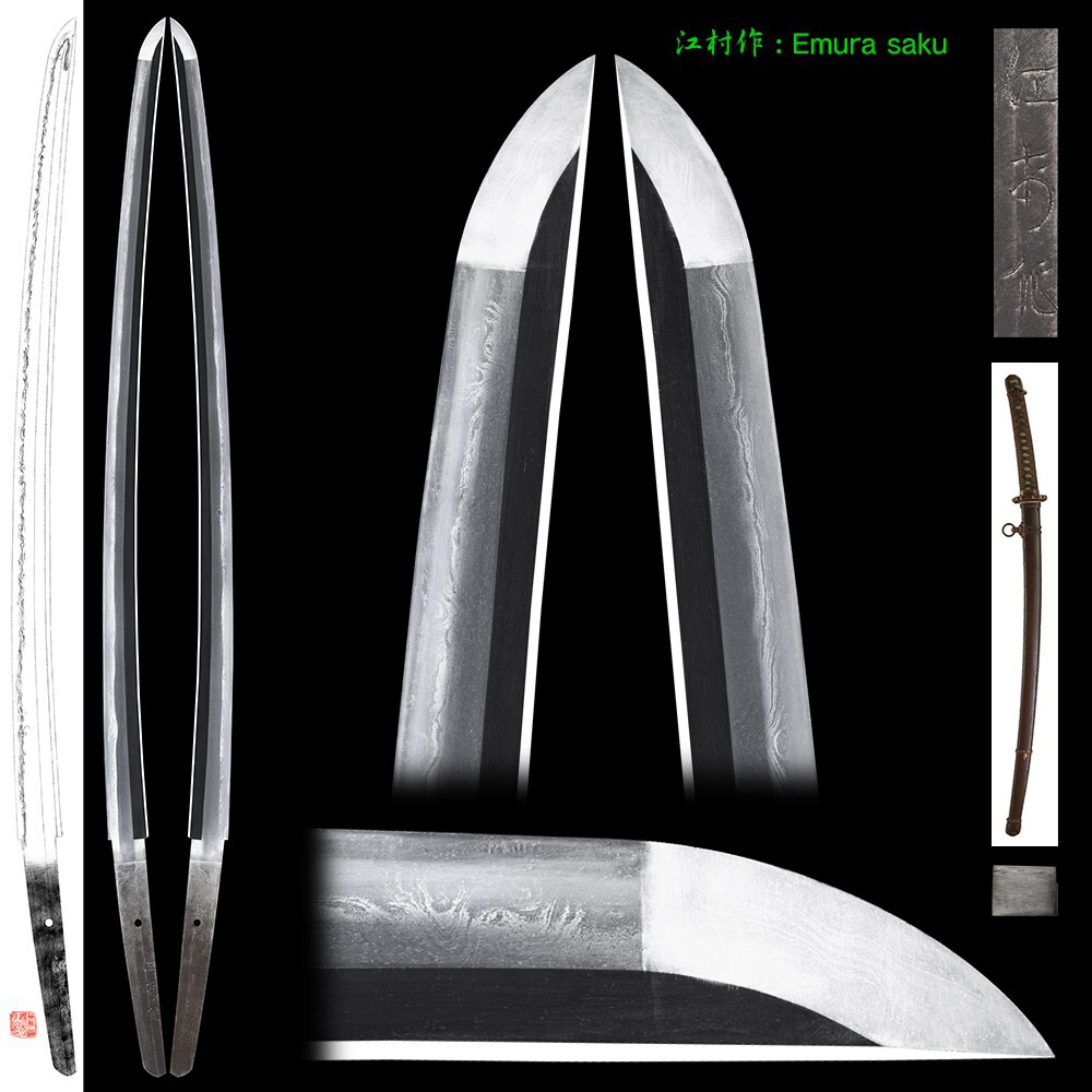

Pav Posted October 12 Report Posted October 12 here is youtube video about nice example of Emura sword released by one of UK antique dealers. Sword is sold now but maybe someone finds that video interesting 1 Quote
Rawa Posted October 14 Author Report Posted October 14 (edited) On 10/12/2025 at 8:50 PM, Pav said: here is youtube video about nice example of Emura sword released by one of UK antique dealers. Sword is sold now but maybe someone finds that video interesting I already posted it Sept 04. But thanks easy to miss. Here we go with Mr Ray's example [I hope he don't mind] https://swordsofjapan.com/product/emura-katana-in-shirasaya/ Edited October 14 by Rawa Quote
