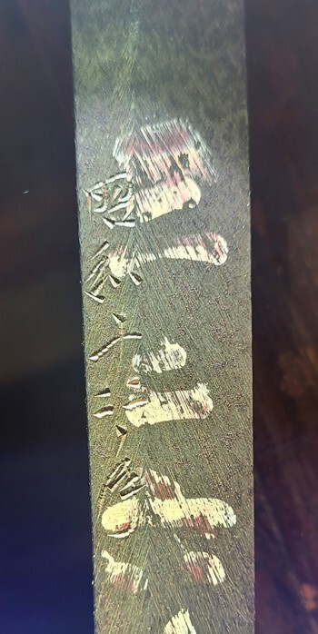

Grey Doffin Posted June 8, 2025 Report Posted June 8, 2025 The number 326 painted over a Showa period date and Seki no Ju Kanenori Saku. Grey 3 Quote

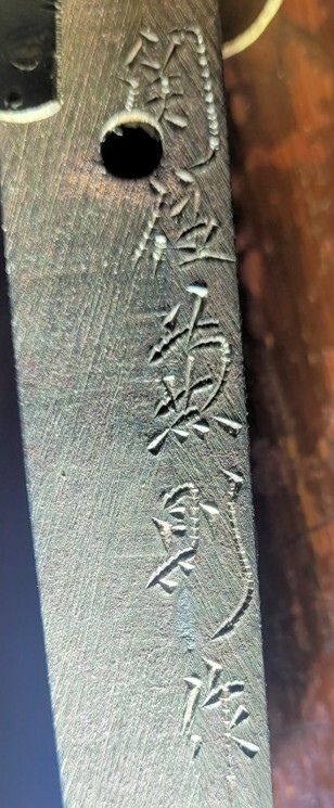

Bugyotsuji Posted June 9, 2025 Report Posted June 9, 2025 Which other markings? Grey and Uwe covered everything we see above. The date and the name are chiseled into either side of the tang. Seki no Ju Kanenori Saku means: “Kanenori who lives in Seki made this”… Now you can start the track and chase! 1 1 Quote
Bruce Pennington Posted June 9, 2025 Report Posted June 9, 2025 The paint are numbers - 326?, and were put there during the production process to keep all the fitted parts together. 1 1 Quote
Kiipu Posted June 24, 2025 Report Posted June 24, 2025 In regards to the date, not sure what is going on with what I would guess is a ten 十. The four 二二 that follows is a variant rarely encountered. Oddities/rarities in datings Arsenal Stamps. Would appreciate your expertise please 2 Quote
