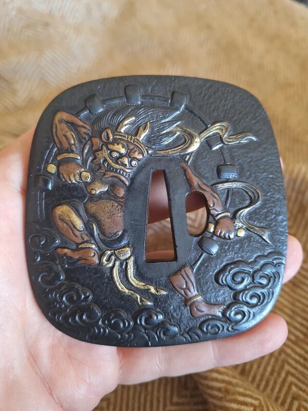

Nihonto student Posted May 9 Report Posted May 9 Dear all, I kindly ask for your help since my interest is mainly in blades and I don't know much about tsuba, something I absolutely need to fix... This piece caught my attention especially for the unusual size that leads me to think that it was made for artistic purposes only, I would like to know your opinions on it including the translation of the mei and an idea of value provided that it is authentic... as I said I am out of my comfort zone. Thank you in advance for your comments. Giordy Quote
suketaka Posted May 9 Report Posted May 9 Hello Giordy, for me a modern fake. Lets see what the others say about... Michael 3 Quote
Nihonto student Posted May 9 Author Report Posted May 9 5 minutes ago, suketaka said: Hello Giordy, for me a modern fake. Lets see what the others say about... Michael Thanks Michael, I need to start checking the Tosogu section more often and train my eyes... Quote
Nihonto student Posted May 9 Author Report Posted May 9 1 minute ago, Kantaro said: Indeed cast Fake. Thank you Kantaro, can I ask you if there are any unique distinctive elements to immediately understand if it is a replica? Or is it just a matter of experience? Quote

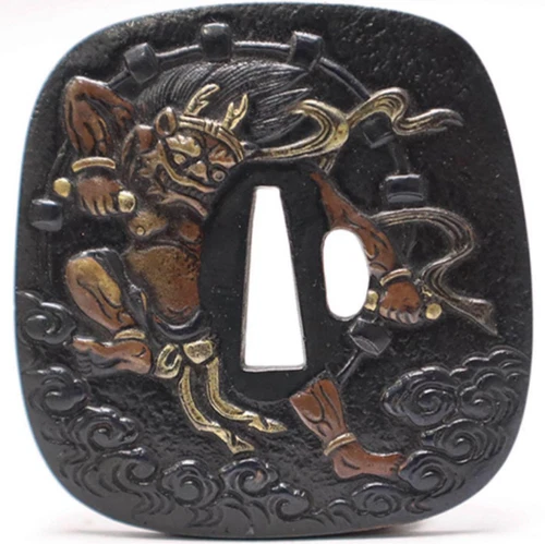

Spartancrest Posted May 9 Report Posted May 9 Mass produced "reproduction" ie. cast fake. The biggest give away is the nakago-ana [tang hole] but in reality for most of us with years of seeing these, it is just how commonly they turn up. They can come either with applied colour or just a darkened metal and there are others in the "set" - same sort of nakago-ana. You can buy the "set" https://www.supeinnihonto.com/product/aorigata-daisho-set-tsuba/ but please don't! Not at this price 950 € Over a thousand dollars US. It Comes with certificate of SupeinNihonto. ! Well the certificate is not worth the ink it was printed with and the description of "gold inlays" is also a joke - if any gold was used it is overlay!!! There is even a more modern copy of a copy - the nakago-ana is better but still it is a copy of the same design. https://teraasekeskus.com/tuote/ryumon-raijin-tsuba/?lang=en https://teraasekeskus.com/tuote/ryumon-raijin-tsuba/?lang=en https://www.ebay.com/itm/315774157914 https://www.ebay.com/itm/356441228047 These are paperweights at best 1 1 Quote
Nihonto student Posted May 9 Author Report Posted May 9 7 minutes ago, Spartancrest said: Mass produced "reproduction" ie. cast fake. The biggest give away is the nakago-ana [tang hole] but in reality for most of us with years of seeing these, it is just how commonly they turn up. They can come either with applied colour or just a darkened metal and there are others in the "set" - same sort of nakago-ana. You can buy the "set" https://www.supeinnihonto.com/product/aorigata-daisho-set-tsuba/ but please don't! Not at this price 950 € Over a thousand dollars US. It Comes with certificate of SupeinNihonto. ! Well the certificate is not worth the ink it was printed with and the description of "gold inlays" is also a joke - if any gold was used it is overlay!!! There is even a more modern copy of a copy - the nakago-ana is better but still it is a copy of the same design. https://teraasekeskus.com/tuote/ryumon-raijin-tsuba/?lang=en Many thanks for your explanation Dale, no intention of shopping at the moment (Much less buying reproductions) just wanting to broaden my knowledge in the field. All the best, Giordy Quote

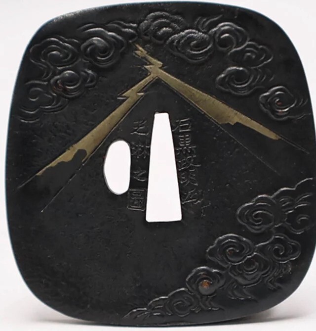

Spartancrest Posted May 9 Report Posted May 9 Giordy a set here made into candle holders. https://www.worthpoint.com/worthopedia/1800s-export-tsuba-ishiguro-masaaki-415584528 https://www.worthpoint.com/worthopedia/exceptional-Japanese-bronze-tsuba-3885860381 The cast in signature is Masaaki Ishiguro but that means nothing in this case. Have fun. Kind regards 1 Quote

FlorianB Posted May 10 Report Posted May 10 17 hours ago, Spartancrest said: You can buy the "set" https://www.supeinnihonto.com/product/aorigata-daisho-set-tsuba/ Miraculously it has been sold in the last hours - what a pity! 1 1 1 Quote
Spartancrest Posted May 11 Report Posted May 11 This one has even been mounted by the look of the nakago-ana and the opening price is "more realistic" even for a paperweight. https://www.ebay.com.au/itm/306292562072 it is pretty crude. 1 Quote
Jake6500 Posted May 11 Report Posted May 11 Hi Giordy, There are a couple giveaways about this tsuba. Firstly as others have pointed out this is a commonly replicated design. Secondly, the nakago ana in the middle has been cut with an unusually square-ish shape. Finally, the space where the seppa would normally go seems unevenly shaped and does not appear to form a proper oval. These are the key points that stick out to me just at a glance. 1 Quote
Nihonto student Posted May 12 Author Report Posted May 12 On 5/10/2025 at 9:13 AM, FlorianB said: Miraculously it has been sold in the last hours - what a pity! Not by me , Thanks everyone for your suggestion! 2 Quote
