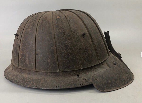

Matsunoki Posted May 5 Author Report Posted May 5 @uwe Many thanks Uwe…..I was hoping it was older but as I know virtually nothing yet I’m not surprised to be hundreds of years out! Purely for interest here is the Bachi…..anything special about it? Appreciate your time and help! 1 Quote
uwe Posted May 5 Report Posted May 5 Good hachi, solid workmanship from what I can see 👍 Do you have a top view? Quote

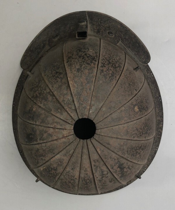

Matsunoki Posted May 5 Author Report Posted May 5 Just now, uwe said: Do you have a top view? Thanks again Uwe. Top view…. 2 Quote
Matsunoki Posted May 5 Author Report Posted May 5 18 minutes ago, uwe said: Maybe of Myōchin origin…? Thanks again Uwe Why would this be dated but not signed? Whilst my knowledge is minimal, this looks a well made hachi worthy of a Mei? Quote
uwe Posted May 6 Report Posted May 6 I can’t tell, Colin. The manufacturing date is quite late. Maybe it never had a customer, so no need to sign the work. The patina is very evenly no wear, no signs of a once mounted shikoro or tehen no kanamono…however, I don’t know. BTW, it’s not that uncommon that helmets, although of good quality, weren’t signed by the maker. Mumei, so to say, for what reason ever. Occasionally you also find merely dates or/ and invocations are inscribed… 2 1 Quote

Bugyotsuji Posted May 6 Report Posted May 6 As a suji kabuto, everything is there. It has four shiten-no-byo and four hibiki-ana.You have some of the rivet heads showing. No hachimanza, but some people prefer it in the raw state, and quite well finished even without the tehen kanamono. The haraidate-dai has two holes in vertical alignment and iri-hasso in the top edge. The shikoro would have been.. manju shikoro? The mabisashi is fairly steep and has a good shape. 3 Quote

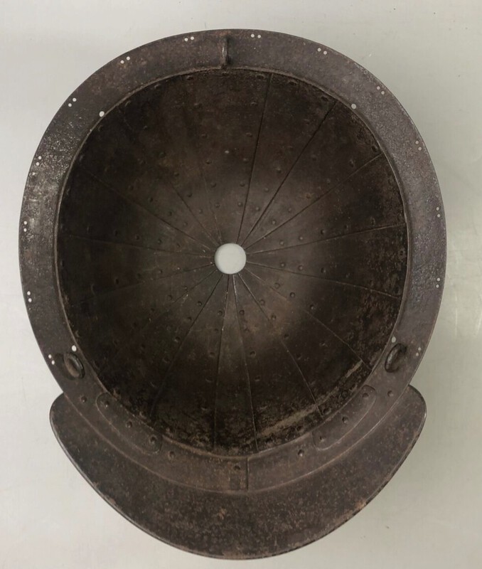

Shogun8 Posted May 6 Report Posted May 6 My first impression of this hachi is that it has some age (the excellent condition not withstanding). The shape, koshimaki meant to fit a manju shikoro, the robust haraidate with fairly deep irihasso and the mabezashi connected by iron sanko no byo would not point to a late Edo dating for me. Do you have pictures of the interior of the hachi? 4 Quote
Matsunoki Posted May 6 Author Report Posted May 6 2 hours ago, Shogun8 said: Do you have pictures of the interior of the hachi? Herewith…….all further views most welcome. Thanks for looking 1 Quote
uwe Posted May 7 Report Posted May 7 As mentioned above, a well made kabuto! The view inside and the overall appearance might support the date and I stick with my assumption that it was probably never been “completed”. Open for other opinions and comments… 1 Quote
Iekatsu Posted May 9 Report Posted May 9 An Edo period Hachi for sure, I think you can rule out Koji. 1 Quote
Bugyotsuji Posted May 9 Report Posted May 9 9 hours ago, Iekatsu said: An Edo period Hachi for sure, I think you can rule out Koji. What fixes it to Edo for you, Thomas? Quote
Iekatsu Posted May 10 Report Posted May 10 For me it is how clean the plates, construction and the finishing of the rivets are, both inside and out. I agree with Uwe on the translation and also agree that it has likely never been mounted or perhaps only mounted once. It is possible that the date is Gimei, but I would still place it on the later side of the Edo period, even without the date. It is a really nice looking Hachi by the way, good shape and form, and being dated is rarer than being signed. 1 1 Quote
