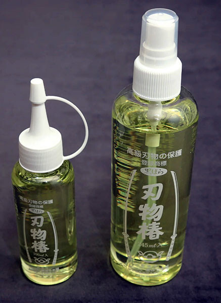

Brian Posted September 17, 2024 Report Posted September 17, 2024 I use the spray sword oil that is very common, take a clean, soft white tissue and fold it a few times. Then spray once or twice onto the tissue, and wipe gently from the habaki side to the tip. As mentioned, if you can see a layer of oil, it's too much. And apply oil onto the wiping surface, not directly to the blade. Less is more. 1 2 Quote

george trotter Posted September 18, 2024 Report Posted September 18, 2024 22 hours ago, Brian said: I use the spray sword oil that is very common, take a clean, soft white tissue and fold it a few times. Then spray once or twice onto the tissue, and wipe gently from the habaki side to the tip. As mentioned, if you can see a layer of oil, it's too much. And apply oil onto the wiping surface, not directly to the blade. Less is more. Brian, I haven't heard of a spray sword oil...what is the brand / description? Regards... Quote
Brian Posted September 18, 2024 Report Posted September 18, 2024 I know a lot of collectors use this. Works well for me. Under the Kurobara name maybe? 3 2 Quote
chinaski Posted September 18, 2024 Report Posted September 18, 2024 2 hours ago, george trotter said: Brian, I haven't heard of a spray sword oil...what is the brand / description? Regards... You can buy Camelia Oil in a Spray Bottle. https://www.amazon.c...ca314019cb3e807&th=1 Quote
Scogg Posted September 18, 2024 Report Posted September 18, 2024 https://www.amazon.com/KUROBARA-Tsubaki-Japanese-Maintenance-Camellia Here's a link to the spray tsubaki oil that Brian mentioned. I encourage anyone to find a source other than Amazon, but it was the easiest to find Another oil tip, that helped me early on, was checking on my sword 24 hours later. If oil has collected, or is beading anywhere; you can soak it up or spread it out. Also, you will know to use much less the next time. I quickly got a feel for how much was needed. Cheers, -Sam 3 Quote
chinaski Posted September 18, 2024 Report Posted September 18, 2024 37 minutes ago, GeorgeLuucas said: https://www.amazon.com/KUROBARA-Tsubaki-Japanese-Maintenance-Camellia Here's a link to the spray tsubaki oil that Brian mentioned. I encourage anyone to find a source other than Amazon, but it was the easiest to find Another oil tip, that helped me early on, was checking on my sword 24 hours later. If oil has collected, or is beading anywhere; you can soak it up or spread it out. Also, you will know to use much less the next time. I quickly got a feel for how much was needed. Cheers, -Sam Yeah, I found out one squirt is all that's needed. Kind of looks "streaky" if you do more than that. One squirt, wipe, then wipe off again with a Microfiber towel. That seems to be working for me so far. 2 Quote

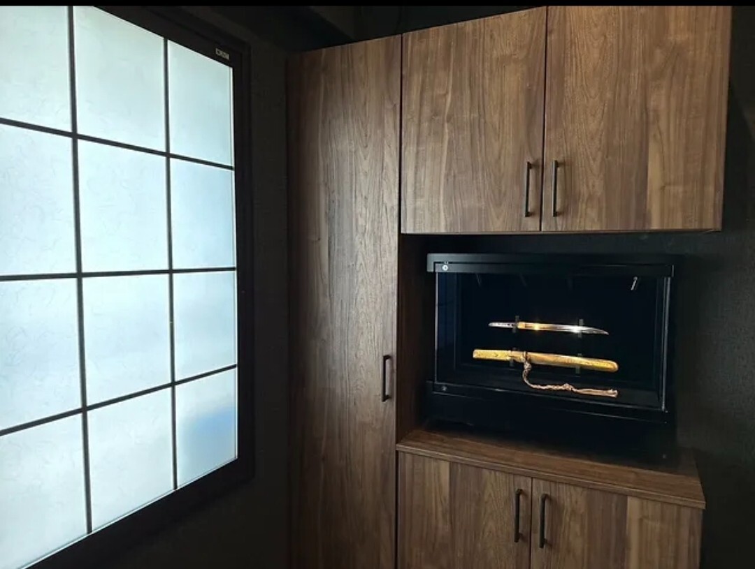

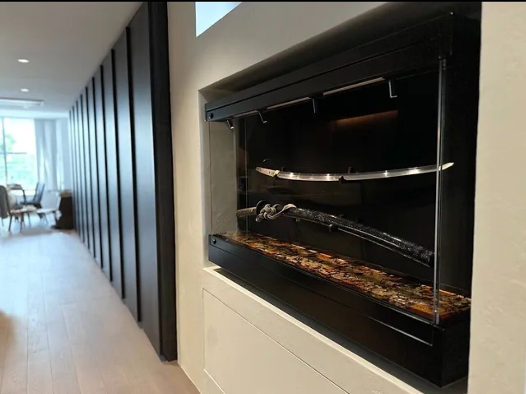

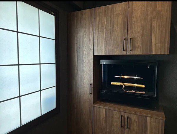

Emil Posted October 4, 2024 Report Posted October 4, 2024 Might be a bit expensive but you can use this as an inspiration https://en.katana-case-shi.com/ https://www.instagra...atana_case_shi_shop/ 6 Quote
Gakusee Posted October 4, 2024 Report Posted October 4, 2024 1 hour ago, Emil said: Might be a bit expensive but you can use this as an inspiration https://en.katana-case-shi.com/ https://www.instagra...atana_case_shi_shop/ Just an inspiration is probably not doing it a service, A lot of work goes into Nakamura san’s work. He keeps experimenting and innovating. Quote

Emil Posted October 5, 2024 Report Posted October 5, 2024 10 hours ago, Gakusee said: Just an inspiration is probably not doing it a service, A lot of work goes into Nakamura san’s work. He keeps experimenting and innovating. I love his work, really great products But I think it's a bit of a leap to recommend someone working on a IKEA DIY display to order a 2700 USD tabletop display from Japan 😅 Quote

Avidmark Posted October 7, 2024 Report Posted October 7, 2024 On 10/4/2024 at 11:33 AM, Emil said: Might be a bit expensive but you can use this as an inspiration https://en.katana-case-shi.com/ https://www.instagra...atana_case_shi_shop/ Those are incredible! Im actually somewhat considering getting the tabletop version. 1 Quote
MJS Posted October 14, 2024 Author Report Posted October 14, 2024 On 10/4/2024 at 6:33 PM, Emil said: Might be a bit expensive but you can use this as an inspiration https://en.katana-case-shi.com/ https://www.instagra...atana_case_shi_shop/ That looks great! I love the idea of including lighting with different color temperatures. The supports for the swords look very interesting, too. I really like the minimalistic style of back wall mounting, so that nothing in the display is distracting from the art. However, for more flexibility I decided to go with regular stands, but now I feel some doubt again. I have put in professional rail lighting from UFO (Ionic SX series, https://www.fiberopt...-lighting-system.php), they make fantastic bulbs. Super small, individually dimmable, several lenses and snoots, etc. I have a set of 3000K with a variety of lenses (mostly 16 and 20x50 degrees), but I might swap a few out for 4000K after reading about two different temperatures. The glass doors are 6mm extra clear double-sided anti-reflective, with anodized aluminium frames (https://www.vitris.e...and-furniture/Supra/). There is currently a brush in between the two doors to minimize dust coming in, but I don't like the looks of the vertical aluminium element in the middle. Might go for something more subtle, but I'm not sure about an alternative that would be a) pretty dust-proof or even air tight, and b) very subtle. It is a lot of fun to do this project: not knowing beforehand what it will end up like, but step by step ending up with something really nice anyway. Thanks for all these great bits of information and wonderful ideas. I'll post updates as I go. Mark 2 1 Quote

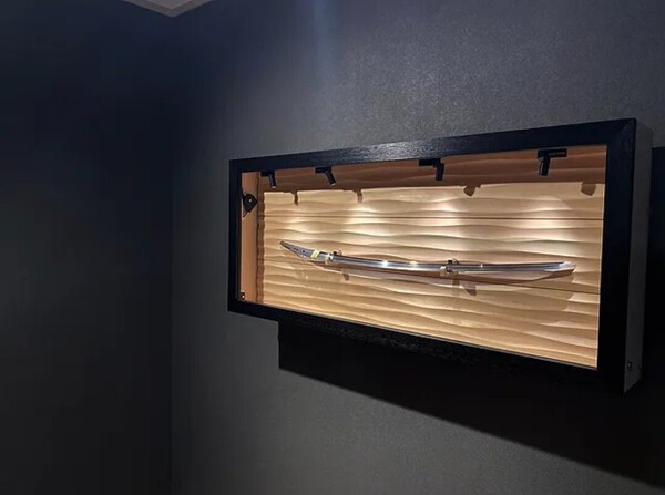

Schneeds Posted November 2, 2024 Report Posted November 2, 2024 I finally put the finishing touches on my display. It serves as both a display and a safe, which is close to air tight; the glass is clamped to the frame via magnets so it is removeable. The inside is lined with Aspen, and the fabric is vintage Japanese silk. I installed the light bar and a hygrometer. I also carved katanakake inserts for storing in shirasaya in the summer months when I'm away. 6 7 Quote

MJS Posted January 20 Author Report Posted January 20 On 11/2/2024 at 10:18 PM, Schneeds said: I finally put the finishing touches on my display. It serves as both a display and a safe, which is close to air tight; the glass is clamped to the frame via magnets so it is removeable. The inside is lined with Aspen, and the fabric is vintage Japanese silk. I installed the light bar and a hygrometer. I also carved katanakake inserts for storing in shirasaya in the summer months when I'm away. VERY nice! Excellent books, too :-) Cheers Mark 1 Quote

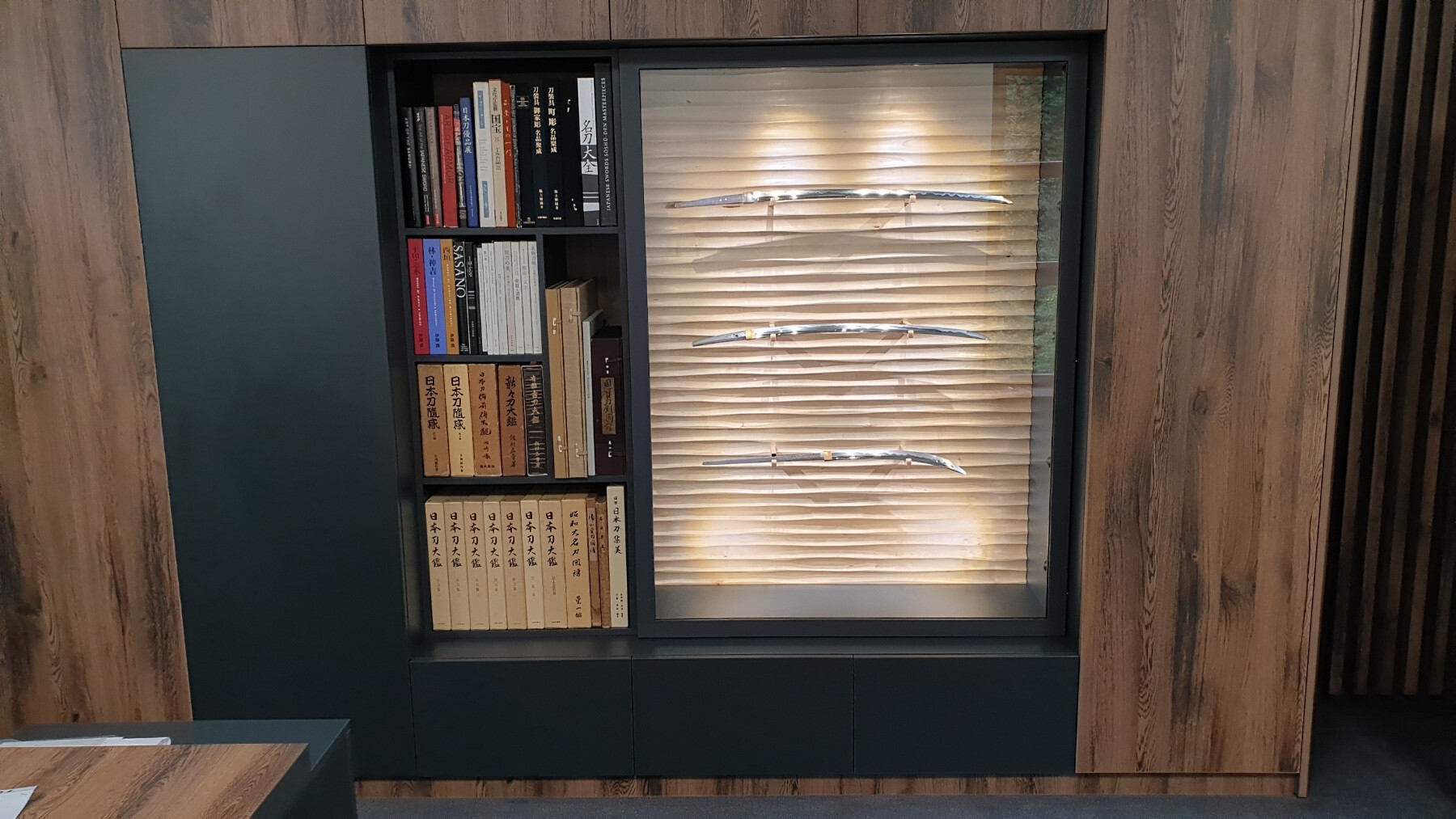

Brano Posted January 21 Report Posted January 21 I was inspired by Katana case shi and had a local manufacturer make me such a showcase Dustproof doors - I have my blades displayed in a showcase for a long time without oil and since we are a inland country, there is no problem with the blades at all 9 4 Quote
