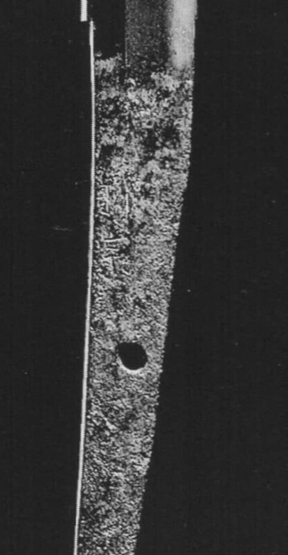

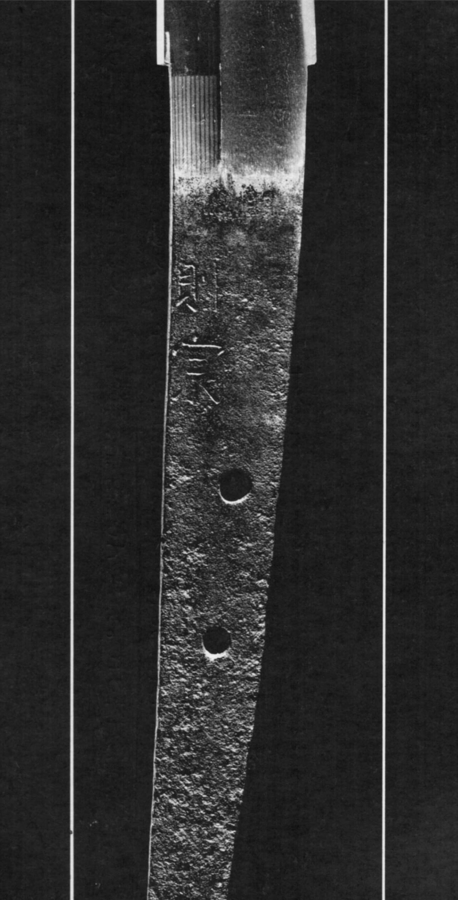

Gakusee Posted July 21, 2024 Report Posted July 21, 2024 3 hours ago, Rivkin said: Unfortunately Kamakura Norimune is also big enough claim it would have been checked many times... I think this is an understatement. Ichimonji Norimune is not just big but it is extremely big. He is the founder of the Ichimonji school ie Fukuoka so this would be as big as it gets in terms of “discovery”. So, yes, if it came from the West or even Japan - it would likely have been tried for papers…… Indeed here we cannot see if behind the suguha kesho polish one can find the kochoji that are expected. What however does not look promising is the mei. The space between the kodachi kanji is too wide and the sizing given the proportions of the nakago do not seem right. Attached are images of genuine Norimune. More compact, tighter together etc. The nakago would have probably been a bit slimmer too…. Quote
Zoglet Posted July 21, 2024 Author Report Posted July 21, 2024 19 minutes ago, Gakusee said: I think this is an understatement. Ichimonji Norimune is not just big but it is extremely big. He is the founder of the Ichimonji school ie Fukuoka so this would be as big as it gets in terms of “discovery”. So, yes, if it came from the West or even Japan - it would likely have been tried for papers…… Indeed here we cannot see if behind the suguha kesho polish one can find the kochoji that are expected. What however does not look promising is the mei. The space between the kodachi kanji is too wide and the sizing given the proportions of the nakago do not seem right. Attached are images of genuine Norimune. More compact, tighter together etc. The nakago would have probably been a bit slimmer too…. Let me try to get you close up photos of the Hamon. Additionally, I tried to make comparisons with as many Norimune mei as I could get, and I found one with a similar gap. Not trying to challenge your wisdom, just sharing the research I've also been trying to do. Please enlighten me. Quote

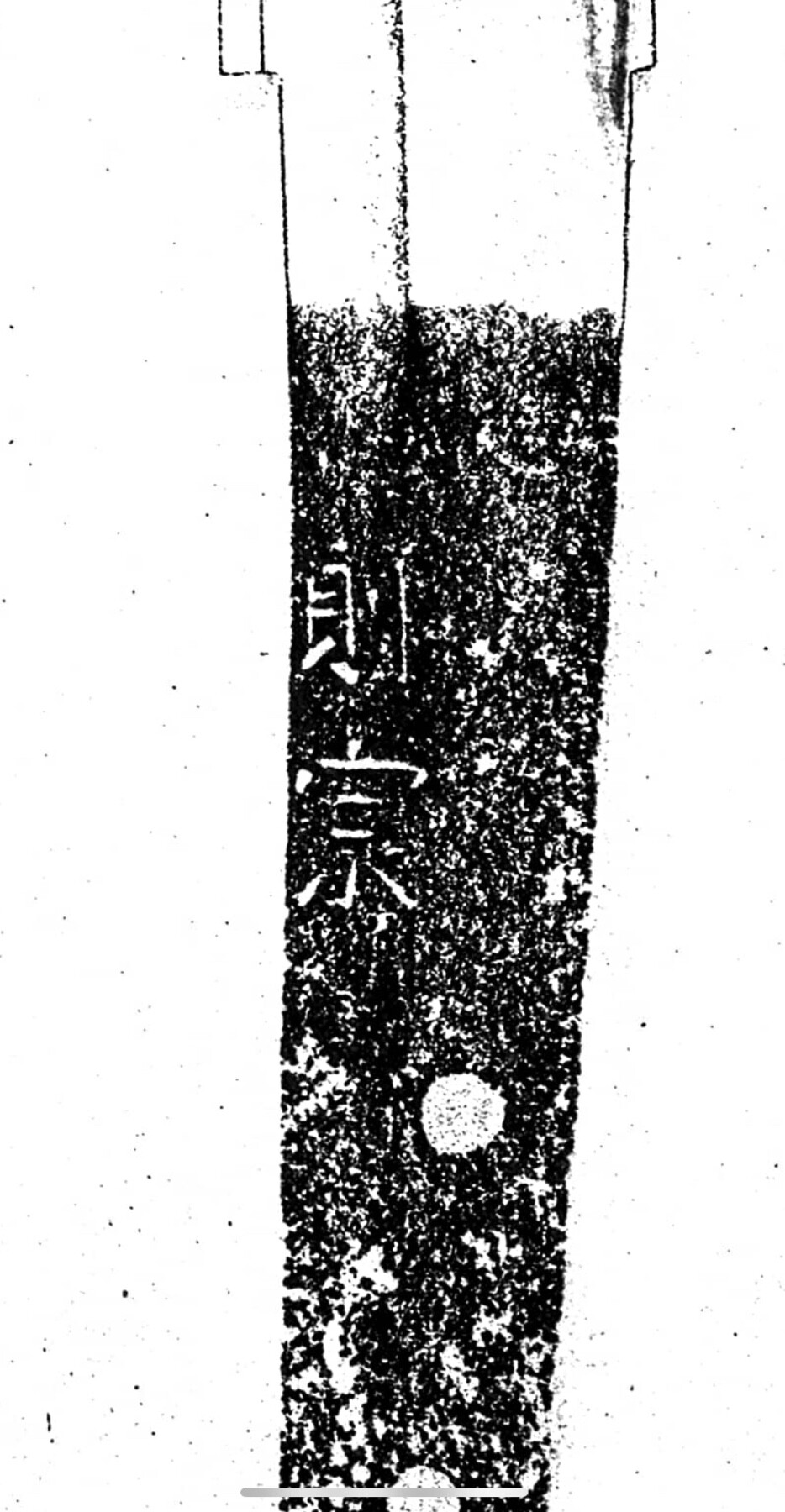

Rivkin Posted July 21, 2024 Report Posted July 21, 2024 Personally I would no be too concerned with any signature. These things are rare enough, if the signature is even 100% mismatch, it can still be unlisted later generation or unrelated lineage. It just needs to look like a true Kamakura item. But I think this is potentially something quite uncommon - purposefully made fake. Everything is a bit off - the nakago, patina's behavior around the edges, sugata. Forging looks koto but has late Muromachi roughness, a few other things. Everything sort of tries to be Kamakura, but does not reach there. Judging by the forging and how nakago is constructed it can be late Muromachi. I've been burned many times buying blades in Japan and ultimately my success rate in buying unpapered blades there was consistently high only in a few (well, two) locations. Both had no shinkansen and it took about 14 hours to get to Tokyo by train/airplane. And even in these cases a strong contributing factor was the local guru having unusual kantei habits. Every single unpapered blade in Tokyo itself will pass so many hands.... Sometimes one gets lucky if its signed and somebody who is greatly respected was the first to look at it and said its obvious fake, and it turned out its probably not, but its exceptionally rare. Usually if there is one person among ten who says "it can be real Kamakura", it will go to NBTHK. Quote
Zoglet Posted July 21, 2024 Author Report Posted July 21, 2024 13 minutes ago, Rivkin said: Personally I would no be too concerned with any signature. These things are rare enough, if the signature is even 100% mismatch, it can still be unlisted later generation or unrelated lineage. But I think this is potentially a not too common an item - purposefully made fake. Everything is a bit off - the nakago, patina's behavior around the edges, sugata. Forging looks koto but has late Muromachi roughness, a few other things. Everything sort of tries to be Kamakura, but does not reach there. Judging by the forging and how nakago is constructed it can be late Muromachi. I've been burned many times buying blades in Japan and ultimately my success rate in buying unpapered blades there was consistently high only in a few (well, two) locations. Both had no shinkansen and it took about 14 hours to get to Tokyo by train/airplane. And even in these cases a strong contributing factor was the local guru having unusual kantei habits. Every single unpapered blade in Tokyo itself will pass so many hands.... Sometimes one gets lucky if its signed and somebody who is greatly respected was the first to look at it and said its obvious fake, and it turned out its probably not, but its exceptionally rare. Usually if there is one person among ten who says "it can be real Kamakura", it will go to NBTHK. So, what would that say then about the Nishu sayagaki? Quote
Rivkin Posted July 21, 2024 Report Posted July 21, 2024 3 minutes ago, Zoglet said: So, what would that say then about the Nishu sayagaki? He was BAD at kantei. Good side - nobody fakes his sayagaki. 3 Quote
