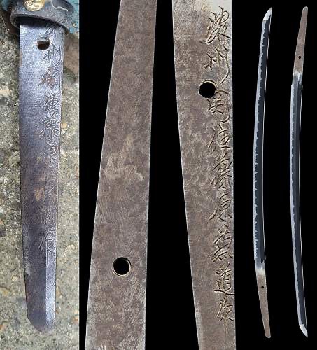

AQBTX Posted February 21, 2024 Report Posted February 21, 2024 Hello lovely sword people! I have a Japanese sword that was given to me by my teacher. He did not give me the translation when he gave it to me, but told me it was several centuries old and made in Japan. I would really love to identify the maker, and anything else the inscription brings. I have some understanding it makes some comment about the sea. I'll add some pictures, more upon request. I've tried my best to clean up the Kanji in a png. 1 Quote
Bruce Pennington Posted February 21, 2024 Report Posted February 21, 2024 Hi Ali, Sorry to tell you, but this blade was made during WWII. The small Showa stamp at the top was used from 1935 - 1945, but mostly 1940-1941. The smith is a Seki area smith named Kanemichi. Someone else can give the full translation. 1 1 Quote
AQBTX Posted February 21, 2024 Author Report Posted February 21, 2024 Hmm. I was given to understand that it was a family blade that was purposed during WWII - something that officers did at the time. Obviously, I could be well wrong of course. Quote
uwe Posted February 21, 2024 Report Posted February 21, 2024 As Bruce pointed out, it is “濃州関住藤原兼道作” (Noshū Seki jū Fujiwara Kanemichi saku). 2 1 Quote
Volker62 Posted February 21, 2024 Report Posted February 21, 2024 "Noshu Seki Ju Fujiwara Kanemichi saku" earlier signature Kanetoki 1 Quote
Bruce Pennington Posted February 21, 2024 Report Posted February 21, 2024 16 minutes ago, AQBTX said: Hmm. I was given to understand that it was a family blade that was purposed during WWII - something that officers did at the time. Obviously, I could be well wrong of course. This was done with old blades, that's true. But this one was made during the war. Quote
AQBTX Posted February 21, 2024 Author Report Posted February 21, 2024 Firstly, thank you all so much for being so helpful on this. I'm just seeking clarity - please don't take this as argumentative. Far be it for me to come and ask experts then argue the answer 濃州関住藤原兼道作 Third Character: I'm not seeing that character. What I'm getting is : 渓 I have no idea if that makes any difference at all.. Quote
AQBTX Posted February 21, 2024 Author Report Posted February 21, 2024 Elsewhere I'm finding this: 濃州関住藤原兼道作 Made by Kanemich Fujiwara of Seki in Nohshyu. He was a smith born in July 1902, real name was 小島時次郎 Tokijiro Kojima. Which fully supports your translation and name. He did most of his work in WWII. Well, I guess that's closed! Thank you all for solving this one 1 Quote
