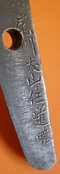

Anyone have any thoughts on this mei.

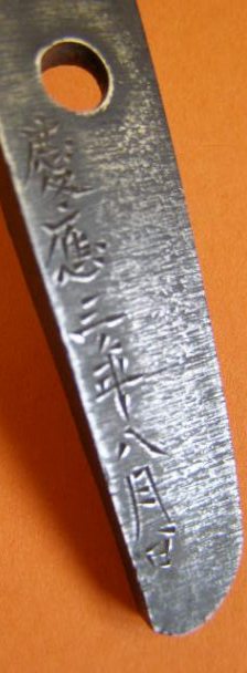

Appears to be signed Bishu Inuyama ju Michiyoshi and dated 1867. I can't find much information on Michiyoshi apart from that he is a student of Aizu Michitoki. Anyone have any oshigata of Michiyoshi to compare?

Actually, your tanto is signed, “Bishu Inuyama ju Michiaki [尾州犬山住道暁],” instead of “Michiyoshi [道賀]” (who was a student of Aizu Michitoki) you mentioned. According to my reference books, there were a few smiths who signed “Bishu Inuyama ju MichiXXX” in Owari province at the end of the Edo period. I believe they were all related smiths in the same family or school. However, I cannot find any specific information about Bishu Michiaki other than that he was active from the Bunsei through the Genji eras. Since the date inscription says “August, the 3rd year of Keio,” the blade is probably one of the very last blades made by Michiaki. (Though I could not find any oshigata of Michiaki's mei, chances are that the mei on this tanto is shoshin because you hardly ever find any gimei of a shin-shinto period "nami-saku" smith anyways.)

Hi,Hawley's entry with MIC 6 has the wrong name:Michiasa instead of Michiaki (Nihonto Meikan page 923)!Ludolf

Peter, the Nihontô Meikan only states that he signed "Bishû Inuyama jû Michiaki 尾州犬山住道暁" and "Bishû Inuyama jû Michiaki saku kore 尾州犬山住道暁作之", that he was from Owari 尾張 and worked ca. Tempô 天保 - that's all she wrote ... :|
