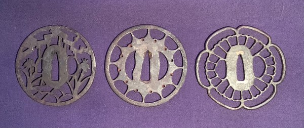

Hi guys,
I'm looking for a tsuba for a blade where school doesn't matter much neither papers..but the dimensions..must be between 7.5-8cm with 0.3-0.4cm(seppa dai) thickness..Also nakago ana length must be around 2.5-2.6cm width 0.6-0.8cm width..
I know I said school doesn't matter but Higo or Shoami would be nice..:) But I'm open to everything. Either reply here or pm me please :)
Thank you!
Hi Okan,
that requirements might fit only a few Tsuba.
No 1: Yatsuhashi motive https://www.Tsuba-no-kake.com/t012
78,0 mm x 78,0 mm x 4,7 mm at Seppa dai (3,5 mm at mimi), Nakago Ana 27,3 mm  x 7,6 mm
No 2: Rinpo - probably Kō-Katchushi (not yet priced)
79,1 mm x 79,6mm x 3,8 mm at Seppa dai (3,7 mm at mimi), Nakago Ana 27,3 mm x 8,2 mm
No 3: Heianjo Sukashi  https://www.Tsuba-no-kake.com/t004
84,2 mm x 80,0 mm x 4,4 mm at Seppa dai (4,7 mm at mimi), Nakago Ana 25,0mm x 6,8 mm
Please PM if you are interested - located in France.
Best wishes,
Tobi
