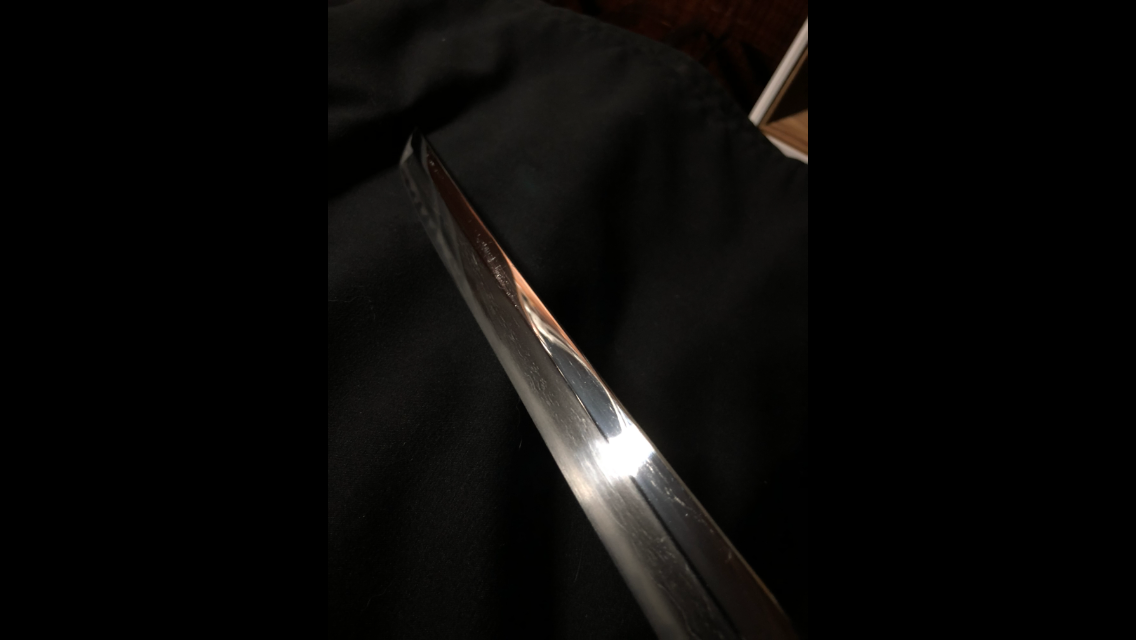

Greetings to you all, I have been studying this tachi I sent to the SF Shinsa last week. They pink’d it for gimei Kagemitsu. I understand this, they noted Mino 1550’s.
 Okay, so I’m posting some pics here for this curious feature: along the monouchi there is a spot about 6” long, about 5” back from Yokote, where the hamon becomes a strict suguha, having been gunome along the rest of the blade. At first, due to polish I thought it was an Urumigokoro, washed out, but took a pic in right light and saw the hamon was meant to be this way.
 I still have no info on the blade other than what I stated and that it’s a gimei Kagemitsu tachi mei.
 Kind regards for thoughts.
Ron84B66F1F-35F4-4551-96D8-674CE55B59A8.thumb.png.b3fc770bc1802a5ec75b43d84aa6e105.png1F19A05A-1901-4F05-B5A2-60CCB0F904DF.thumb.png.9d26e61b9b6ed98ef00ee260b22d1667.png2779F3AE-FB47-40C7-B5CB-6C76F9BC7F8D.thumb.png.582307f7c4eba50811d537d19b451819.png
When a sword is polished down, a complex hamon may be degraded to something more like a suguha or notare. Often when this happens the hamon may be weaker and more indistinct (shimiru). You see this a lot in Sue-Bizen kazuuchimono where the choji-midare turns into lower-lying suguha which is very unlike the healthier areas of the sword. You may find that the jihada changes in this area as well, being more likely to show shintetsu.

Thank you Ray. I attached an oshigata of a Kanemitsu with exactly the same feature. Is your opinion the same for this blade also? Regards F36A4386-5AB1-4722-BB06-729E8A7F2201.thumb.png.c52d98ebbf19f45f1ea889fb89c008af.png
It is difficult to evaluate a photo of a computer screen showing an oshigata, but it is possible there that the hamon is diminished due to being polished down. From what I can see, it is a signed Bizen Kanemitsu and with the mei it is possible for such a sword to still pass at the Juyo level with an intact mei of a highly important smith even if the hamon is a bit degraded.

It's just a variation in the hamon. It's very common and it's not due to polishing
NBTHK has proposed that sword in kantei.
They were more than generous with the attribution. Years back, if one presented a Gimei blade for Shinsa, all you'd get is the blade is Gimei. A good agent would have givin advise not to waste your time. Who was your agent? Remove mei the professional way, polish and reapply.

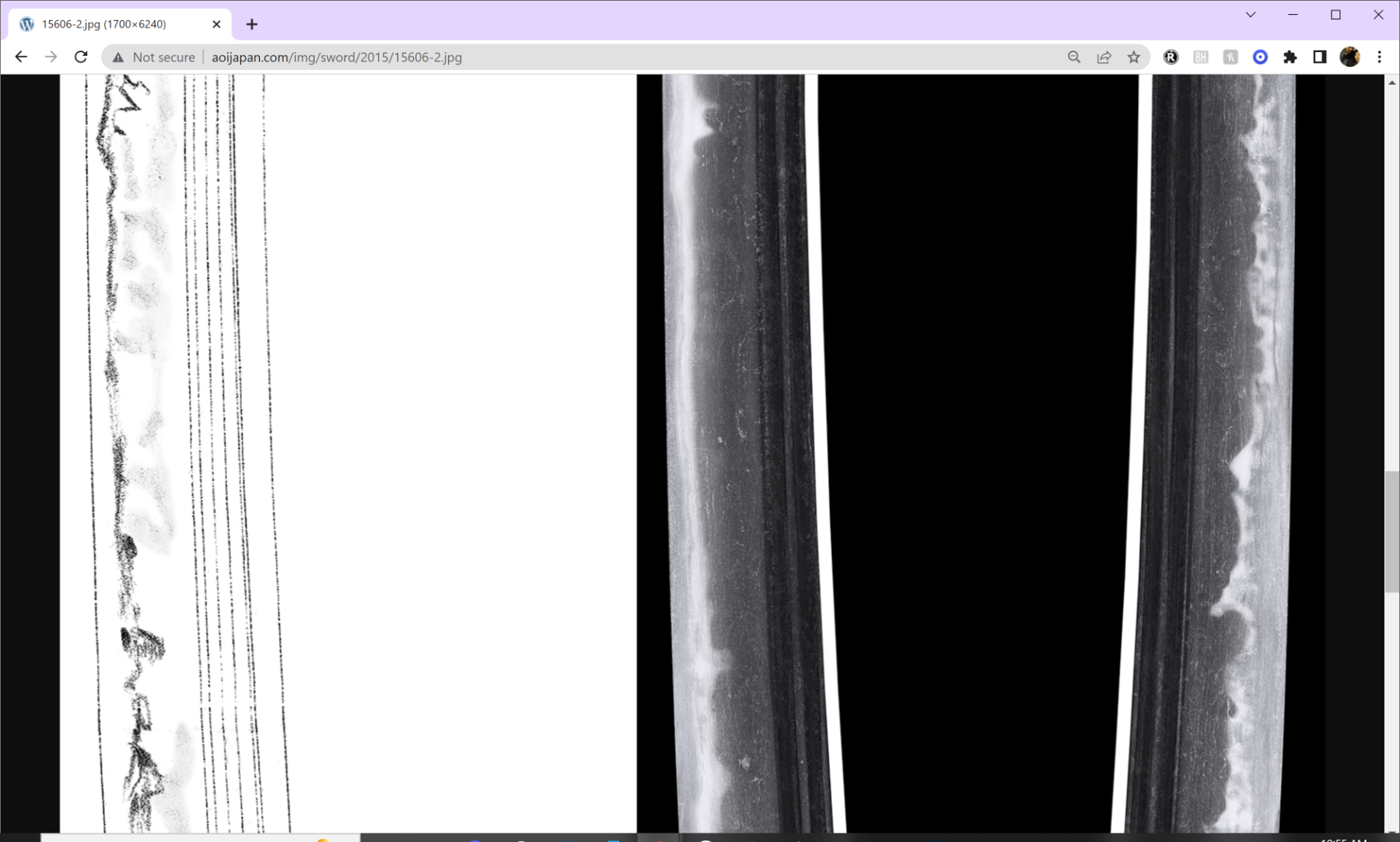

16 hours ago, Ray Singer said:
It is very common to see. This is an example below. http://www.aoijapan.com/img/sword/2015/15606-2.jpg
Ray,
Can you sahre the link towards the whole description of that sword, i can't find it and i want to verify something as I never believe what I am told without checking it.
I know that a hamon tends to disappear because of too much polishings, but stained? I wonder why and how. On the other hand, to claim that a hamon could change shape because of polishing seems to me a bit daring. It would be necessary that the polishings change the molecular structure of the nioiguchi, but they can't. For me it is rather a variation of the hamon as it was the fashion at that time
https://www.aoijapan.net/wakizashi-bishu-osafune-sukesada/
You can see this topic discussed below. And you will be able to clearly see there how the hamon has changed from its original shape after the blade has been reduced through polish.
http://www.ksky.ne.jp/~sumie99/effectofyakiire.html

Thanks Ray,
I know where I stand. About the anecdote, if this story is true (drawing is false), man have simply erased a part of the hamon which must make the rest of the nioiguchi difficult to see. See the sword in picture, man can clearly see that the nioiguchi has lost all its shine on a part of its length and yet it didn't change the design of the hamon. The polishing is in sashikomi the hamon is not hidden by the hadori.
