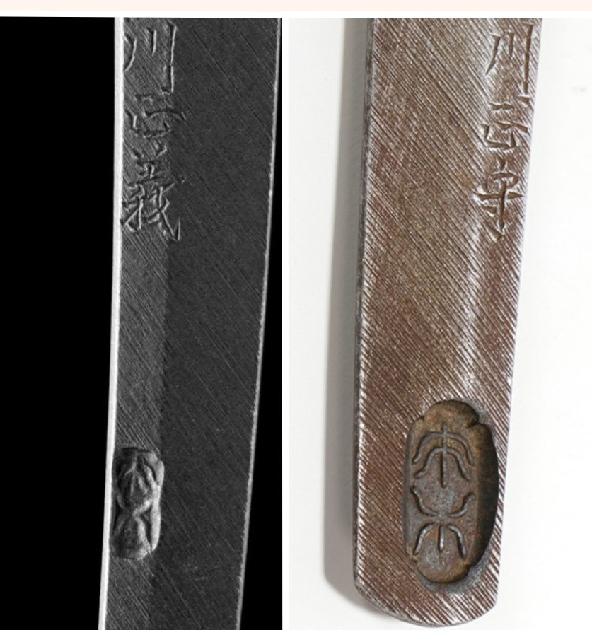

Hey Folks,
Sorry for the rushed pictures, its been busy around here as of late, and when work settles a bit I will take some better photos.  I am curious your thoughts on this blade.  It appears to be signed Masayoshi, but I can't quite make out the full signature.
Any thoughts are appreciated.
Cheers,
Jeremy
Over all the length is 84.5 cm
and the cutting edge is about 66cm
On 8/10/2022 at 8:04 AM, Jacques D. said:
Nakago jiri, yasurime, kao, and mei engraving are red flags.
Wow.  Can't speak to the rest, but the hotstamp (kao) does seem to be an imitation!  I don't think I've ever seen someone try to fake a kao before, but this one is clearly not right.  Observe the bottom character - it has a vertical line going all the way through, whereas the two in this example don't:
