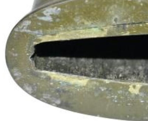

On the habaki question, one thing that strikes me is the shape of the habaki fitting into the fixed width of the Type 95 saya. Pretty sure that arsenal blades were thinner, less niku, etc as compared to forged blades like gendaito, nihonto, maybe even showato. It would be very challenging to create the custom fit for a habaki inside the metal Type 95 saya. Maybe this is why we see habaki on the Plimpton Yoshichika and the other one that Bruce documented (Yoshitsugu?) where they had Type 95 tsuka and habaki, but not the Type 95 saya.
 Regarding Habaki, when the type 95 was introduced there was a need for a catch up programme because a lot of them were needed all at once. As a result there was a mass conversion of type 32 to type 95. Mr Komiya covers it in some depth on https://www.warrelics.eu/forum/Japanese-militaria/ . How long did the conversion programme last, and was it restarted late in the war. When resources are stretched the habaki is a good candidate for being missed off.
(I have seen a genuine Edo era Satsuma/Okashi To where the habaki was no more than a piece of sheet brass wrapped round the base of the blade.)
You can see in the picture I posted of the inspection stamps on the mune how nicely the sword fits into the saya without a habaki. It’s a very nice fit without any wiggle. When the tsuka is assembled the whole unit locks up perfectly with the saya again without any play. Bruce, as far as the paint goes, it does look period when you inspect it in hand. IMHO I believe this sword was never issued this late in the war and was taken care of post war.

On the matter of the blade fitting the 95 saya, you can see on Matt's example the saya opening was re-shaped to take the slightly wider blade.  The adjustment looks old.  Tom's didn't seem to need the adjustment.
