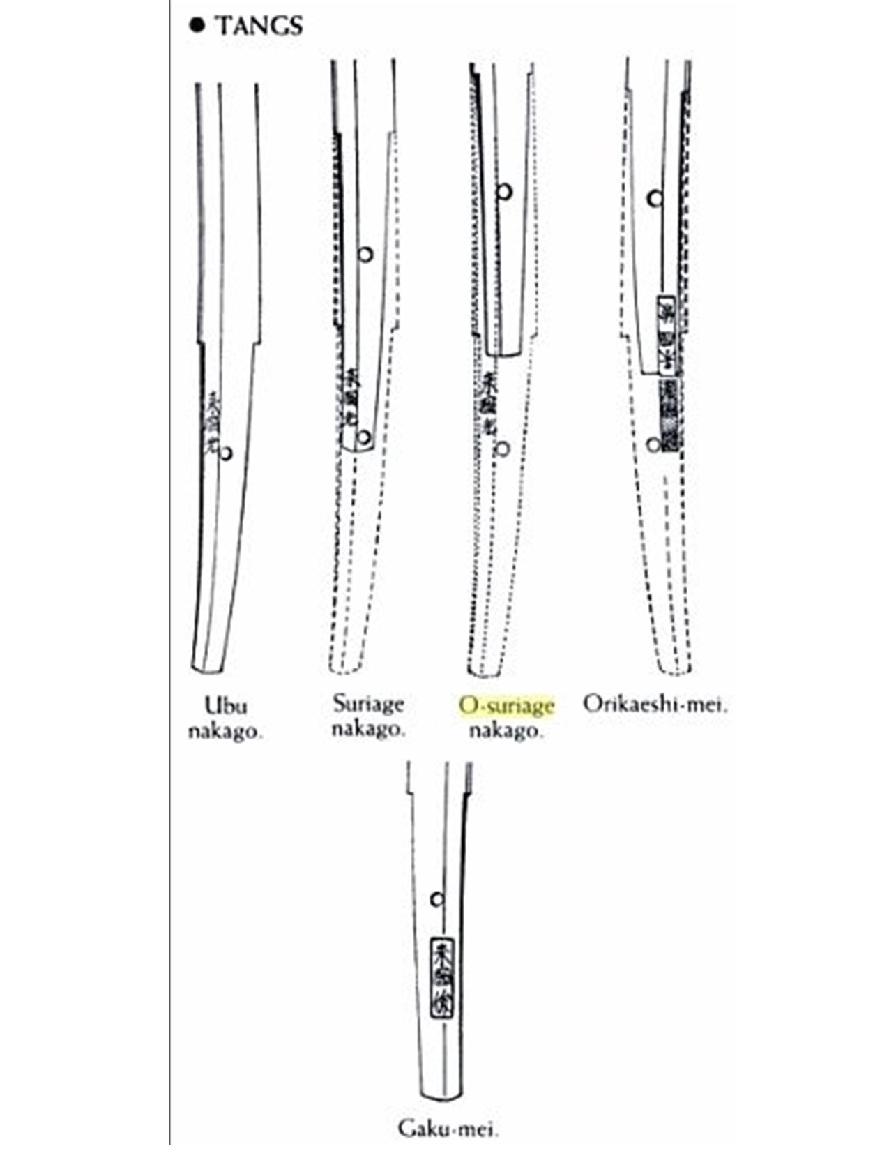

What is the rectangular section in the nakago? Some sort of repair?
Blade is O-Suriage. Original mei inlaid in nakago is my guess.

Hi Shamsy,   how have you been? If you look at inlaid mei which I think is called Gakumei it also has a ana which would make this nakago a 5 holer.  She's a old gal but still looks good kinda like Raquel Welsh.    If the mei is SukeYoshi then it could be a Ichimonji school piece which would be nice.   Wish I had a coupon for a polish!
Thanks, I have read about mei being 'folded back' onto the nakago when the nakago is shortened, I don't recall hearing about them being inlaid. A great bit of information with an example.
   Gents got around to looking at it today with my kanji sheet and Steve M is correct,  definitely SukeShige.   Might have even been a tsuku there at one time.   You don't find these really old blades often in military koshirae that is for sure.
