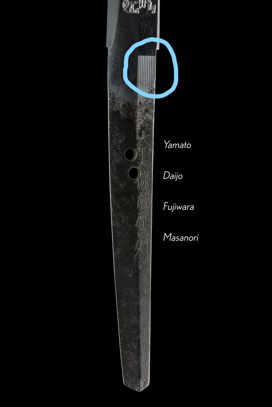

oneshot onekill Posted June 1 Report Share Posted June 1 I downloaded a picture from online to ask a question. The picture below is NOT my sword. I'm just using it to ask...What is this feature called and what is the significance? (The stripes) My Google-fu is lacking. 1 Quote Link to comment Share on other sites More sharing options...
b.hennick Posted June 1 Report Share Posted June 1 The lines are put on by a polisher. It may identify his work to other polishers or collectors who know what a specific polisher uses. You can also sometimes find such line on the kissaki area mune. The lines are made with a burnishing tool. 2 Quote Link to comment Share on other sites More sharing options...
Ray Singer Posted June 1 Report Share Posted June 1 John, see below. https://www.google.com/search?q=nagashi+lines+nihonto+site:www.militaria.co.za&rlz=1C1GCEU_enUS954US954&sxsrf=ALiCzsaCtFoMeOepSK2FLmV0Qdm4I6EoPg:1654098993504&sa=X&ved=2ahUKEwiPirn3zoz4AhUYmIQIHS1YAW0QrQIoBHoECA8QBQ&biw=1536&bih=849&dpr=2.5 4 Quote Link to comment Share on other sites More sharing options...
oneshot onekill Posted June 1 Author Report Share Posted June 1 18 minutes ago, Ray Singer said: John, see below. https://www.google.com/search?q=nagashi+lines+nihonto+site:www.militaria.co.za&rlz=1C1GCEU_enUS954US954&sxsrf=ALiCzsaCtFoMeOepSK2FLmV0Qdm4I6EoPg:1654098993504&sa=X&ved=2ahUKEwiPirn3zoz4AhUYmIQIHS1YAW0QrQIoBHoECA8QBQ&biw=1536&bih=849&dpr=2.5 Ah... Sorry. I just couldn't figure out how to describe them to get an answer to come up in google. My lack of command of the English language. 1 Quote Link to comment Share on other sites More sharing options...
