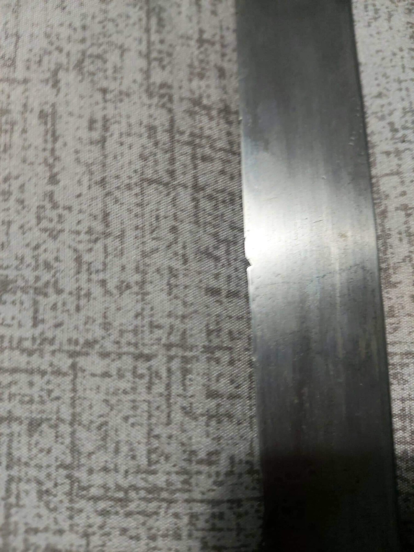

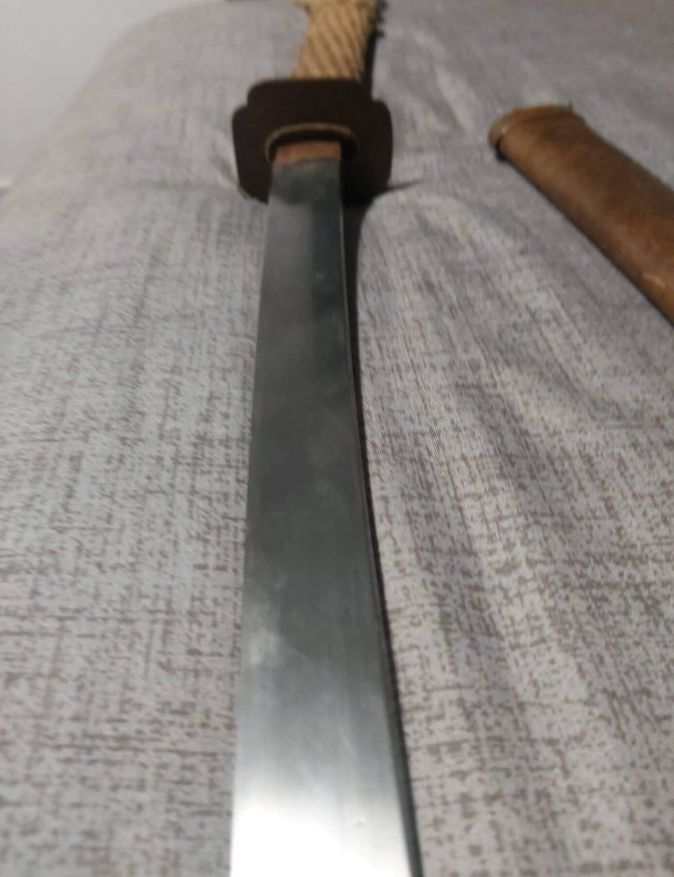

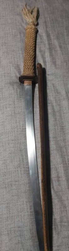

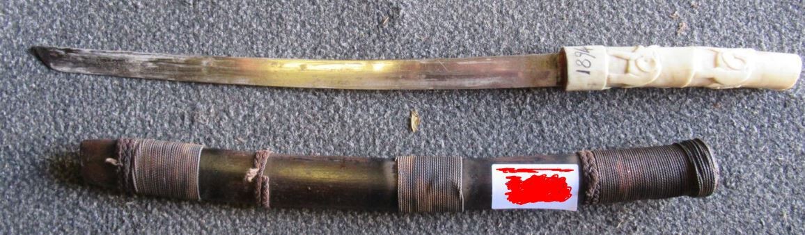

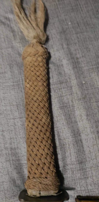

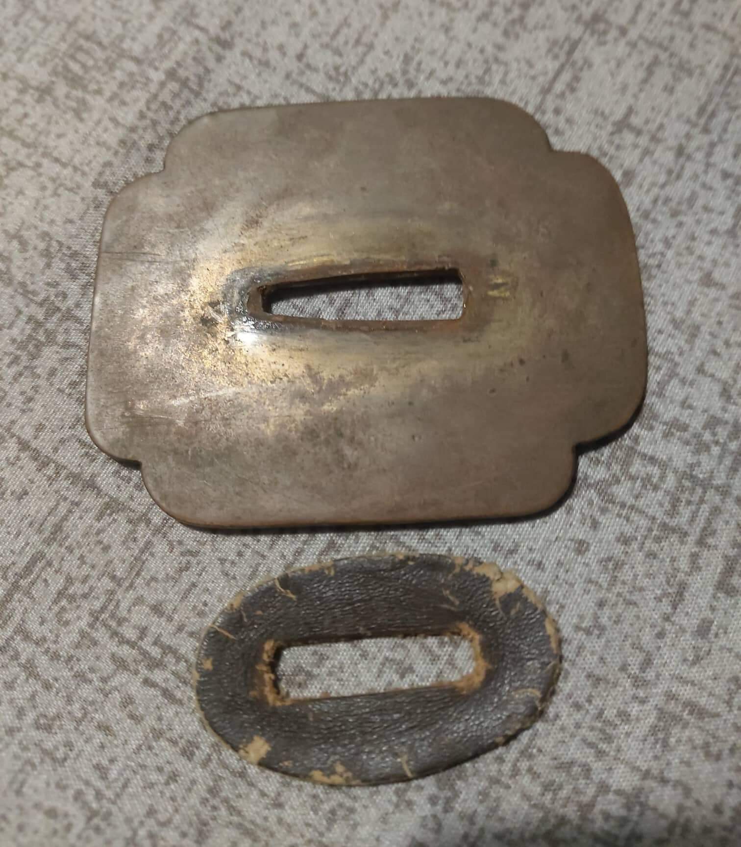

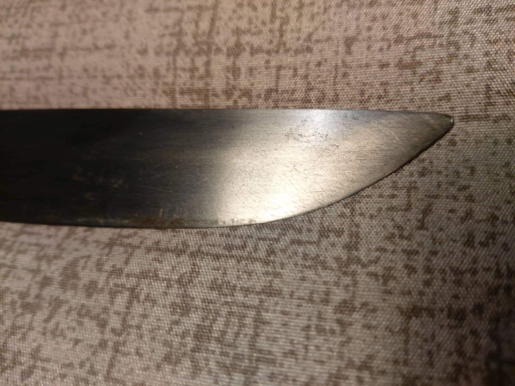

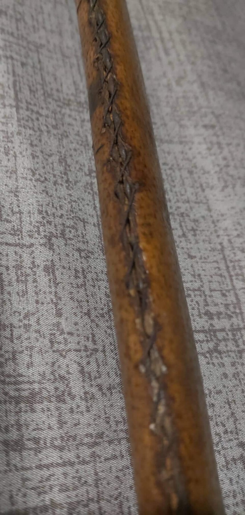

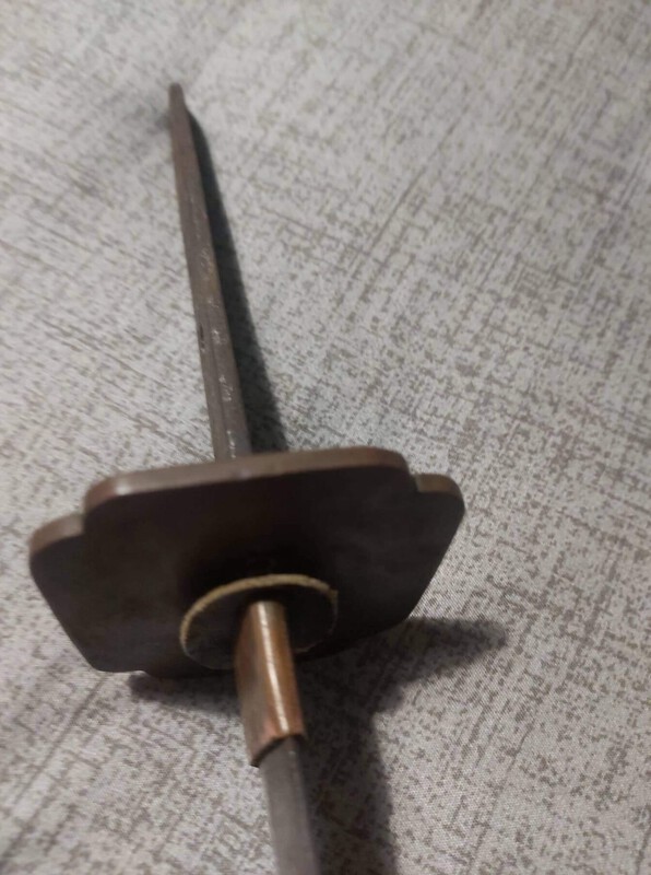

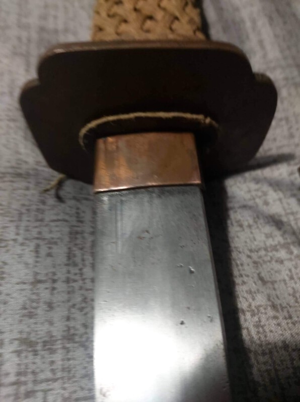

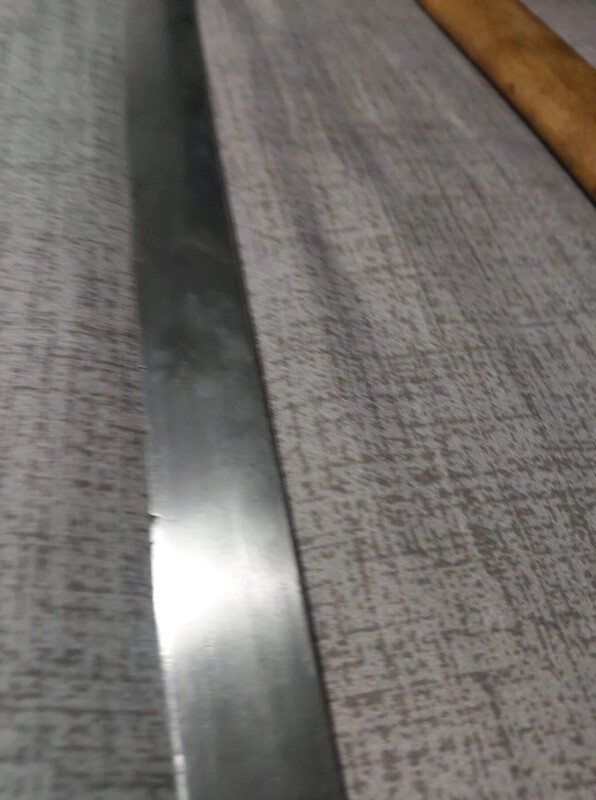

Brian Posted April 14 Report Share Posted April 14 15+ Years of Japanese swords, and I still know nothing. WHY is it always complicated? I am used to looking at a sword and instantly knowing it's either a fake or it's real. Works that way 999 times out of 1000. But every sword I come across lately is one of these "what the hell" cases where there are some ok features, and then some features that just don't fit. And I HATE that "Occupied territory" or "Post war souvenir" call. Because it is just so.... unresolved. Anyways, one that was first shown to me (pics, I have not seen it in hand yet) a looong time ago just popped up again, and frustratingly I can't make a 100% call. So I am here asking for other opinions to see if we have any consensus at all. Wartime indicators: That knot-work looks dead on for the type done by a sailor on the way back from Japan. We have seen it before, and it is a soldier's style of work that is known. So probably done by a returning serviceman. Can't see it done in Japan. So +1 for a wartime sword. "Combat cover" is crude, but could be a field done pigskin one? Tsuba is crude, but could be original. It's not terrible. BUT....nakago is not good. Shape is a bit crude, and that extra lower ana has no place being there. Nakago jiri is odd at best. Poorly shortened, or badly made? Patina isn't terrible. Blade is poor. Lots of nicks and the shinogi is polished away if it's there. I'm told the shape is shinogi zukuri....need to see it in hand. I don't see a Chinese fake here. But don't see a wartime Gunto either. I'm told the nagasa is 63cm. So, back to the original comment. Occupied territory sword (argh!) or soldier souvenir made from jeep spring (argh!) or something else. Only seen the pics on my phone, so will see them larger here as I upload them. Comments....aaaand...go! Quote Link to comment Share on other sites More sharing options...

Shugyosha Posted April 14 Report Share Posted April 14 Brian, That looks truly awful. Genuine or not, I wouldn’t want it in my collection in case some of the fugly rubbed off on the good stuff. Does that help? 2 1 3 Quote Link to comment Share on other sites More sharing options...

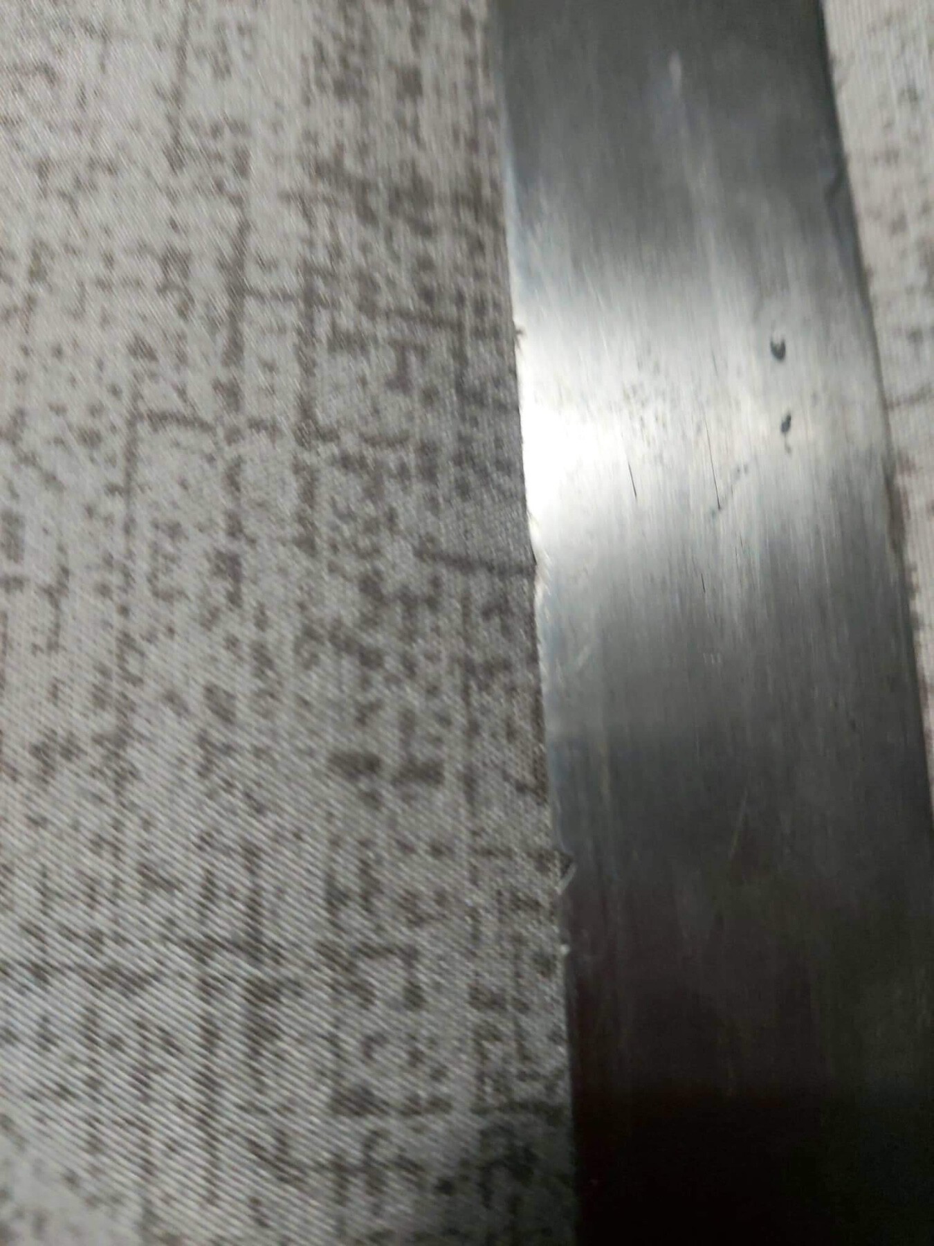

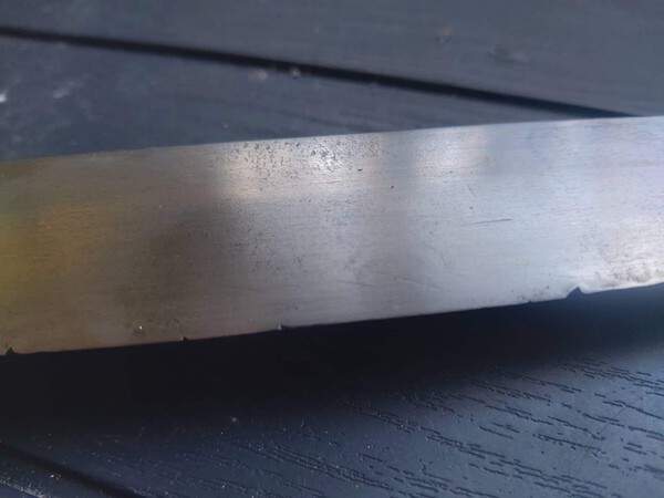

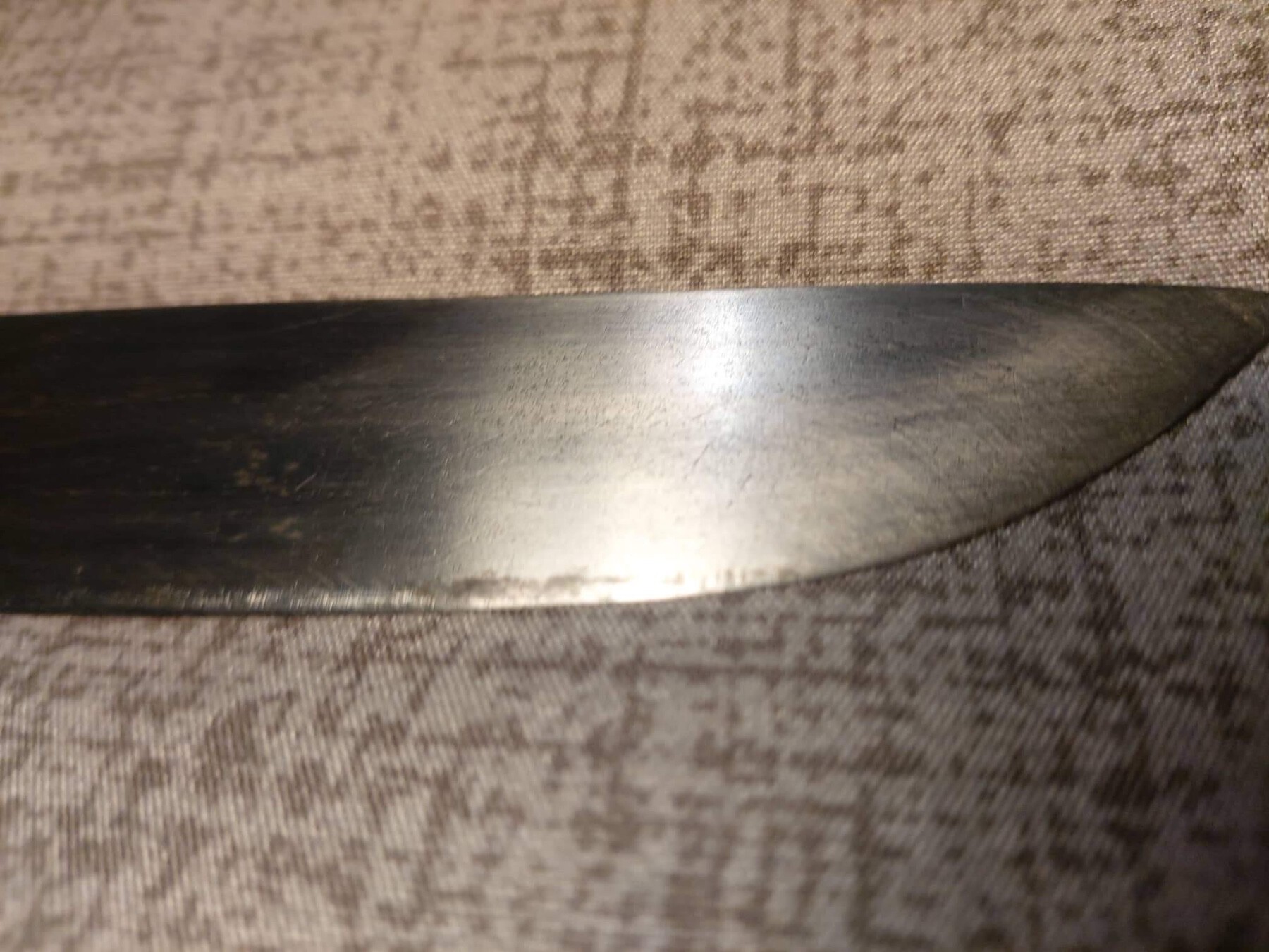

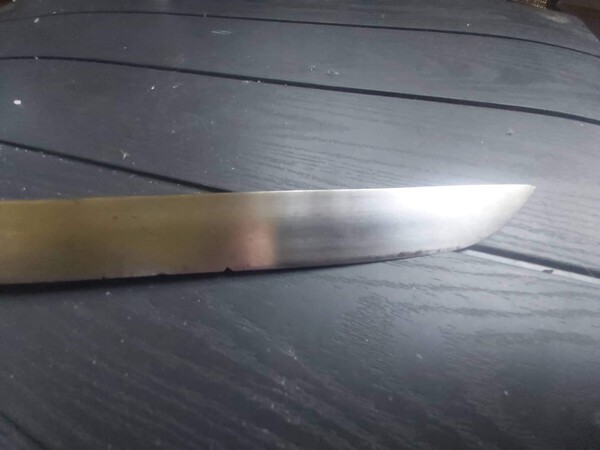

Brian Posted April 14 Author Report Share Posted April 14 Well, I'm going to ask the lady owner to come read the comments here tomorrow so she doesn't just have my opinion Looking at the pics on pc rather than cell, the blade does have a chance of being genuine...maybe....but very abused. Post war "sword fights" by kids as we see so often, and the shinogi line polished away. I agree, it's poor. That nakago bothers me though. If it had a nice Gunto tang...I'd be happier making a call as a poor Showato. Quote Link to comment Share on other sites More sharing options...
PNSSHOGUN Posted April 14 Report Share Posted April 14 Could well be island made, but agree with above....bloody ugly even if Japanese. Quote Link to comment Share on other sites More sharing options...
b.hennick Posted April 14 Report Share Posted April 14 This is not something that I could live with. Chips, pits, nakago, polish, tsuba all scream stay away. Don't waste your time or money. 1 Quote Link to comment Share on other sites More sharing options...
Stephen Posted April 14 Report Share Posted April 14 Not worth your anguish mate, and pass on that island to BS. Someone homemade project. Quote Link to comment Share on other sites More sharing options...

Brian Posted April 14 Author Report Share Posted April 14 Just to clarify, I'm assisting the owner with info. Not posting it because I'm pursuing it. Just trying to get her a decent description that can be used. She's dealing with the usual assorted collection left behind without good info. There is a variety of stuff. The knotwork is nice :-) Quote Link to comment Share on other sites More sharing options...

Utopianarian Posted April 14 Report Share Posted April 14 I agree with others. Looks like crude WW2 theatre made blade. Looks like my late aunt Tilly used her old lace doily to make tsuka-ito to gussy up that ugly stick 🤔 1 Quote Link to comment Share on other sites More sharing options...
Geraint Posted April 14 Report Share Posted April 14 It still seems to be the case that the habaki is a good give away, as in this example, it's not Japanese. Best case scenario; a theatre made souvenir. All the best. 2 Quote Link to comment Share on other sites More sharing options...
Stephen Posted April 14 Report Share Posted April 14 Ken no matter how cheap save your money unless you need a hedge trimmer. Quote Link to comment Share on other sites More sharing options...

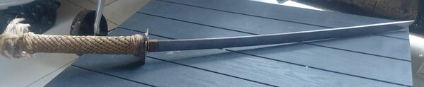

Bazza Posted April 15 Report Share Posted April 15 Brian, IMHO very definitely a field made sword that ended up as someone's souvenir and of truly minimal worth. As a 'pretend Nihontou' it is the worst of the worst. Geraint said it, the habaki is the tell-all, as is the tsuba, as is the nakago finish. As for Ken Maddock's piece, Ron Hartman once found a wakizashi dressed up and used a a Filipino cane cutting 'knife'. There might be something in Ken's piece if cheap enough to see if the nakago is signed, or even a halfway decent mumei piece. BaZZa. 1 Quote Link to comment Share on other sites More sharing options...

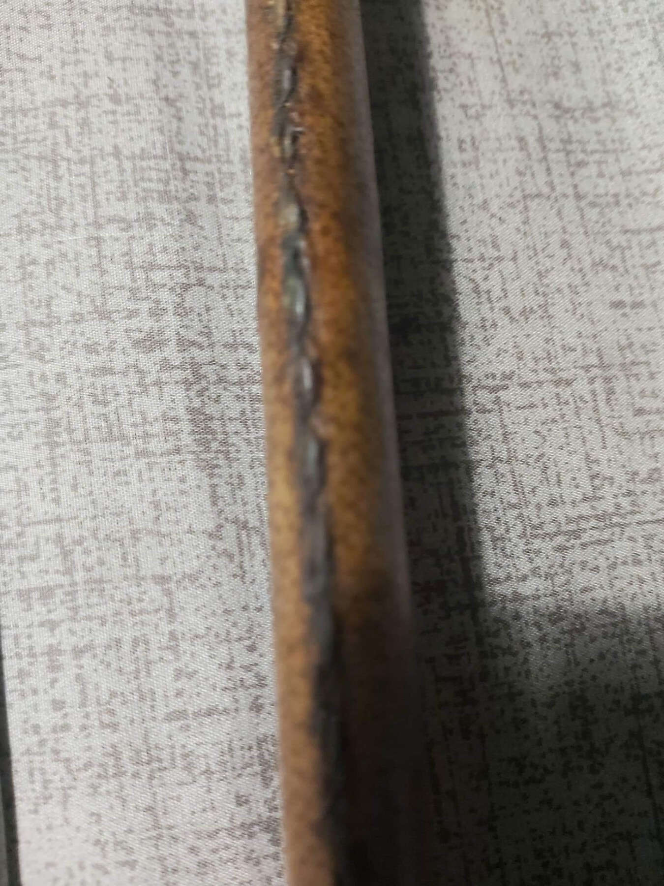

Mark C Posted April 15 Report Share Posted April 15 Got nothing more to offer that has not already been said but what are peoples thoughts on the saya cover? Doesn't look like the normal leather usually found. Mark Quote Link to comment Share on other sites More sharing options...
Bruce Pennington Posted April 16 Report Share Posted April 16 Never seen a skin saya cover like that! Can even seen the hair dimples. Everything about this matches what we are seeing in the island-made swords. Same lower quality steel, with no polish, flat look; typical nakago. Tsuka wrap is unique, and like you said, Brian, could have been a returning G.I./sailor, but it looks like someone was imitating a ratan look fitting of the Philippines or somewhere in SE Asia. 1 Quote Link to comment Share on other sites More sharing options...
Brian Posted April 16 Author Report Share Posted April 16 I think the improvised combat cover must be something like pigskin 1 1 Quote Link to comment Share on other sites More sharing options...
johnnyi Posted April 16 Report Share Posted April 16 The knot work is humble but lovely. Reminds me of the old timer's sea bags I'd see in the service years ago that were covered with the most ornate knotwork, and crown knots similar to what this has. Maybe a sailor's property? Quote Link to comment Share on other sites More sharing options...
Brian Posted April 16 Author Report Share Posted April 16 Here's Ray's discussion on this sort of knotwork on Japanese swords https://www.militaria.co.za/nmb/topic/27285-decorative-knottery/ 1 Quote Link to comment Share on other sites More sharing options...

Dave R Posted April 17 Report Share Posted April 17 My ten-pennyworth is that it's a theatre made fake, either by the CB's or the Australians, both groups renowned for this activity. Made to be sold to the second wave of troops who wanted a "reel samury" sword to take home. These were even mentioned in the 1960's war comics I read as a nipper. 2 Quote Link to comment Share on other sites More sharing options...
