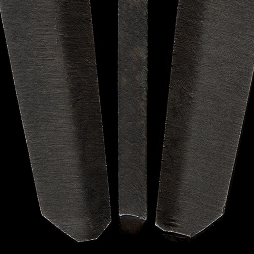

3 minutes ago, JakeNYC said:
image.png.ba81bd657428a8627d90c7713103a0cf.png  Not exactly sure what the deal is with this
Jake, yeah not sure what's going on down there.  You can see on one of the pics below the end of the nakago is cut at an angle for some reason...can't imagine why.
