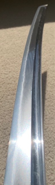

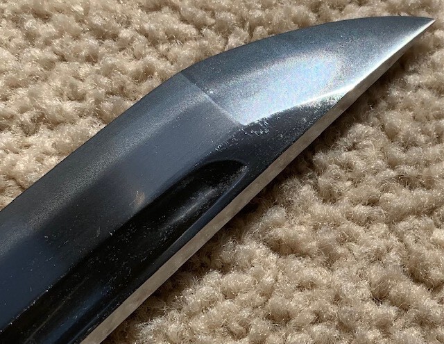

Hi all,
Just picked up two new blades.  I’ll be bringing them to the Chicago Show for some ‘in hand’ advice, but figured I would start here for fun.  First blade is a wide thick heavy wakizashi with the following information:
Mei: Omi no Kami Hojoji Tachibana Masahiro is how I translate it.  From what I could find on line, the way a couple of the mei are cut, I believe the mei points to the first generation?  Any Masahiro experts want to weigh in on how comfortable they are with this mei?  Nothing on other side of nakago.
Nagasa: 52.23cm
Nakago: 15.1cm
Sori: 1cm
Motohaba: 3.2cm
Motokasane: 7mm
Sakihaba: 2.3cm
Sakikasane: 5mm
Kissaki: 3.7cm
Yokote: 1.4cm
Weight: 541g
Hamon appears wide suguha on first appearance, but abundant ashi give the effect of gunome within the suguha.  Attached are a few quick pictures in the sun.  There may be some reflections of trees, etc on the blade, but polish is fair.
Thanks for any advice or comments.
