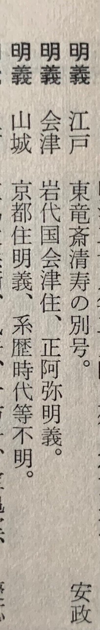

comparing our tsuba mei, they look quite different especially at the Kao level (despite the bad picture quality). Piers' information that we face 3 different  Aki Yoshi tsuba makers makes sense.
The three Akiyoshi are (according to Wakayama)
1. Akiyoshi of Edo, who was the student of Haruaki. Of the Gotō line. I think this is whithout a doubt the smith who made John's tsuba above.
2. Akiyoshi of Edo and Aizu. Shōami school. Wakayama says he signed as Bukō-jū Akiyoshi (kaō). It doesn't say if he used other signatures. I think this is the best candidate for Bruno's tsuba.
3. Akiyoshi of Kyōto who signed Akiyoshi-saku. Mid Edo. Not much known about this smith.
These are more or less consistent with the smiths in Piers's post.
