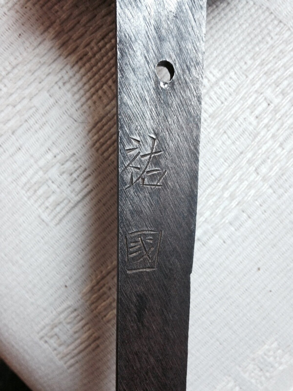

Kenny,
I once owned a Feb '45 Sukekuni.  I wonder why the box is missing around the kanji for the "kuni" on yours?  Just another example showing that the Japanese weren't flawless perfectionists in their work!  is yours in the standard tan fittings?
Here's the mei from mine:
國 (or 国 in its abbreviated form) has a calligraphic form that is very highly stylized. The stylized form has no box around it. It is one of those calligraphic forms that look absolutely nothing like its normal form, and makes people scratch their heads.
https://word.4ndex.com/name/2-1/215-kuni.html
Plus, if I'm not mistake there were at least two gunto smiths who used the name Sukekuni. I don't know which one this is. His calligraphic style should give him away.

I can't get a "Kuni" out of this nakago. And IMHO the suke part is pretty dodgy.
In a real sense, tho, that doesn't matter. What this sword tells me about is 1) the tragedy of Japan's involvement in the War, with them trying to produce swords when aircraft carriers and tanks were deciding the conflict, and 2) the clear evidence that swordsmithing in Japan is a complex - well- "art" that involves thorough mastery of blacksmithing and tangential crafts like signing an art name with a chisel.
I find this sword tragic.

Steve,
Thank you, "YES" I see the resemblance. And I assume that this sword was made by a fellow named Sukekuni. Your help and guidance is always important to us. In this case the swordsmith may have been aiming at a distinctive style, but to my eye it does not look to have been skillfully rendered. And this kind of stylistic refinement hardly seems worthy the moment, especially when it turns out that the smith went back to the BOX Kuni a month later.

On 1/16/2022 at 5:49 AM, Bruce Pennington said:
Kenny,
That is correctr, Bruce, It was plain tan fittings
