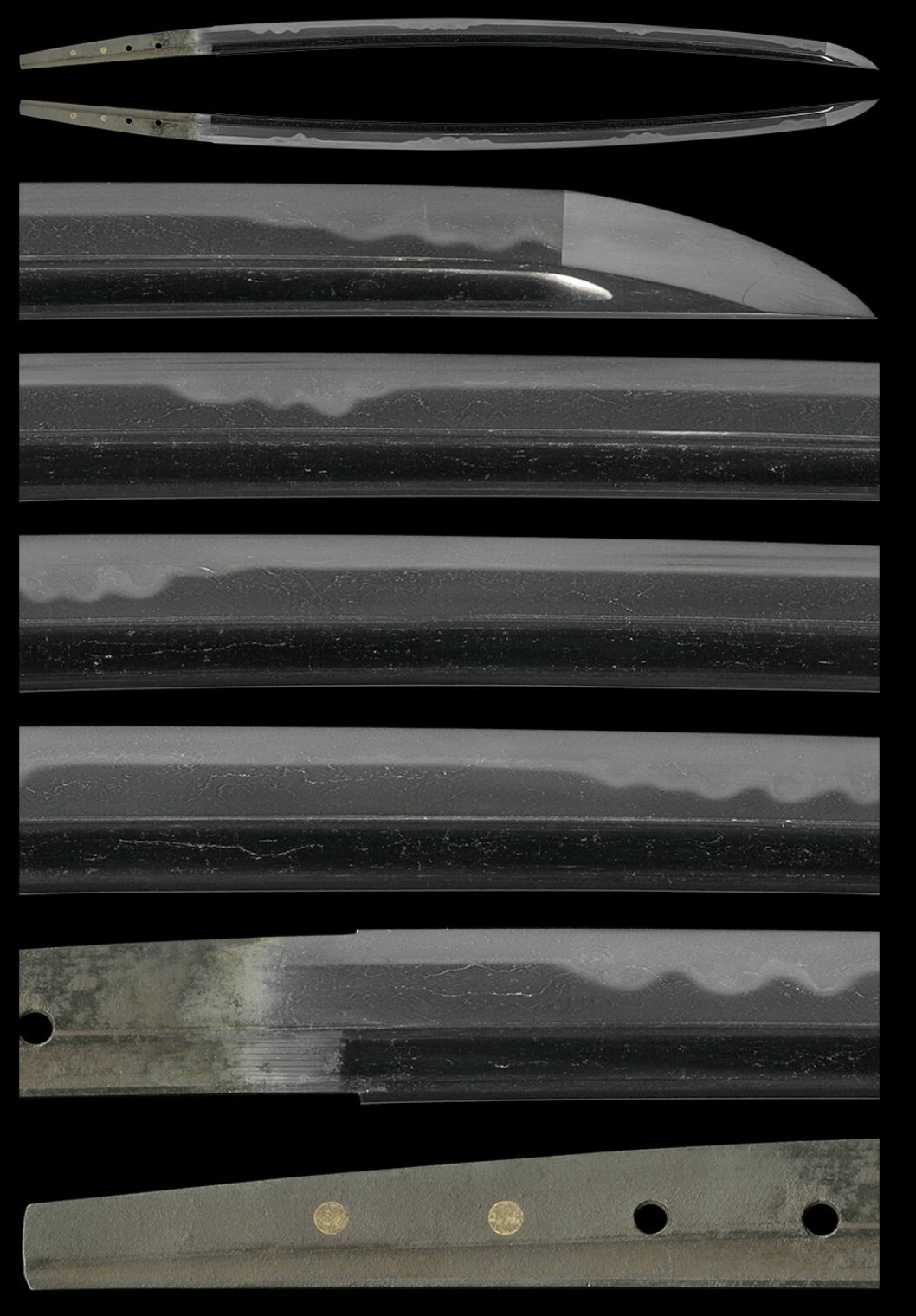

So at risk of perhaps of someone else snagging it I'd like some opinions on this blade.  An o-kissaki blade has been on my check list for a long time now.  This one has caught my eye, love the length, age, the filled mekugi ana, wish it was signed but its been shortened quite a bit so that's way gone now if it ever existed....it has a kantei by Mr. Matsui Fujishiro Masamitsu which I'm not sure the weight it carries but better than no papers.  In full koshirae with no shirasaya....polish looks good with some flaws...but there she is...thoughts on the sword as my potential o-kissaki purchase?  Also anyone purchased from this company before?
https://www.nipponto.co.jp/swords7/KT334374.htm
For convenience photos are also posted below.
I checked it when it appeared on the site few days ago. I like the size & shape and of course the treasure hunter mentality peaked and I was toying with the possibility if it could be bit older. However I would think the Late Muromachi and Mino is sounding like a very reasonable origin, I do not have the knowledge of picking individual smiths.

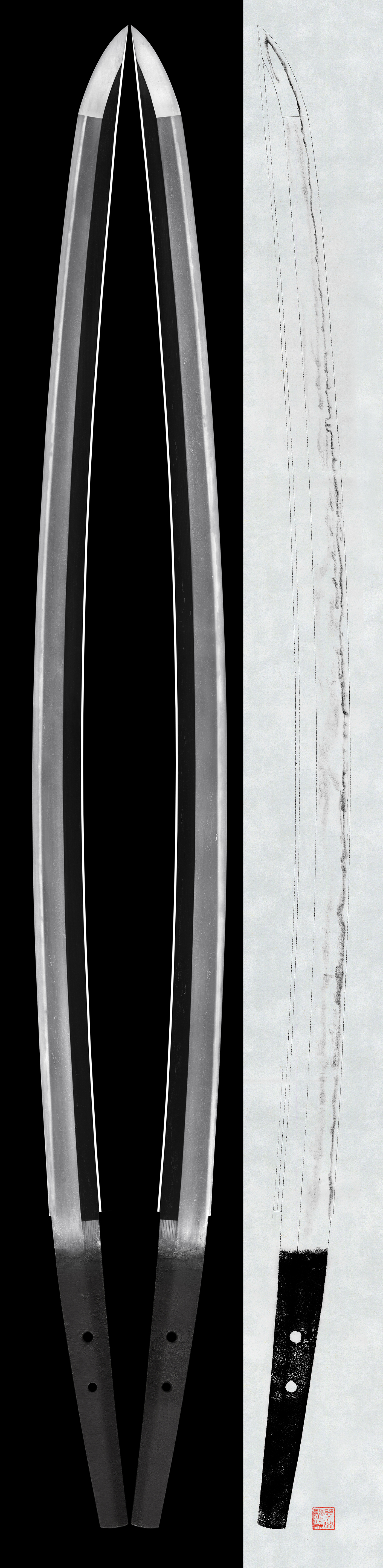

Interesting feature to me is that when you look at the sword both sides side by side the 4 peak portions kinda mirror each other. I could not find reference examples by this Kanesada (兼貞) quickly so I don't know if it is a trait seen in his work.

It also caught my eye that the hamon of the two sides aim to mirror of a sort.  I have seen other blades with that feature and always liked it aesthetically.  I also like hamons that have some suguha that spikes into other activity and back to suguha.  It would also be my longest blade at over 28" nagasa and my one and only o-kissaki example I'd purchase.  I'd have to sell this o-kissaki katana (via my own self imposed rules) if I was ever to purchase another so don't want to make a mistake.  Lastly, I know it's muromachi which can have a reputation for quantity over quality but this appears a nice blade.

Honest opinion?
Yes, the Toushin and the dimensions look impressive. The Hada very soshuesk, but also fits for Sue-Seki. The strong Hadori makes the blade very showy.
But the reflection photos make me think and do not fit the first, exuberant impression. The nioguchi seems very thin and powerless and has no luminosity. Also, the Ji seems quite dry, as if hardly Ji-Nie is present.
I may be wrong based on the photos, but I fear the blade looks more than it really is.

I like the shape of the sword. The blade has a proud, confident shape. And if the shape is good, that's always a good sign for the rest of the blade's qualities. That's why I was surprised myself that the Nioiguchi presents itself so weakly on the reflection pictures. It just doesn't fit. Sue-Seki smiths in particular usually have a dense, strong nioguchi hardened - even if not always in luminous appearance.
But with this blade, I can't shake the suspicion that the strong hadori is meant to cover up the weakening hamon. Why this is so, I do not know. Possibly due to external influences, such as heat. But this is speculative and can not be judged only from the photos.
And as I said, I think that this blade, especially with the existing Koshirae was used by a Iaidoka and I fear that this sword is essentially aimed at clientele in this area.
