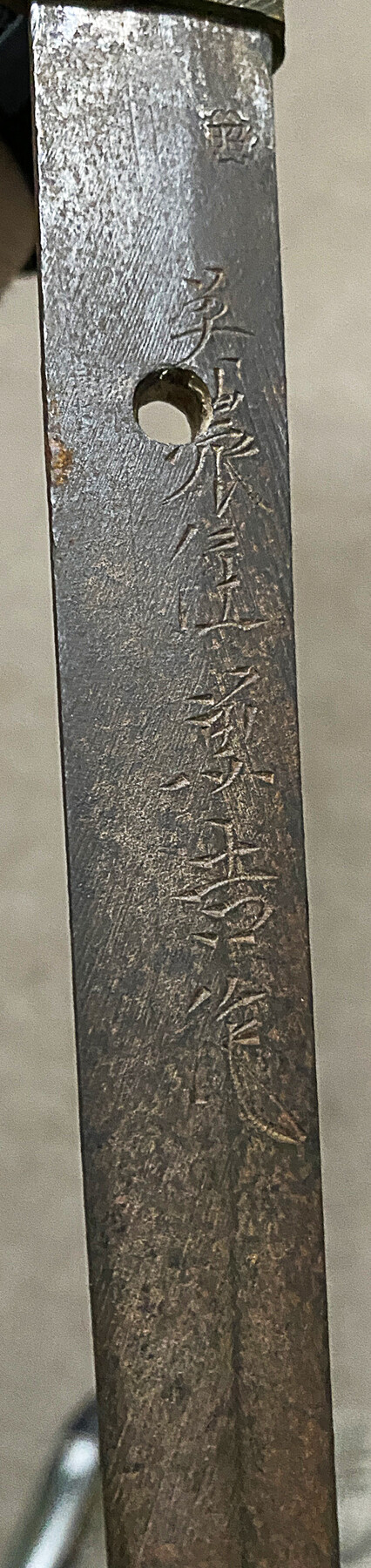

I recently acquired this katana. I can see that there is a Showa stamp at the top of the tang. Was hoping this community could help me translate the rest. Thanks Eric
FYI. There is only writing on one side.

A bit hard to see for my old eyes but I think it is signed by Kaneyoshi.
I think your tang is signed MiNo Ju KaneYoshi Saku  (Resident of Mino, Kaneyoshi made (this)).
there were two of this name that I am aware of - both working in Seki.
Yoshida Kaneyoshi started as Seki smith 8 Oct 1939
Matsuhara (also Matsubara) Kaneyoshi started at seki 11 Nov 1941
Not sure which is yours...

Thanks George
This help a lot.
Do you know where I can do more digging on the Seki?
I feel I might be going down a rabbit hole.
-Eric
Eric
As George read “Mino ju Kaneyoshi saku”  and this one is Matsubara Shozo Kaneyoshi.  Born Taisho 10 (1921 Jan 20).  He was a student of Watanabe Kanenaga and the younger brother of Nakata Kanehide.  He later became a Naval swordsmith.  Summary and examples in Naval Swordsmiths Part 2, in the NMB Downloads.   With a Sho/sakura stamp is an early war Showato.
