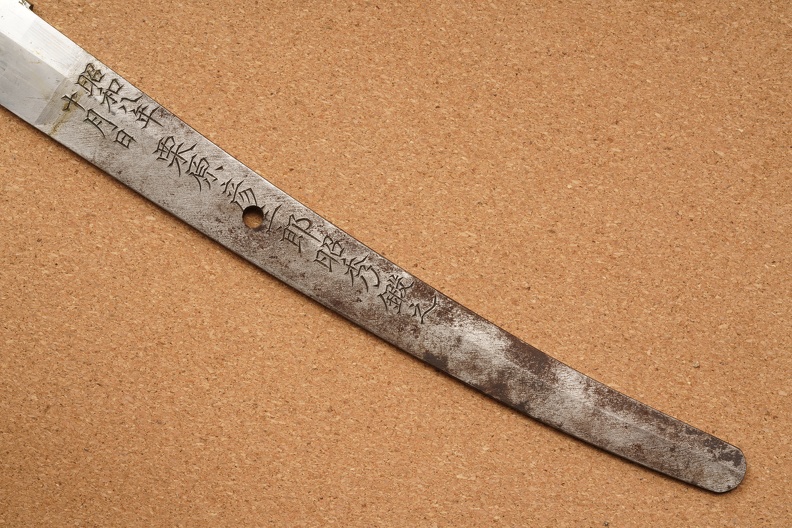

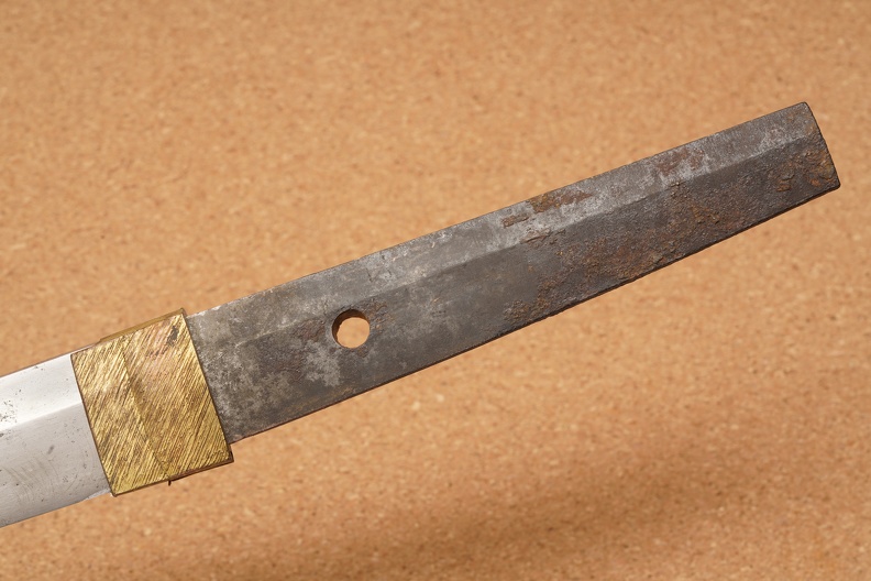

A friend of mine with an extensive collection of militaria, much of it WWI and WWII, has passed away.  I agreed to help the family identify and find homes for his collection, that they didn't even know existed. For years I've been helping him sell sabers, bayonets, uniforms, etc.
I have photos of two swords that appear traditional, though I doubt either are significantly valuable.  I'll post one at a time so there's time for clear discussion.  I also have several for the military forum, both forged and stamped.

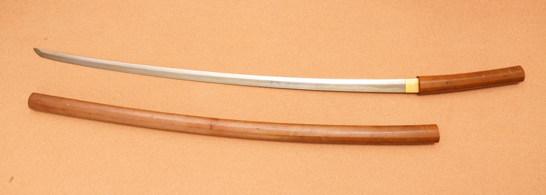

This tachi appears to be relatively recent, and the shinogi ji appears to my eye to have been buffed.

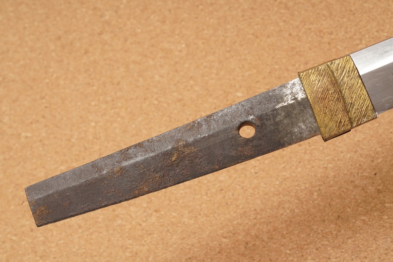

Kurihara Hikosaburo Akihide kitae kore
Showa 8 (1934)
October
栗原彦三郎昭秀鍛之
昭和八年十月日
tempered for Prime minister Saito Makoto
内閣総理大臣齋藤實 焠之
Looks to be a potentially historically significant blade
Any more pics of blade up close?

The nakago has an old shape, very interesting.  Please take some larger pictures of the blade, both sides. How long is the cutting edge?  You must have German WWII relics.  What a headache to empty the house. My sister is the Queen hoarder, large house, you need a map to walk through the place. Plus seven full sheds, garage, and two large trailers. Her daughter, my niece who lives in Maryland, will have a fit, she hasn't got a clue. And, has four cars in her driveway. Good Luck.

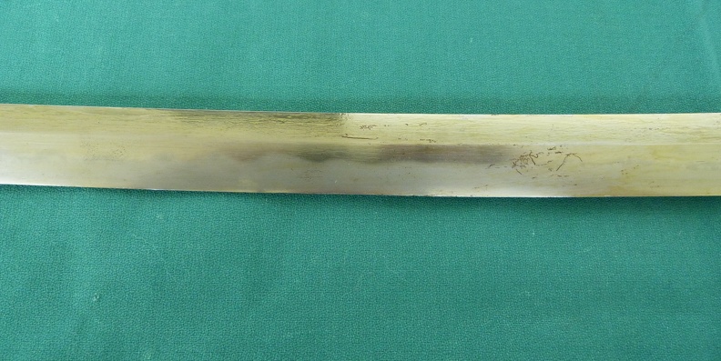

37" straight measure of the blade.  38" along the curve. Minimal nicks that don't seem to exceed .015" by comparator.  What I thought was scrapes on the shinogi ji appears to be varnish or lacquer, which is why the little rust there is is spidery.

Old dried oil?
I don't think so.  There's no tack at all, and the color looks like varnish. I could try using denatured alcohol or acetone to remove it.

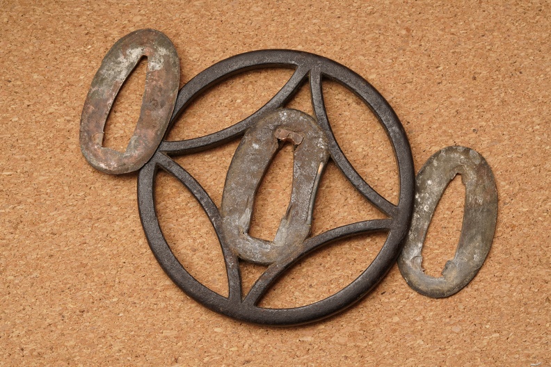

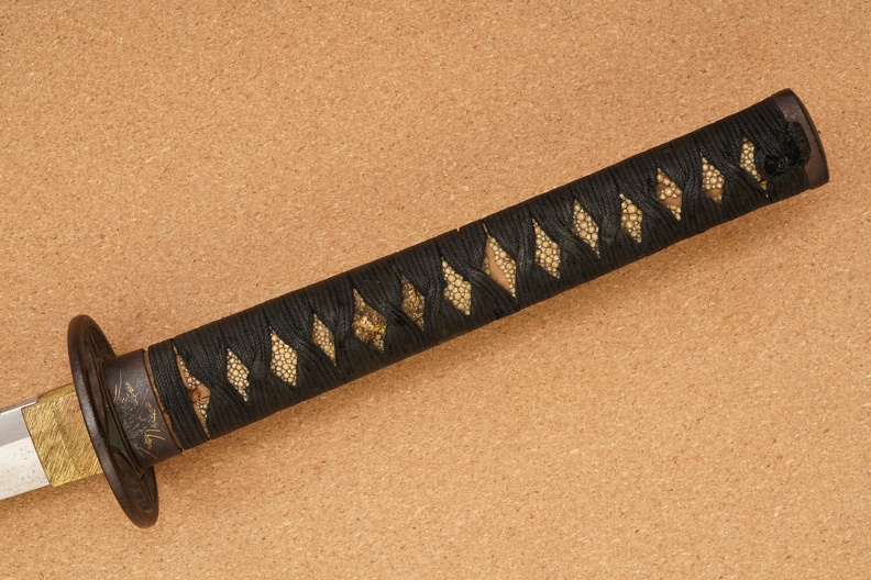

Here's the other traditionally forged and mounted blade. I see at least two cold shuts in the surface layers.
apparently he didn't get pictures of the blade or saya. I'll do my best with some better lighting.

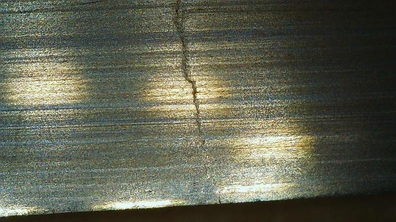

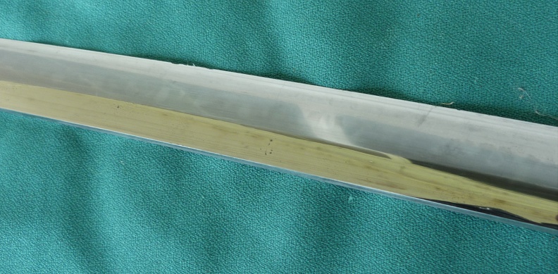

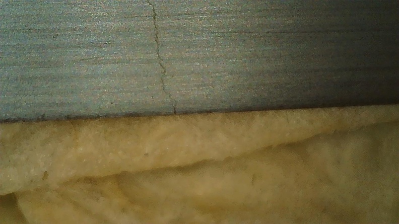

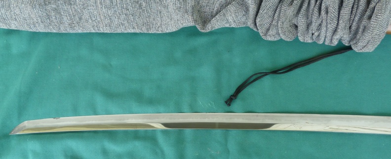

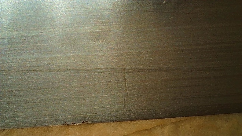

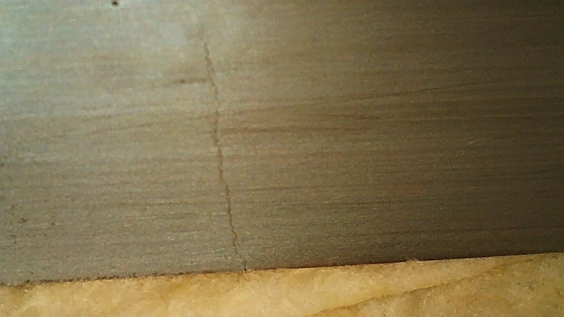

I cleaned the varnish off the tachi, and found three cracks. Two are completely through the hamon.  I hate to bring bad news, but obviously, that's important information.
In this location, as shown by the cord.
Establishing shot.
On microscope:
Share this post
Link to post
These are definitely HAGIRE, but the blade may still have some historical value. The Prime minister was obviously not trained in YAKIIRE......
And I like the TSUBA.
