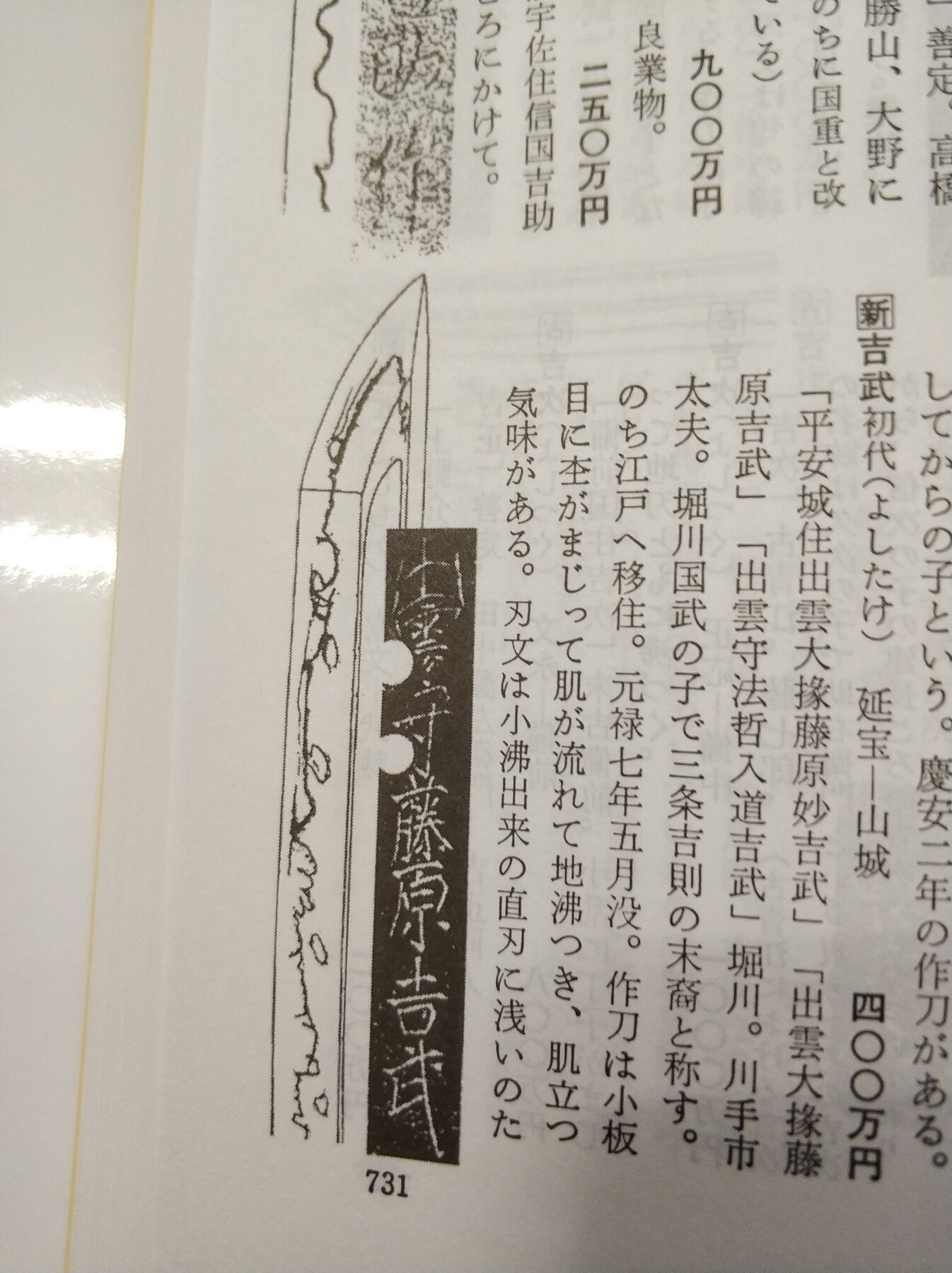

Dear John.
Unlike some smith names there are very few Yoshitake to deal with, some sources claim two generations, some three.  As far as my research goes none of them was ever Izumi Daijo so I fear we might have unearthed a slip of the keyboard in Marcus' excellent work. (And also Tsuruta san's.) The sword you linked to is an Izumo Daijo Yoshitake so no worries on that score.
The other differences in titles is to do with the smiths changing their honorific during their careers, I have a second generation blade with the Izumo Daijo title.  Having done some digging into that one made reading the mei much easier of course.
 There is a good write up here, https://www.worthpoint.com/worthopedia/tokubetsu-hozon-nbthk-jo-saku-nihonto-1867295911  ( I am sorry to have to use this link but I can't find the original from Nihontocraft).  The example that Steve has is quite close to the mei on this one.
All the best.

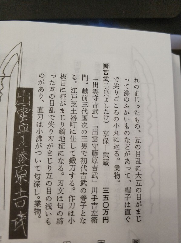

I've not been able to find an example of a signature attributed to the first generation. He gets a more than respectable 70 points in Hawleys so it would be worth trying to tie it down for the owner - maybe shinsa in the USA if there's one soon. The only second generation signature I could find in my sources was in Fujishiro and it looks different to this one - similar to the one on Shoshin.
I agree that shinsa would be ideal.  The one I linked from Nihontocraft is as close to the one that Steve has posted as I can get and it states the date as 1624 which is comfortably shodai.  Most of the mei I have seen are cut with a rather thin chisel and have the characteristic 'broken back' to the first kanji.  Steve's sword does not have these features but it seems closer to the Nihontocraft example.
Would love this to be just such a result.
All the best.
Thank you for those Matt, they illustrate the shape of the first kanji and the slightly thin chisel strokes very well.
I don't have the book 'Japanese Swords in American Collections' by Dan Massey an entry in it suggests that there are two signing styles for the shodai and that might account for the differences Inoted and give us some hope for the posted example.   The sword referred to in the book is possibly the sword I linked to above.
As regards the titles of the generations, in various places both are listed as having held both titles at different times.  Nihonto 1, a magazine published by the Token Society of Great Britain, illustrates a papered katana with the Izumo Daijo mei of the nidai, the Wazamono listing has both, each having the Izumo Daijo title, and so on.  I think we have to assume that the Toko Taikan is not totally inclusive in this instance.
All the best.
