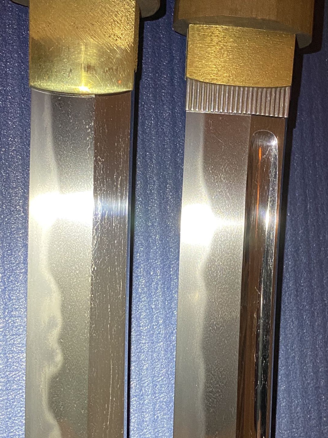

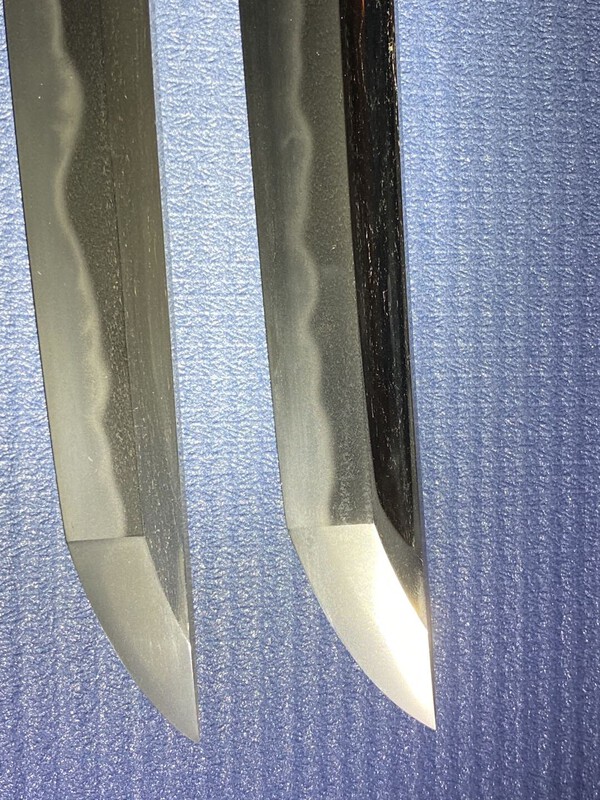

Kotetsu VS Aizu Kotetsu
Like a master and a pupil similar ?? :)
I have an aizu nagamichi but mine has a some spectacular inazuma all over. It is hard to tell in your photos. Beautiful nonetheless
John
There is a resemblance in the design and the width of the hamon but we can't talk about similarity in terms of quality, Kotetsu being far superior to Nagamichi.
ps does this kotetsu have papers ?
John
Nagamichi have some different style. Anyway I show whole photo for you .
and I also up some Video for this Nagamichi, just for clear to see
Hi Jacques, yes, Tokubetsu Hozon Paper.
Anyway, In a smith whole life, then will make alot katana, and There are differences in quality and style.
Yes, but we must judge the difference of level over the whole career. Nagamichi is known to make a hamon (sori too) in the same style as Kotetsu but the resemblance ends there. As for the nickname, it doesn't mean much in reality.

52 minutes ago, DoTanuki yokai said:
I can understand that it is believed that nagamichi studied with kotetsu seeing this blades next to each other.
But is there any historical  evidence except of their workmanship for knowing each other ?

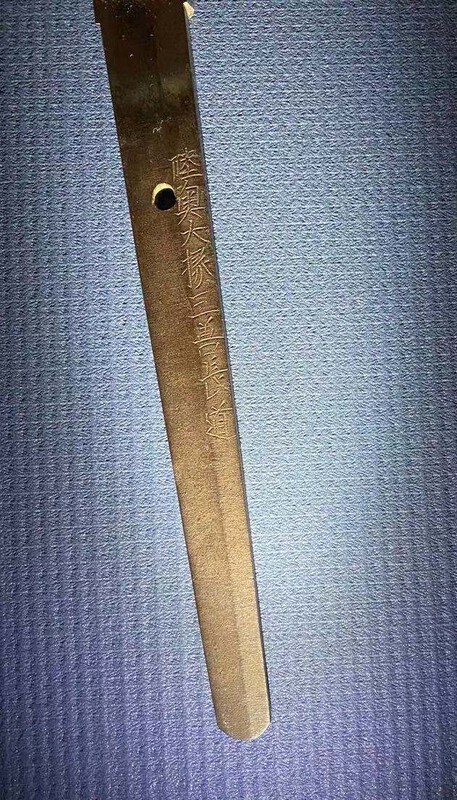

Kotetsu maybe born in A.D 1605 , and A.D 1678 passed away. At the age of 50 star to make katana(1655).
Nagamichi born in A.D 1633, and A.D 1685 passed away.At the age of 26 used signature is "Mutsu Daijyo Miyoshi Nagamichi"
And Nagamichi also have other nickname "AIZU MASAMUNE".
So,maybe just same style to make sword.
Nagamichi never studied with Kotetsu, he was an apprentice of his uncle Nagatoshi. :)
For once we have a picture allowing it, it is interesting to look at the hada. They are 2 ko-itame and yet they are quite different from each other, the one of Kotetsu is more dense and stronger than the one of Nagamichi.
It will be worth to note that Nagamichi's hamon looks like Kotetsu's but during his hanetora period; the sword showed here is one of the hakotora time so there is not that similarities.  i should have been more precise in my first comment. :(

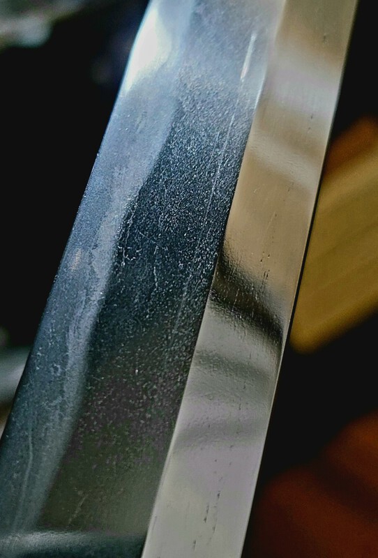

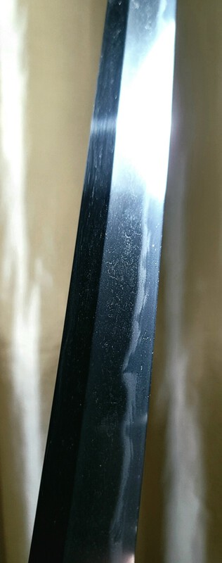

18 hours ago, Toryu2020 said:
The differences are in the jigane, the boshi and the amount of nie...
I can't tell from the photos. Both swords are eerily similar to me in design, construction, jigane and sugata.

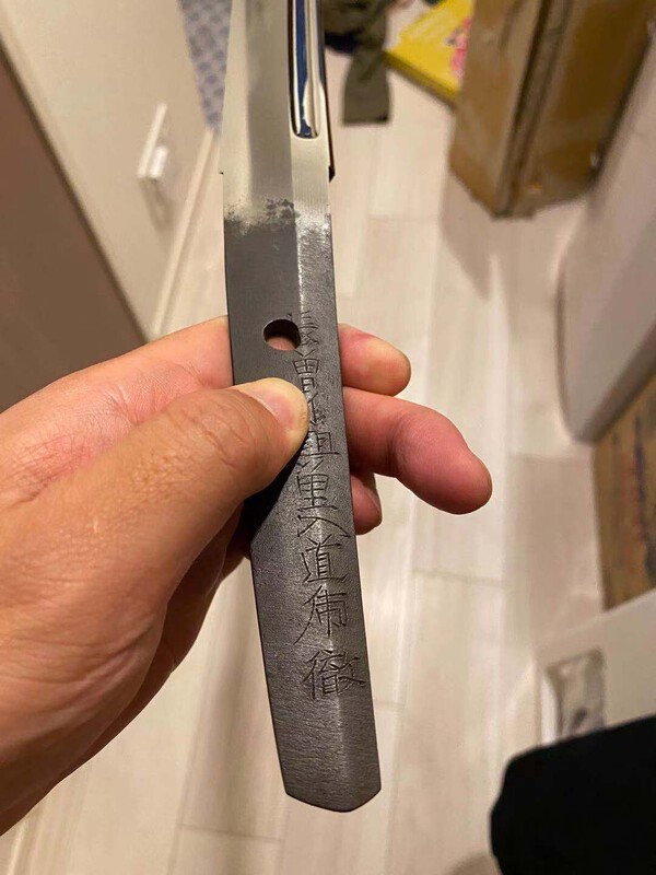

Please do tell .. is this Nagamichi?
It may very well be
"The blade is mine, not the signature.."
John
19 hours ago, Toryu2020 said:
Based on that one photo I would say yes - you really need to see many examples of Kotetsu and then the differences with all pretenders will be obvious...
