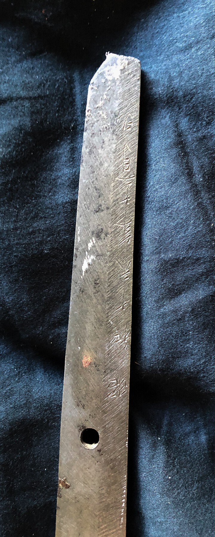

I now have another question. I have a massive feeling in my gut that this sword that came into my possession is a fake. I cannot see a sword makers make but it has writing down the side. I have taken a couple of photos. Any ideas in this group? You guys are bloody awesome so I trust ya’s

Just from the nakago, almost certainly a fake. However, a picture of the boshi (tip of the blade) would help confirm this. It looks to be one of those recently made Chinese replicas/fakes that are all over the market right now. The tang looks completely wrong and bedraggled, and the hamon looks grinded on.
Did it come with any fittings? What of the habaki: is there one? if there is, does it fit poorly?
