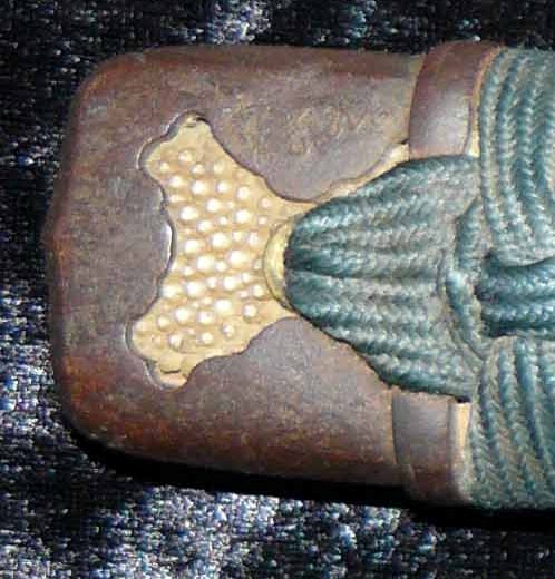

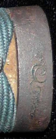

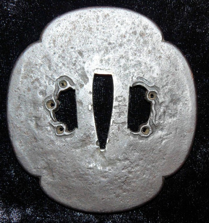

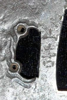

Hi all,
the fittings belongs to my unrestored shinshinto tachi. The pattern on one side of fuchi and kabuto-gane looks like a "snake or rope" form (dificoult to see on pix.), but on other side of fuchi (on picture) is a diferentstrange looking pattern which (gold or copper filler).
Massive iron tsuba looks old and have a signature. On both sides are thiny rays which goes from the center to the edge.
I kindly ask you for any opinion on fuchi and tsuba mei translation,
Regards,
Bojan

Although the tsuba is correctly oriented for a tachi it is somewhat difficult to read upside down (with respect to mei). In any case it seems to read Yamayoshi.
Share this post
Link to post
That's because it is not a tachi tsuba, but a katana tsuba Barry :-) It is a gimei Yamakichibei. The tsuba would be from the 1600's though I think, the fuchi and kashira do not match so I suspect this was all put together at some time by someone and may in fact not have much to do with the sword at all ???.
I would hazard a guess at the kashira being a late Higo piece, and the fuchi, well not sure, could be Shoami work.
Cheers
Rich

Hi,
thank you for answers. Fuchi and kashira have the same "snake style", open work is just on the other side of fuchi. Sword is 29 3/4 inches and it is possible to be a long katana with a tachi style fittings.

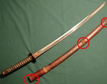

Hi,
old saya is covered with later ww2 leather, semegane, sayajiri are under a leather cover. In sayajiri area leather cover has little opening, so I can see the same style of fitting.

Hi,
it was wery clumsy to carry this 29 inch and heavy sword in to battle during ww2..? Any guess about the possible age of this simple handachi fittings, they looks older than showa era to me.

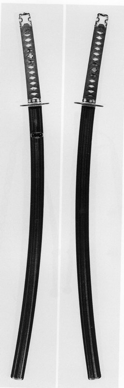

I don't know why people thing that a Handachi should be a Tachi without Obitori, and a Kurigata instead - and all Kanagu en suite. One has only to look at the book published by the Tokyo National Museum "Sword Mountings" (東京国立博物館 - 刀装篇) to see many example of Koshirae that don't fulfill those "requirements". There are even pics of swords with Handachi Tsuka and "regular" Saya, owned by the Tokugawa, no less! From a collector's point of view it might be desirable to have matching Kodôgu, but in the old days fittings were often chosen for their individual merit, not because they followed a common theme.

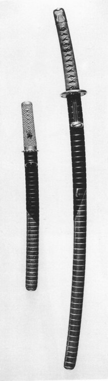

I don't think that there's a water-proof definition of "Handachi", and it isn't a topic the Japanese experts seem to loose sleep over. One person's Handachi is the other's Uchigatana. Rose is a rose ... Anyhow, if Tachi-esque fittings are used, I would apply the terminology for Tachi Kanagu.
Below are two scans of the style I mentioned above.
