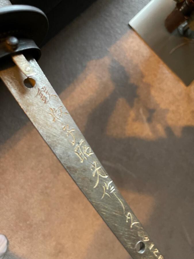

Bruce Pennington Posted July 26, 2021 Report Posted July 26, 2021 New addition to the Niigata smiths, a second Akimitsu, 1943, with タ1261 on the nakago, just 15 numbers apart from the other Akimitsu on file. Important addition, as well, to the blades marked with both stamped numbers and painted numbers. I'm checking with the owner, Leo2018 at THIS WEHRMACT-AWARDS THREAD to see if the fittings have any numbers. So far, I haven't found any of these with numbers on the fittings. But, to me, it doesn't make sense that the stamped numbers come from a fitting shop. There would be no known purpose to painting a different number on the same blade. But of course, I realize that I'm still just speculating. PAINTED & STAMPED NUMBERS Year Smith Stamped # Paint Notes 1942, Dec Akihisa Star Matsu577 “42” Quality RS fittings 1943 Akimitsu Star タ1261 “651” Quality RS fttings 1943, May Hiromasa Star 61; paint “60” date side “19” on mei side Low quality (Late?) RS, custom leather saya wrap 1944, Mar Munetoshi Star タ2353 star “678” Late RS possible re-fit, no 2nd ana 1944 Kanemitsu RJT (no star) 24 stamped “22” paint Mid-quality RS fittings; “1” on tsuba/seppa 1 Quote

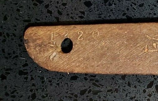

Kiipu Posted August 5, 2021 Report Posted August 5, 2021 On 4/12/2021 at 6:47 AM, Bruce Pennington said: Got my first hit: Sadaroku, 1943, Ta 1361. Could this be タ1369 instead of タ1361? Quote
Bruce Pennington Posted August 5, 2021 Report Posted August 5, 2021 33 minutes ago, Kiipu said: タ1369 Just checked it and I agree. I've changed my records. As for a new thread, I could go either way. I just cruised through the first page of this thread and can see that George's original intent was to discuss just what the title says. Yet, the discussion is in one way or another interlinked as we pursue the question "Are these fitting shop numbers or Army RJT numbers." The examples of blade numbers matching or not matching fittings, along with stamped numbered blades with painted numbers, are both important investigations into the overall question. I'm happy having these intertwined discussions on one thread. But if somebody wants to spin off the discussion of the kana/number stamping, I'm good with that too. 1 Quote

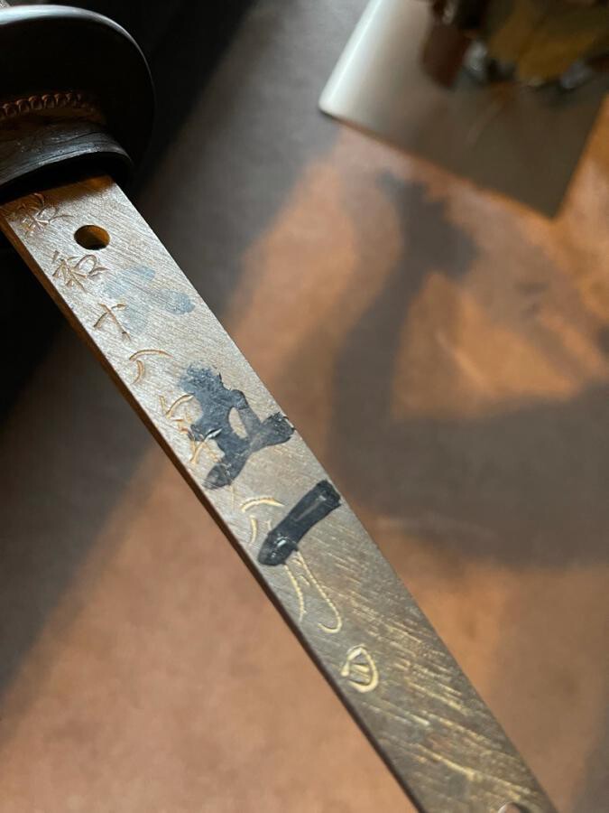

Kiipu Posted August 6, 2021 Report Posted August 6, 2021 On 7/25/2021 at 11:01 PM, Bruce Pennington said: New addition to the Niigata smiths, a second Akimitsu, 1943, with タ1261 on the nakago, just 15 numbers apart from the other Akimitsu on file. Do you a have a picture showing the entire reverse side of the nakago? Also, are there any markings on the nakago mune? And finally, I will need your shoe size and blood type! 1 Quote
Bruce Pennington Posted August 7, 2021 Report Posted August 7, 2021 19 hours ago, Kiipu said: entire reverse side These are the closest he posted. I can ask him for full shots if you like. And -- 12; A+ -- Ha! 1 Quote
Kiipu Posted August 7, 2021 Report Posted August 7, 2021 2 hours ago, Bruce Pennington said: These are the closest he posted. I can ask him for full shots if you like. Thanks Big Feet! I was missing some of the kanji characters for that side and the photograph above filled in the blanks. The only followup is to ask if there are any inspection marks on the nakago or nakago mune. So far, the answer seems to be no on the early star-stamped blades? Quote

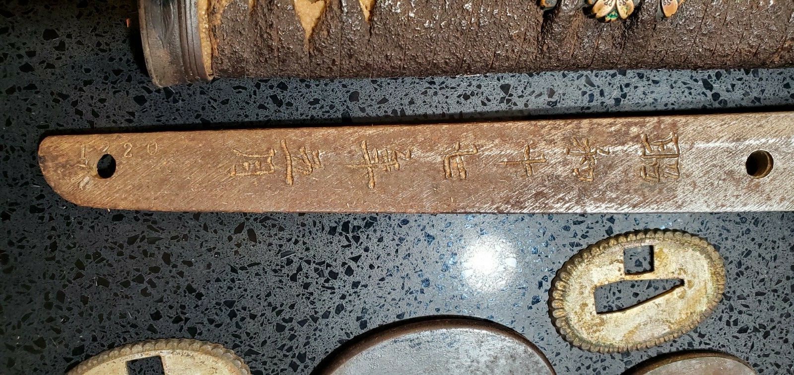

Kiipu Posted August 7, 2021 Report Posted August 7, 2021 On 6/12/2021 at 7:25 AM, Bruce Pennington said: On the other hand, a pre-RJT program blade by Munetoshi, July 1941, from Slough, stamped "106", so probably a fitter number but no fittings shown to find out. More likely an example of an early Type 100 serial number. Note that the serial number is stamped upside down compared to the early serial numbers that appear on star stamped blades. For an example of another one, see @Windy illustrations. Timeline Type 3 Gunto, Post #9 Quote
