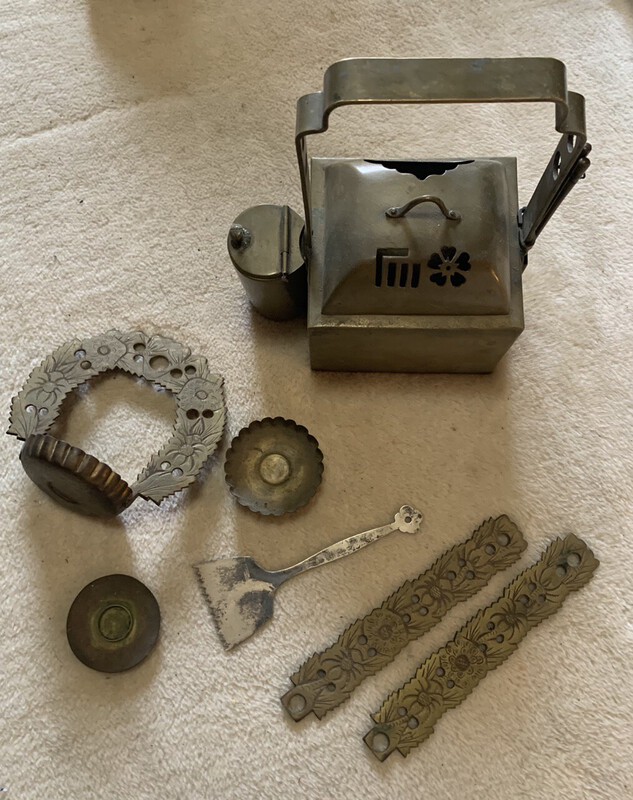

 A friend of mine is currently repairing/restoring one of his Teppo. He says that one of the problems is getting the right quality of brass/bronze. Most of the modern stuff is casting brass which does not work up well. I tell him to go for "gilding metal" which is made for working cold, but he doesn't like the colour.
Dave, I sacrificed a small tea ceremony ash rake for example, which was made of old Shinchū 真鍮 brass. It is now transformed into a decorative repair plate on my old pistol, the cherry blossom designs engraved and signed by an up-and-coming talented Nihonto (Tōshinbori) Hori-Shi blade carver. (The signature is in faint grass script where no one would notice it. My secret!)
Well, here is one ‘rake’ that I have not (yet) sacrificed. I think you will agree that it is old, made of Shinchū, and offers some decent surface to work with.
The second photo shows brass bits which I gathered from around the house, including parts of Buddhist temple lanterns. (The second rake is silver though.)
You could say it is sacrilege, but to me the pistol had higher priority, i.e. was more worth saving. One of the weaknesses of any Hinawaju is the top of the butt, right behind the barrel. Cracks develop from the constant kick and hammer backwards and eventually a triangular chunk can fly off, so you will often see a brass cover there. Rather than straight plain, some added decoration seems to balance things out nicely. Is it a repair, or is it an original feature? In most cases we will never know.
