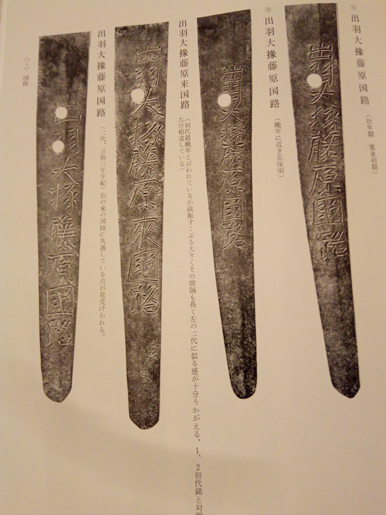

The wear on horimono is very natural, so its probably old enough. Its location is a bit awkward, as it barely fits above the hamon, which detracts a lot from its visual impact, but its actually quite detailed. Sugata can be consistent with the early Edo, the work is most likely shinto-style also. This smith's examples unfortunately seldom have some kantei quality which can be used for definitive judgement, the work varies and can have rough hada, or tight itame etc. etc.
This could be brought to shinsa as is to verify the signature. Here is an authentic signature for comparison. There are significant differences, but I don't know if they are enough to be certain its gimei.
Very personal opinion - gimei, but don't hold me to it.
I think that there's some quality about the horimono. It seems like a lot of effort to go to to put a good carving on a mumei blade (assuming the signature is false and added later) as this is most likely something done to order rather than for an off-the-shelf sword. Likewise it's a lot of effort to go to to pimp a sword to pass off as shoshin if they were done together. As stated above, the wear isn't out of line with the age of the blade or with the carving on the other side so, for me, worth further investigation.
Ähm, It  has  not the  shape  of the  period  of Dewa Daijo, the  hori is wrong. yasurime  does not  match. Gimei. Hada  and  hamon can  not be juged with  these  pictures.
