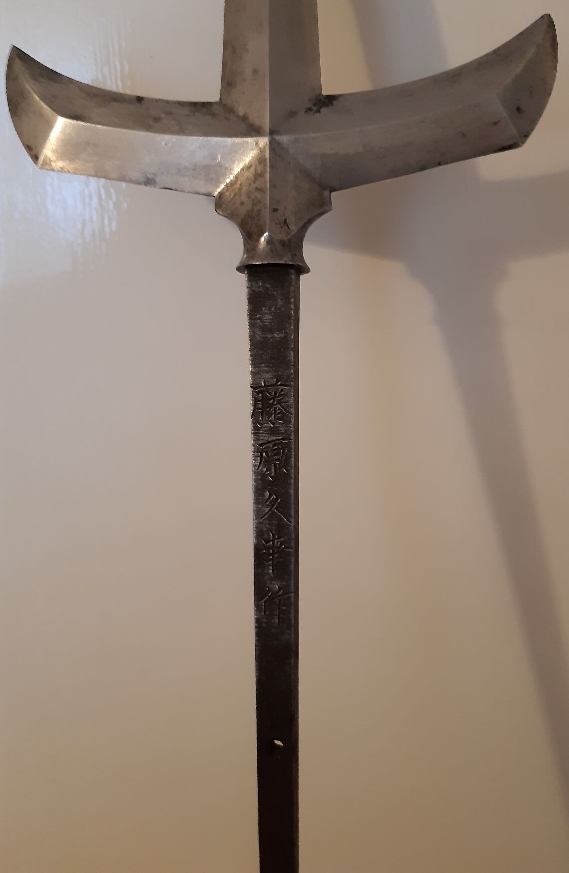

Dear Ray.
I have the other problem, jumonji and cover but no pole!  I have been on the look out for one for ages and finally found it, badly corroded nakago unfortunately so not yet able to decipher the mei.  Really like them.  Odd, isn't it, that tanto are highly valued because they are harder to forge and heat treat.  The skills involved in forging and treating a jumonji are amazing.  Of course the one that Axel posted is a delight.
