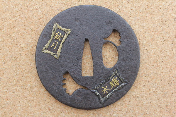

Bob M. Posted March 1, 2021 Author Report Share Posted March 1, 2021 Continuing the theme of the first tsuba, another iron and gingko example - this also has applied Kanji signs - possibly for teahouses ? Unsigned , 7.3 x 7.3 cm , not submitted for shinsa. 2 Quote Link to comment Share on other sites More sharing options...

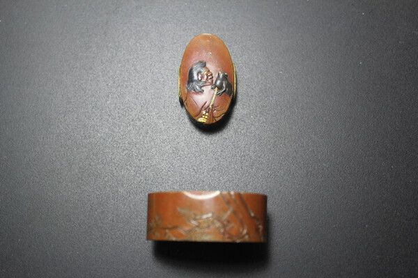

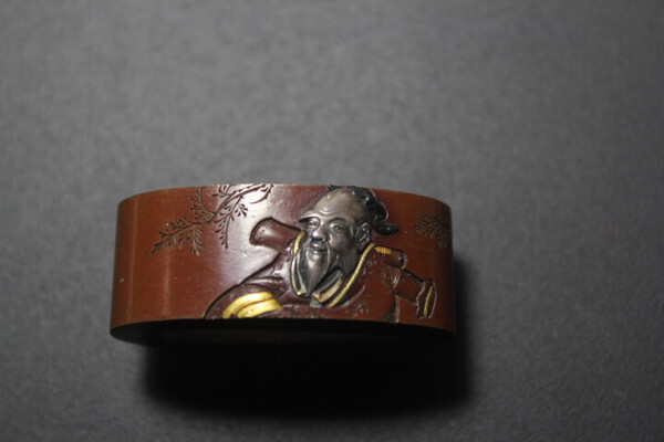

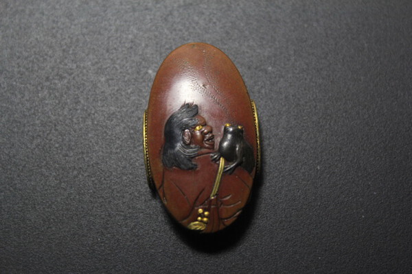

Bob M. Posted March 10, 2021 Author Report Share Posted March 10, 2021 No. 8b Fuchi Kashira signed Ishiguro Masayoshi featuring Gama-sennin and his toad together with another sage , Tekkai ? before having to take the beggars body ? Very fine and detailed work - very difficult to photo without a full set-up. Any ideas about the second sage ? 3 Quote Link to comment Share on other sites More sharing options...

Tanto54 Posted March 11, 2021 Report Share Posted March 11, 2021 Dear Bob, Your No. 8b (Masayoshi Fuchigashira) was really a tough one. Tekka Sennin was a good guess because if Gama Sennin is combined with another Sennin on tosogu, 99.9% of the time it is Tekka Sennin. In this very rare case, the other Sennin on your fuchi is Chokaro (sometimes Chokwaro) Sennin. What made it so difficult is that Chokaro Sennin is almost always shown with his main attribute - a white horse/mule coming out of a gourd. In the case of your fuchigashira, Chokaro Sennin has a yuku or fish drum over his shoulder. A fish drum is a musical instrument formed from a bamboo tube with one end covered by snakeskin (see the snakeskin cover held on by some gold cord at the bottom right of the photo of your fuchi below?). Chokaro Sennin is based on the Chinese Immortal Zhang Guo Lao, and in classical Chinese Art, Zhang Guo Lao (Chokaro Sennin) is usually shown with a yuku (fish drum) even though he can also conjure a horse/mule from a gourd. One of the disciplines of elite Samurai was the study of classic Chinese Art and Literature, so your fuchigashira is a Samurai "flexing" that knowledge. Is there anything on the other side of the fuchi? Woodcut of Zhang Guo Lao (Chokaro Sennin): 7 1 Quote Link to comment Share on other sites More sharing options...
Brian Posted March 11, 2021 Report Share Posted March 11, 2021 George, you are a master at this 1 Quote Link to comment Share on other sites More sharing options...
Bob M. Posted March 11, 2021 Author Report Share Posted March 11, 2021 Hi George , Thanks for your input , once again. Other side of the Masayoshi fuchi as requested 1 Quote Link to comment Share on other sites More sharing options...
