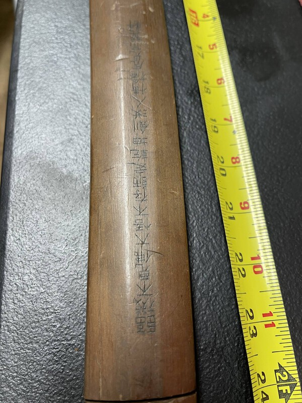

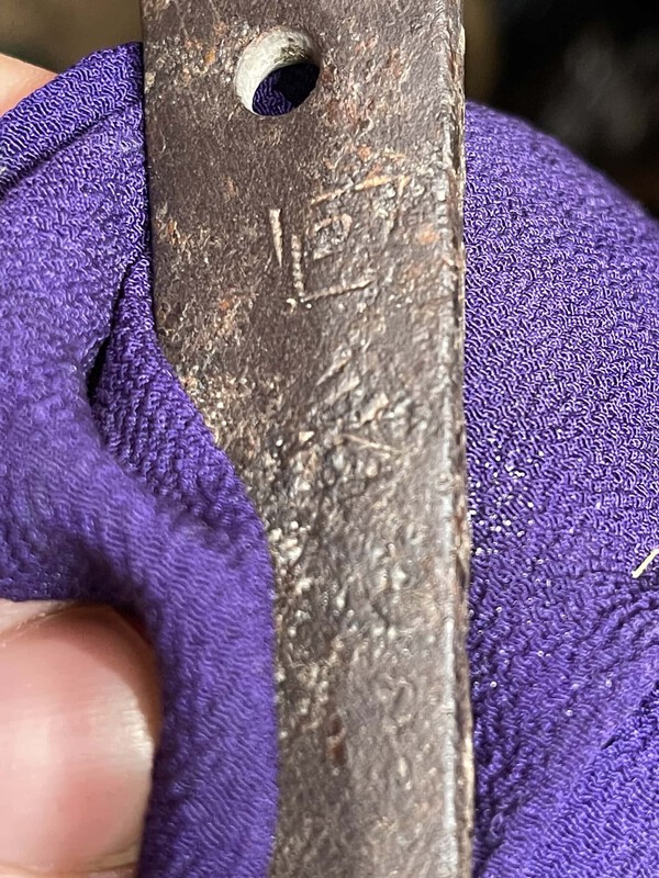

Name on the sword is 包 (kane-something).
The writing on the scabbard looks like a buddhist incantation, but nothing pops up when I do an internet search.
Pictures of the full sword itself are usually better than close-ups of the tang area.

臨機不見佛 大悟不存師 定乾坤劍沒人情 擒虎兕機忘聖解
(From Book of Equanimity) :?:
Facing the situation, you don't see Buddha; great enlightenment doesn't keep a teacher.
The sword that settles heaven and earth obliterates human sentiments, the ability to capture tigers and rhinos forgets holy understanding.
Ref. [BOS] Case 53: I raise my glass of dregs to HuangBo : zen (reddit.com)
Ref. Book of Equanimity - Wikipedia
  • Thanks 2

Could you please explain a little more about Moriyama San?
I spoke to one historian who said it is likley from Civil War era 1400-1650. Does that make sense?
thank you
Share this post
Link to post
Moriyama-san is the guy who provided you with the translation of the saya in post #4.
Japan's internal fighting ended more-or-less by 1615. Your sword could be from that era - the Muromachi era. The number of mekugi-ana isn't much of a clue. Better to look at the shape of the sword, length, tip, and activities in the hamon. From what I can see in the picture, I wouldn't guess Muromachi. Probably post 1600, but the angle doesn't give us much to go on. At 21 inches (measured tip to the notch where the tang starts) it is wakizashi size.

Sorry, I do not know the correct orientation.  Here is another persons opinion.  It's pity that the second kanji is not as clear as first on (包). Actually looking at it, I think it could be 俊 (toshi).
Share this post
Link to post
Joe,
TOSHI is just one half of the smith's name, so you will not find information about it.
If you are interested in the writing, you may look under NIHONTO INFO (uppermost menu line on this page), then RESEARCH, and then NIHONTO KANJI. It is a good way to learn to read MEI.
Share this post
Link to post
Is it possible that there are only 2 Kanji letters?  Or should there be more than that...
Share this post
Link to post
Joe,
usually there are only two KANJI symbols to form a first name or a family name, but there are exceptions. Often, a MEI consists of three KANJI, the last one being SAKU (= made by).
