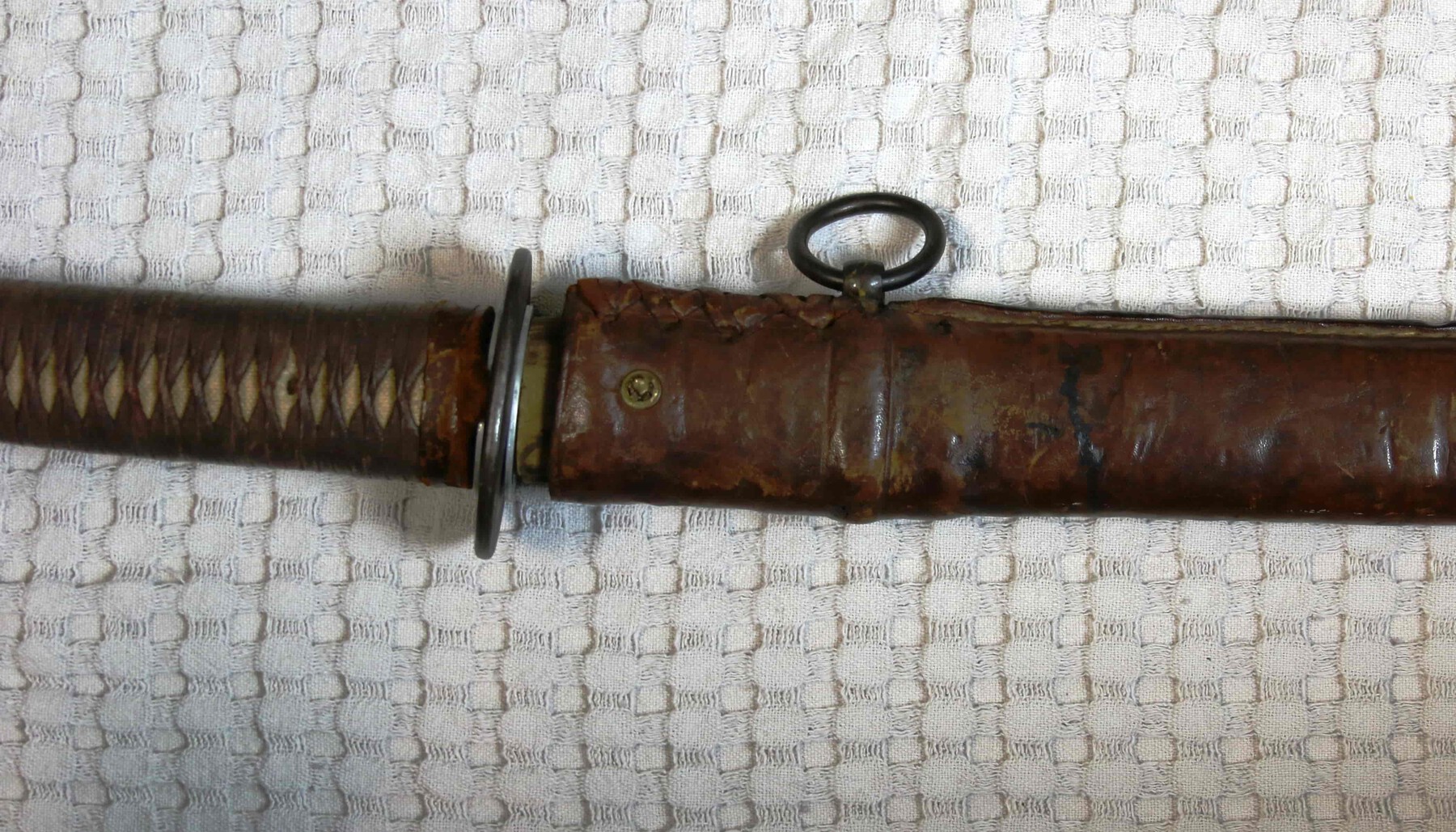

Guys, I`m trying to get information on this sword. Since I`m a newcomer to Japanese swords, I`d appreciate your opinion on it, what era it might be and if you could point out flaws.
Thanks

Dale could be right.  Is this yours? or pictures from a seller?  I'd really like to see clearer pics of the tsuka (handle), close-up of the blade tip, and clear close-ups of the nakago (tang).  It has many characteristics of a late-war island-made sword (like the canvas same').  But the gold stamp yells "Chinese fake".  Maybe one of the translators can come in on that stamp?
The island-made swords don't usually come with the round, plate, tsuba either.
At best, an unknown; at worst a fake.

Bruce, thanks a lot for your info. I`ve attached some new pics of higher quality. If it`s still not informative, I`ll be able to provide better ones later.IMG_1800.thumb.JPG.a0ca8f5927c6a80112bc84ead2a2ef05.JPG

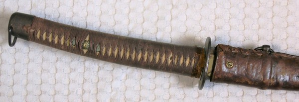

I've enhanced the last 2 shots.  I've short on time today, but I'd like to continue this later.  The kabutogane looks legit late-war and the nakago is made much better than what we normally see in fakes.  But I's still bothered by that "Made by" stamp.
How is the fit with the tsuka (handle) and tsuba/seppa (handguard and spacers) set?  Is it tight or loose?
Would still like a closeup of the blade tip.

I dont see modern.
I know forced aged and this isn't.
Nakago is nothing like fake chinese from that era. Shots of kissaki please. Also any activity in the blade.

42 minutes ago, Bruce Pennington said:
Chinese fakes don't have mon on the menugi.
I was going to ask for clear shot of the menuki. Looks like sun or something ive seen before. Better shot will till

I can't find that mon (though I'm not the best at finding them!), but it reminds me of the early Army sun-ray pattern found on a couple of custom kyu, recently.  Nick Komiya said the pattern was army, with a large "org" in the center.  Smaller orb was for police.
Discussed HERE on Warrelics.
The Chrysanthemum, the Rising Sun and the Star

1 hour ago, Stephen said:
what i came up wit
Still, yours may be heading more in the right direction.  The number of rays, for Japanese police badges, in Dawson's book, are 5, or 8, or, 16 (one odd one with 6).  This one seems to have 9.  I don't know if the Manchuko govt used police.  If so, could this be a Manchukou?

Inna, still with us?  Could we get a clear, close-up of that emblem on the menugi I had enlarged in post #12?  Also a good clear close-up of the blade tip and a section of the blade showing the temper line?

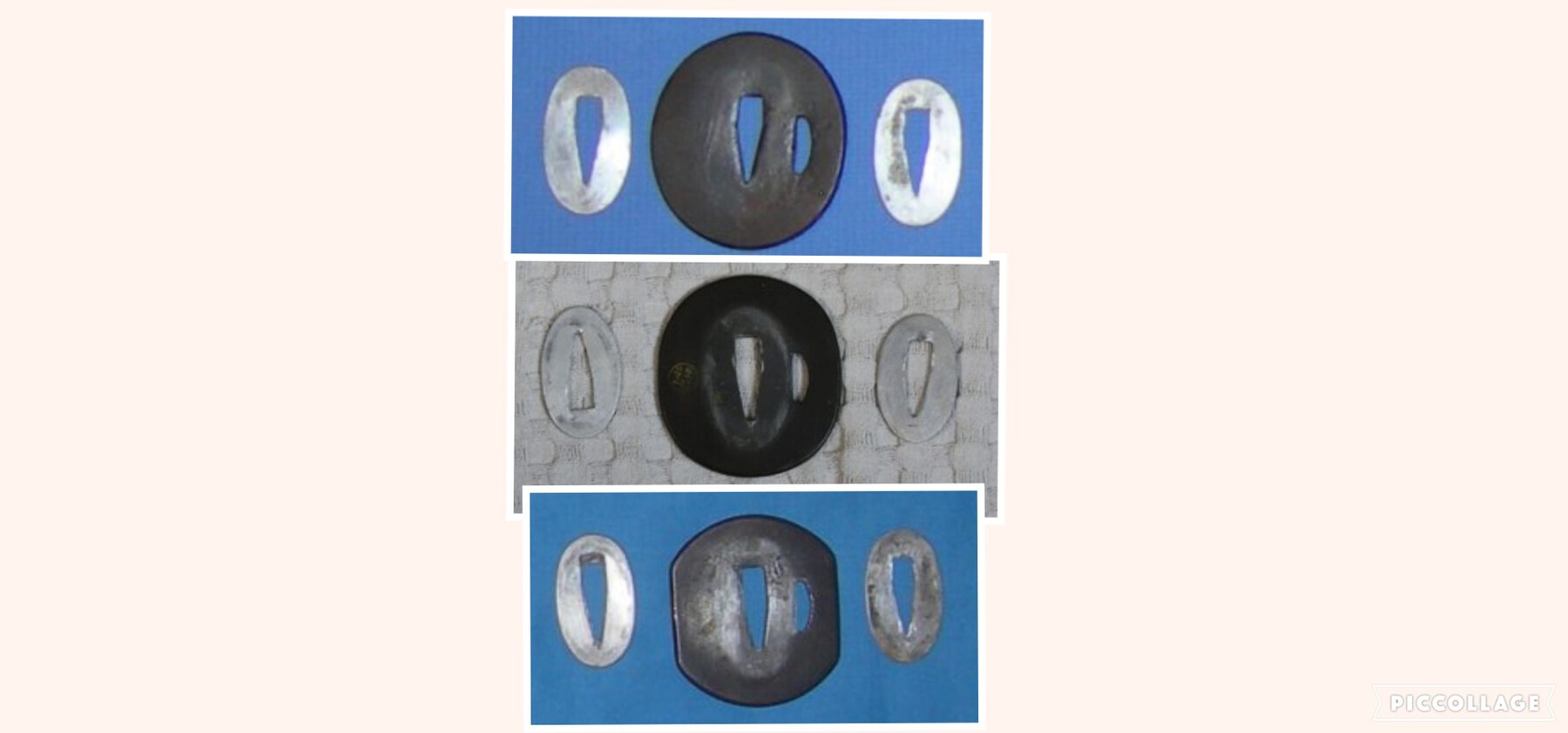

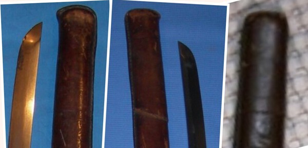

Are you saying they are modern fakes?  I'm still open to that, but we now have 3, and I'm sure their not just the same one re-sold and posted 3 times, gunto that are clearly from the same shop.  Close-ups seem to show legitimate age and wear.  The "dremel" work on the menuki are identical, not what you'd expect for a Bubba job.
Of course, there are known faker shops making near-carbon copies of their horrible fakes, so I know what I've just said doesn't rule that out.  I just think the age and wear look legit.
