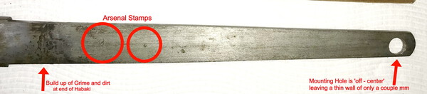

Here's a photo of the tang on one of mine to compare with the original swords tang.
Identical except for the repair on the topic piece.
I am experienced with metal work/welding etc and in my opinion it appears to have been brazed, not welded, as can be seen by the slag and residues left over from being coated in flux.
I would not think that this is not a repair done 'in period' ... remember war is raging, swords are in short supply and who's going to look under there anyway?
I think this could also be true 'post war' but not my first choice.  The tang phot was the smallest in size and would have been nicer if it wasn't.
An 'in hand inspection' would be ideal and help date the repair better.
To Vayo, you are correct in saying any welding/ heat applied would render the blade in need of re-tempering, however, it is possible it do repairs such as this.
The key here is the location... the extreme tip of the tang, a wrapped wet cloth would be enough, this is evidenced by the limited range shown in the heat 'rainbow'
