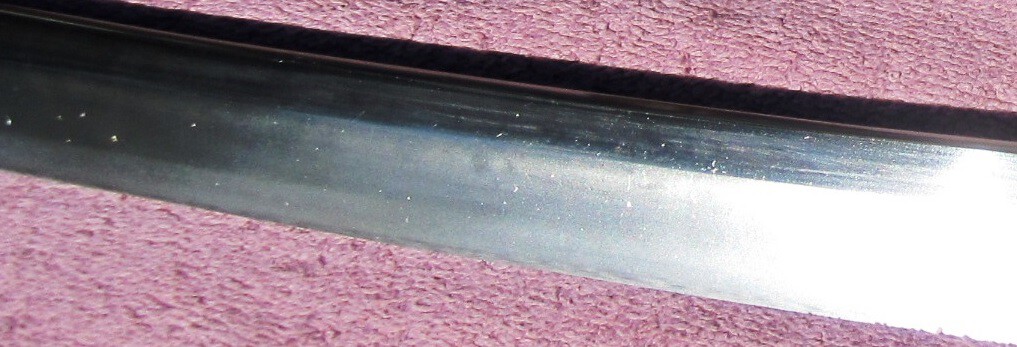

Dunno whether modern smiths have rediscovered "true utsuri", perhaps Yoshiharu rediscovered "fake utsuri"?  Whatever, this example is possibly interesting in that its midare form wouldn't seem to correspond to the blade's muji hada, also it's nearly as vivid as the (admittedly none-too-bright) suguha hamon.  Okay, just another stray comment from the bargain basement, I'll be quiet now.  ;)
