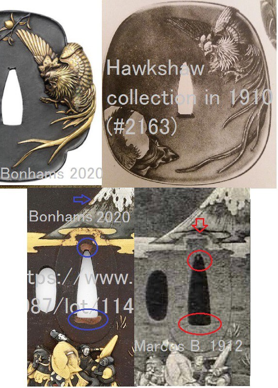

Yasaka Azuma Posted December 31, 2020 Report Share Posted December 31, 2020 Dale. In Bruno's post, I was amazed to see the design recorded in 1910 carried over to modern replicas. The archive you found is also surprising, the two are different individuals from the same produce. 1 Quote Link to comment Share on other sites More sharing options...
Spartancrest Posted December 31, 2020 Report Share Posted December 31, 2020 Yas you are right, I thought the old grainy picture was not very clear with some ink and smudge marks, but the sekigane are not there in the old picture. That means there are likely many more of these out there, like so many others. My goodness they are good copies though. 2 Quote Link to comment Share on other sites More sharing options...

BjornLundin Posted February 11 Report Share Posted February 11 Hi, I think the brassy colors are probably artifacts from taking the photo, and some shine may be from my hand. I will see if I can take a few more. If my heart can take it, I will also try to swab a little of non-acid paint remover on a spot of the tsuba. I will update later. After placing the tsubas found online next to each other and comparing to mine, I am pretty convinced that the one sold at Christies is the one that I have. Bonhams has quite good quality of there photos, I give them 5 stars. For the nagako-ana, I compare now the three tsubas I have found. I removed my photo, since it is the same as Christies. The left one is Bonhams, then mine (Christies), and to the right is the one found on Pinterest. I am a bit on the side that if cast the nagako was cut out later. < Quote Link to comment Share on other sites More sharing options...
BjornLundin Posted February 11 Report Share Posted February 11 8 minutes ago, Spartancrest said: There appears to be several colour variations with the rooster design, I don't see inlays but rather overlay. The base metal underneath is very difficult to pin down - not iron, not shakudo? The tsuba to the left is the one I found on Pinterest, the middle and the right is from Bonhams. 1 Quote Link to comment Share on other sites More sharing options...
Spartancrest Posted February 11 Report Share Posted February 11 One on Christies March 29, 2005 https://www.invaluab...6a16609d9c37c0b073d8 signed jumyo oite Koishigawa Hisanori saku The shakudo migakiji mokkogata tsuba, decorated with a rooster spreading its wings by a tree in iroe takazogan 3 1/8in. (7.9cm.) long. Wood storage box inscribed by Homma Junji (Kunzan) It is not the same guard as Christies 12 May 2010 https://www.christie...m/en/lot/lot-5316579 Mokko-Shaped Shinchu Tsuba. Signed Koishikawa (ni) oite Hisanori kore (wo) tsukuru, Meiji Period (late 19th century) Inlaid in shinchu takazogan with a cockerel, the reverse with a peach tree 7.8cm. high [The minute size difference is likely measurement inaccuracy.] Quote Link to comment Share on other sites More sharing options...
BjornLundin Posted February 11 Report Share Posted February 11 The internet is a treasure cove of information. 47 minutes ago, Spartancrest said: One on Christies March 29, 2005 https://www.invaluab...6a16609d9c37c0b073d8 signed jumyo oite Koishigawa Hisanori saku The shakudo migakiji mokkogata tsuba, decorated with a rooster spreading its wings by a tree in iroe takazogan 3 1/8in. (7.9cm.) long. Wood storage box inscribed by Homma Junji (Kunzan) It is not the same guard as Christies 12 May 2010 https://www.christie...m/en/lot/lot-5316579 Mokko-Shaped Shinchu Tsuba. Signed Koishikawa (ni) oite Hisanori kore (wo) tsukuru, Meiji Period (late 19th century) Inlaid in shinchu takazogan with a cockerel, the reverse with a peach tree 7.8cm. high [The minute size difference is likely measurement inaccuracy.] I believe that the Christie 2005 may be the same as Bonhams (left). Christies photo (to the right) quality can be discussed. Base metal is unknown to me... < Quote Link to comment Share on other sites More sharing options...

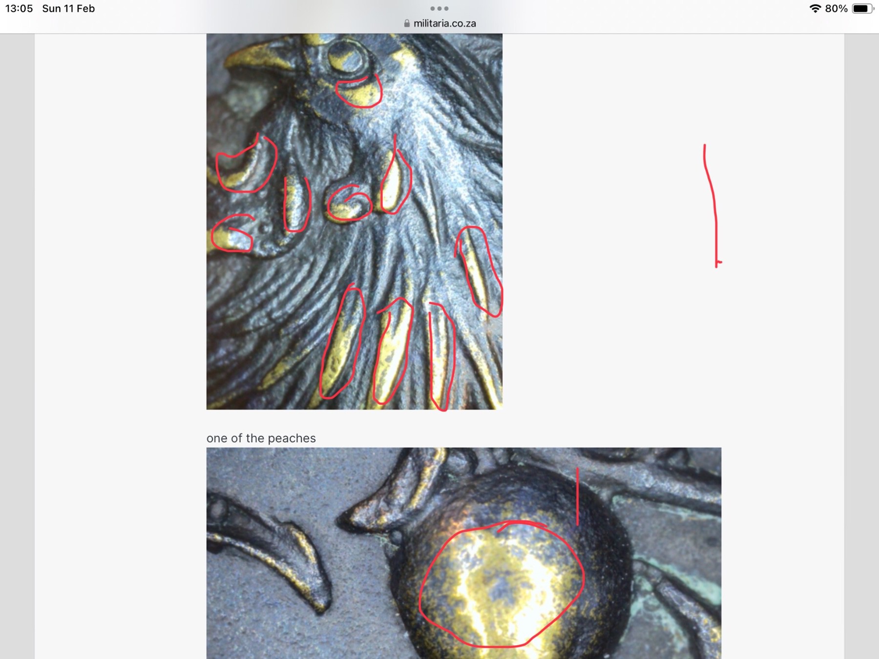

Matsunoki Posted February 11 Report Share Posted February 11 Bjorn Im still puzzled that you don’t see the areas that look worn. I’ve done a screenshot of what the peach and the feathers look like on my iPad. The”brass” colour is what I refer to……but it doesn’t look like that when you have it in your hand? Quote Link to comment Share on other sites More sharing options...

Matsunoki Posted February 11 Report Share Posted February 11 Bjorn i am beginning to question my sanity🙂🙂 in your new photo of the peach I still clearly see two colours…..the grey and then a brass colour on high spots. I still see it on many other high points. @Spartancrest…. can you see what I mean? Or have I really gone crazy. I outline in red what I am seeing in this image……. 1 Quote Link to comment Share on other sites More sharing options...

Matsunoki Posted February 11 Report Share Posted February 11 10 minutes ago, BjornLundin said: Ah, so sorry. It was the gold (brass) high lights that you pointed out. Those are probably painted? on. No Bjorn. I’m thinking the grey colour has been applied over the brass and the brass now is showing through now the grey has worn off. I think the brass colour is the actual metal it’s made from. 1 Quote Link to comment Share on other sites More sharing options...

Steves87 Posted February 12 Report Share Posted February 12 10 hours ago, Matsunoki said: Bjorn i am beginning to question my sanity🙂🙂 in your new photo of the peach I still clearly see two colours…..the grey and then a brass colour on high spots. I still see it on many other high points. @Spartancrest…. can you see what I mean? Or have I really gone crazy. I outline in red what I am seeing in this image……. Fwiw, I agree with you. That particular colour on the high points of the plate/details, definitely suggests wear. In the case of this guard, I think it has worked in its favour that the base colour has come through in those spots as it does look somewhat intentional. 1 1 Quote Link to comment Share on other sites More sharing options...
