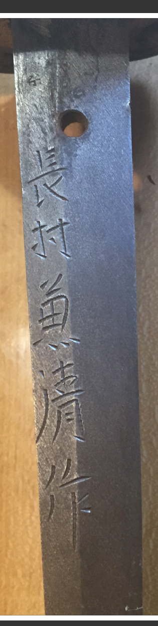

Hello,
i found a sword in type 98 Koshirae at an auction. Unfortunately the translation of the Mei is missing. Can someone help me please.
Thanks.

First shot Kanehide Saku
I must look into the books for the second kanji. I would say one of the showa smiths not from the gendaito side.

Dated July 1943 with a faintly struck, double struck, Nagoya stamp.  So, non-traditionally made.
I was trying to see the tiny stamp at the top, but could not quite make it out. Correct me if I'm wrong, but is this the original post a tachi-mei, opposite of the oshigata below?
Naga
Mura
Kane
Kiyo
Saku

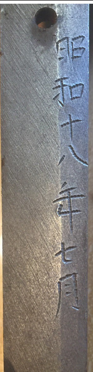

On 10/21/2020 at 2:20 PM, Itomagoi said:
Sho
Wa
Ju
Hachi
Nen
Shichi
Gatsu
Showa = 1926
Ju = 10
Hachi = 8
Nen = Year
Shichi = 7
gatsu = Month
18th year, 7th month of Showa is July 1943

52 minutes ago, Itomagoi said:
Thanks for the very good translation.
You are welcome!
I hope it is a beautiful blade. You may have a hand made blade. Do not confuse with traditional tamahagane, hand-forged and water tempered blade though. Your blade may be hand-worked mill steel that was water or oil quenched. Feel free to post more pics of the blade and mounts.
