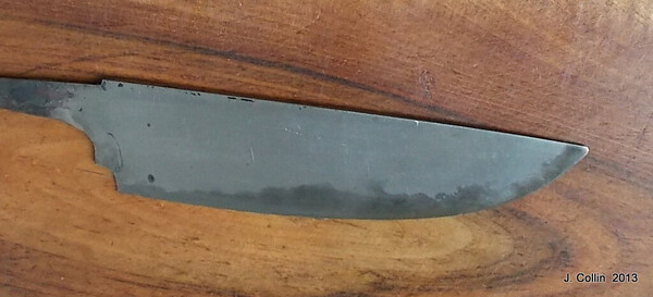

To come back to James' question, it can be said that there is no simple answer, but construction is always related to application - 'structure follows function'.  On the other hand it is safe to say that historically mono-material blades came first, and were later improved by the addition of steel into the weapon or tool. This is backed by many samples from Japan, but also from other iron-using cultures all over the world. The simplest form is the steel edge welded into a tool with an iron body (WARIHA-TETSU or SAN-MAI) as we see it still today in Japanese axes and knives.
