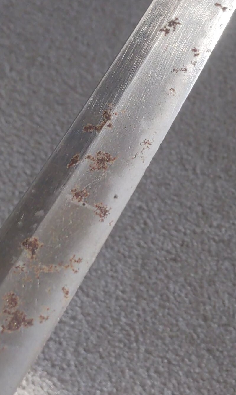

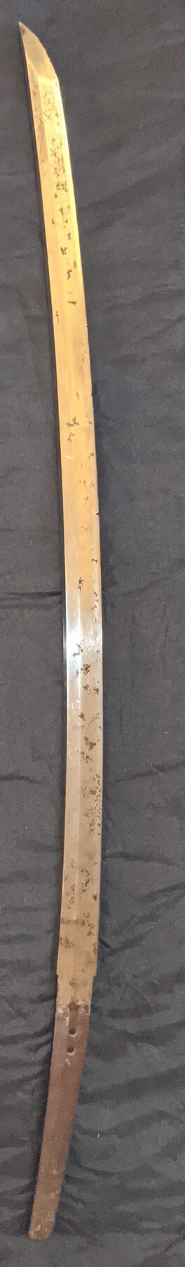

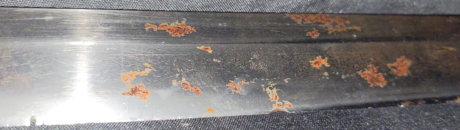

I'm interested in figuring out more about this sword. The blade has some rust and damage. It's a bit on the heavy side in my opinion. Doesn't look too old, but I am wanting a second opinion. I'm sure the blade is water tempered, and the hamon has some character. I think it is a gendaito, maybe a shin-shinto, but I don't know for certain. Thanks in advance.1419207102_IMG_20200919_1300403.thumb.jpg.b7c90bfb2ff62cd7268f8bf620ecd698.jpg306342609_IMG_20200919_1302393.thumb.jpg.eb6d7328a0233466a6f42580db8be9e1.jpg
Share this post
Link to post
There is hada, but I'm having a hard time getting in on camera. I'm fairly sure it is not a showato. I'm not seeing any signs of a remove signature or stamp. The blade was in gunto mounts that are in poor shape. Saya looks like it might have had two ashi at one point, but only one is left. The blade from mune machi to the kissaki is just under 70cm.

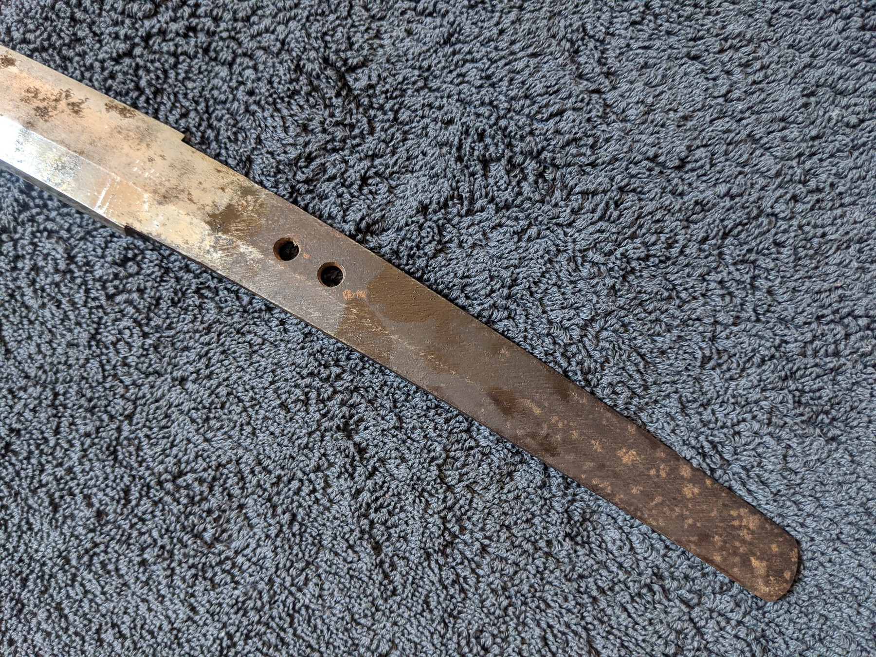

The blade definitely feels like an old "beater" or kazu uchi mono. The nakago seems to me to be ubu (though I wouldn't know), the yakidashi seems to be in a normal spot. I only received the blade yesterday, and I have even more reason to believe that it is not a wwii blade. The saya appears to be at least an inch or two too short. I have no clue how it was originally mounted. The handle it came with doesn't seem to match either.

There is no ubuha/ricasso. It has a very keen edge at the ha-machi

The hamon seems to be mostly toran, midare, and gunome. There might be a little bit of notare in the Monouchi area. It has a robust Iori-mune.

I'm not seeing anything like toran. Looks more like a ko midare based on Suguba from your last few shots.
Toran would cover a lot more blade.
Can you show where you think you see predominantly Toran?

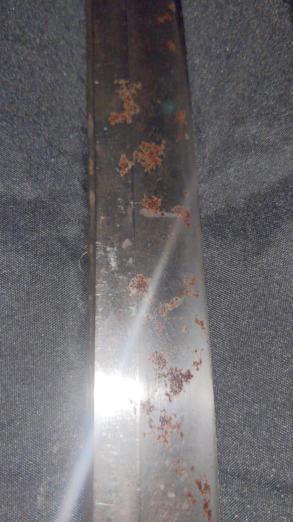

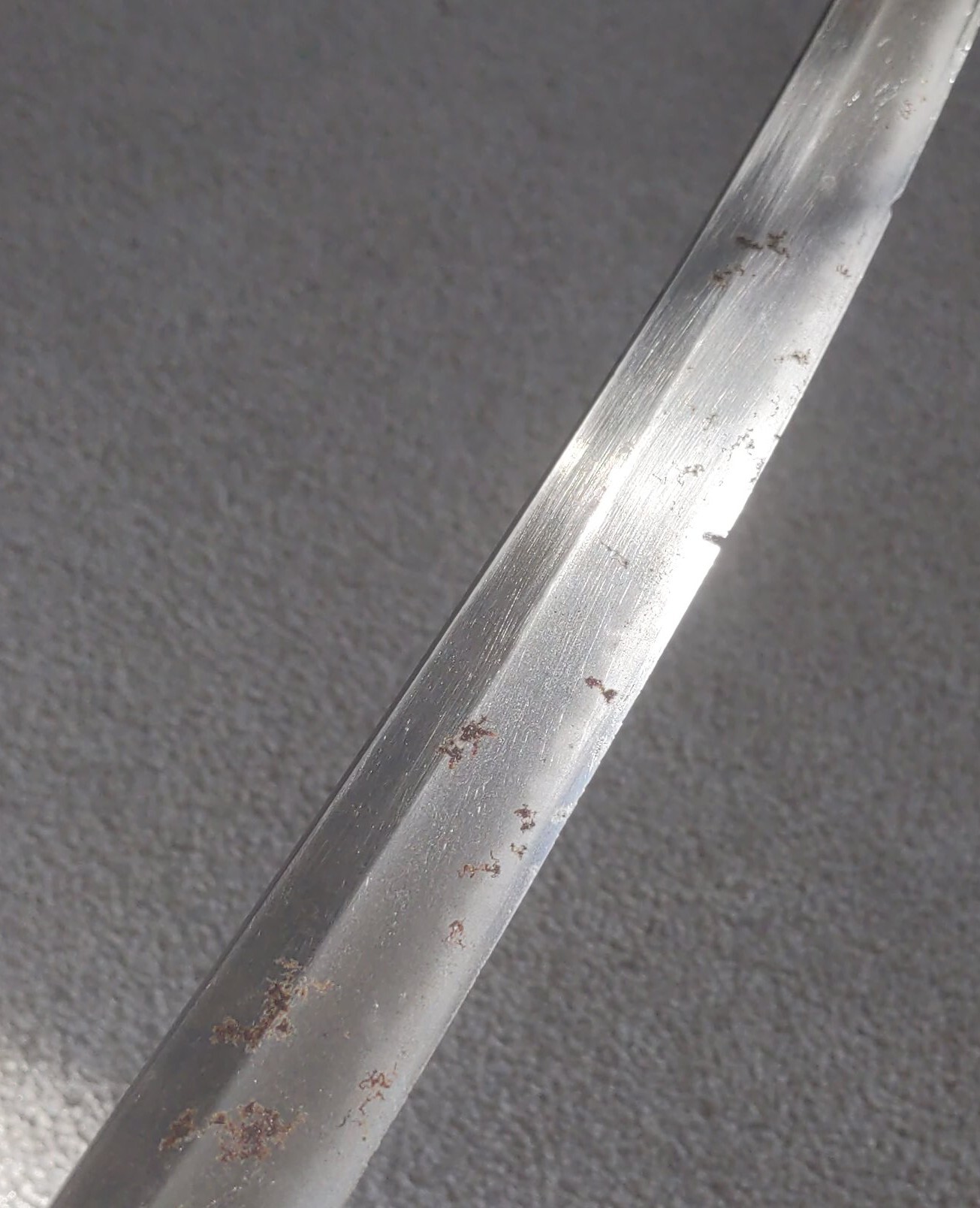

Far away, it is hard to see the details in the hamon. In person, none of it that I can see looks like suguha969341840_IMG_20200920_0313404.jpg.a38e2ee25244aafeba3544b595a798c7.jpg1940210271_IMG_20200920_0815432.thumb.jpg.e155157ba229c9da89507f9bae44be54.jpg
Share this post
Link to post

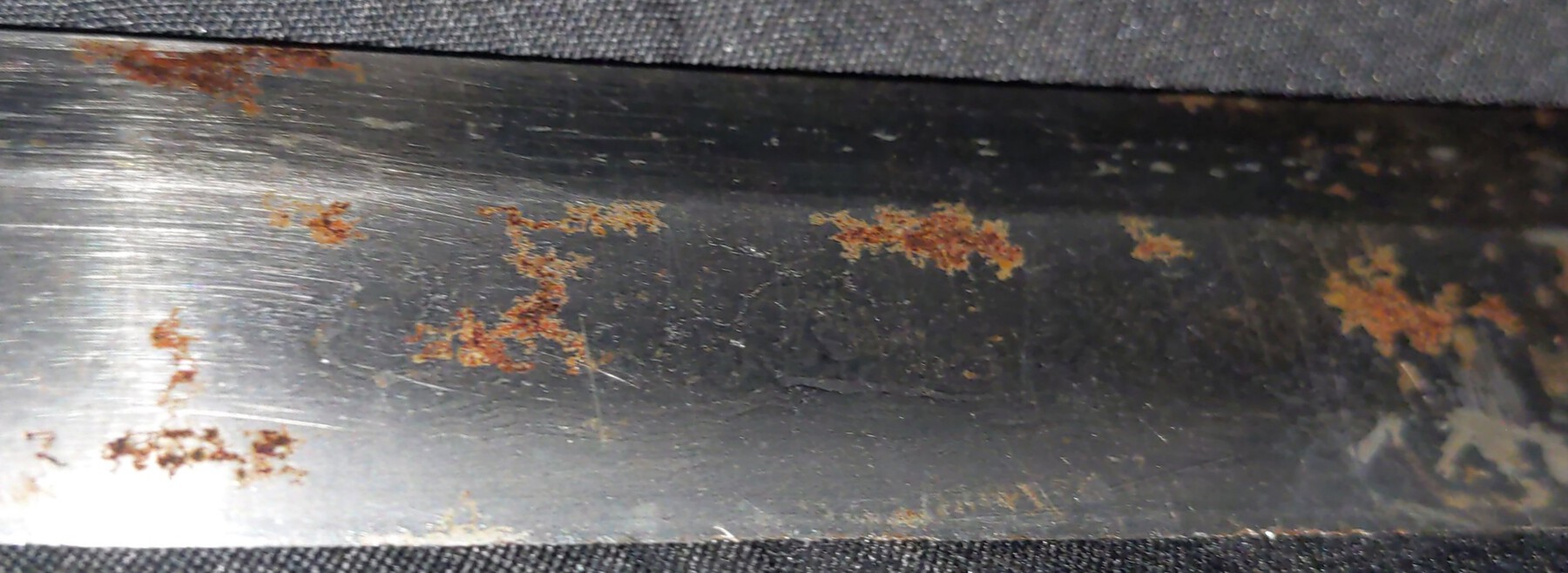

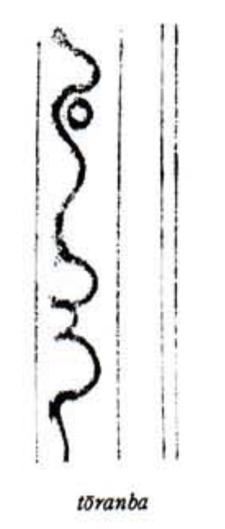

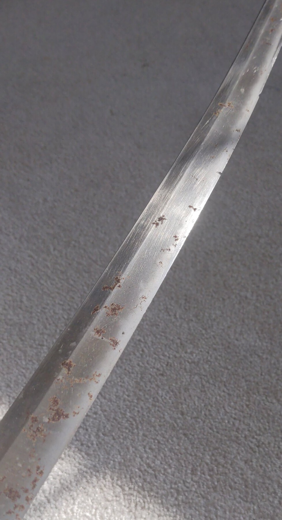

I'm not sure exactly what to call the hamon other than midare, it has shape similar to the diagrams, and tobi-yaki. The hamon is not very wide on most of the blade, so toran might not be the right word1429138166_IMG_20200920_0822074.thumb.jpg.17ce154cbc3efde0f5b5823ea4a53890.jpg778811005_IMG_20200920_0822073.thumb.jpg.7d34135442ed89e08876454ba3d709ff.jpg
IMG_20200920_025720~3.jpg1225646958_IMG_20200920_0840353.thumb.jpg.9cfb4b2d6e4d4eb9aa8494cc55353e90.jpg489815009_IMG_20200920_084008_12.thumb.jpg.90555889e7cebeae2536104eab24c4ac.jpg1029211877_IMG_20200920_0840342.thumb.jpg.ef407c26527658d9e1425669246a8e87.jpg569331291_IMG_20200920_0840353.thumb.jpg.94cfbb25443d129ea5399bb11540bbce.jpg924600031_IMG_20200920_0840352.thumb.jpg.bfd2af0aafebfaa8f8c77895cfdac8ff.jpg
Share this post
Link to post
I see a lot of the parts of the hamon look a lot like this. You may be able to see it a little in the photos.
What's odd to me is that the blade looks old, but the nakago shape and rust color is more indicative of a newer sword. I can't see the boshi or yakidashi very well, but both seem wavy, which of I remember would also be more typical in an older sword. I'm open to any opinions.

Gunome midare with some choji
The rust should be stabilised. Have seen people here recommending using horn to scrape it away but repeated treatment with choji oil should suffice. This here is one of these rare cases where the application of uchiko will actually improve things as uchiko is a mild enough abrasive to retain the hamon etc but remove rust.

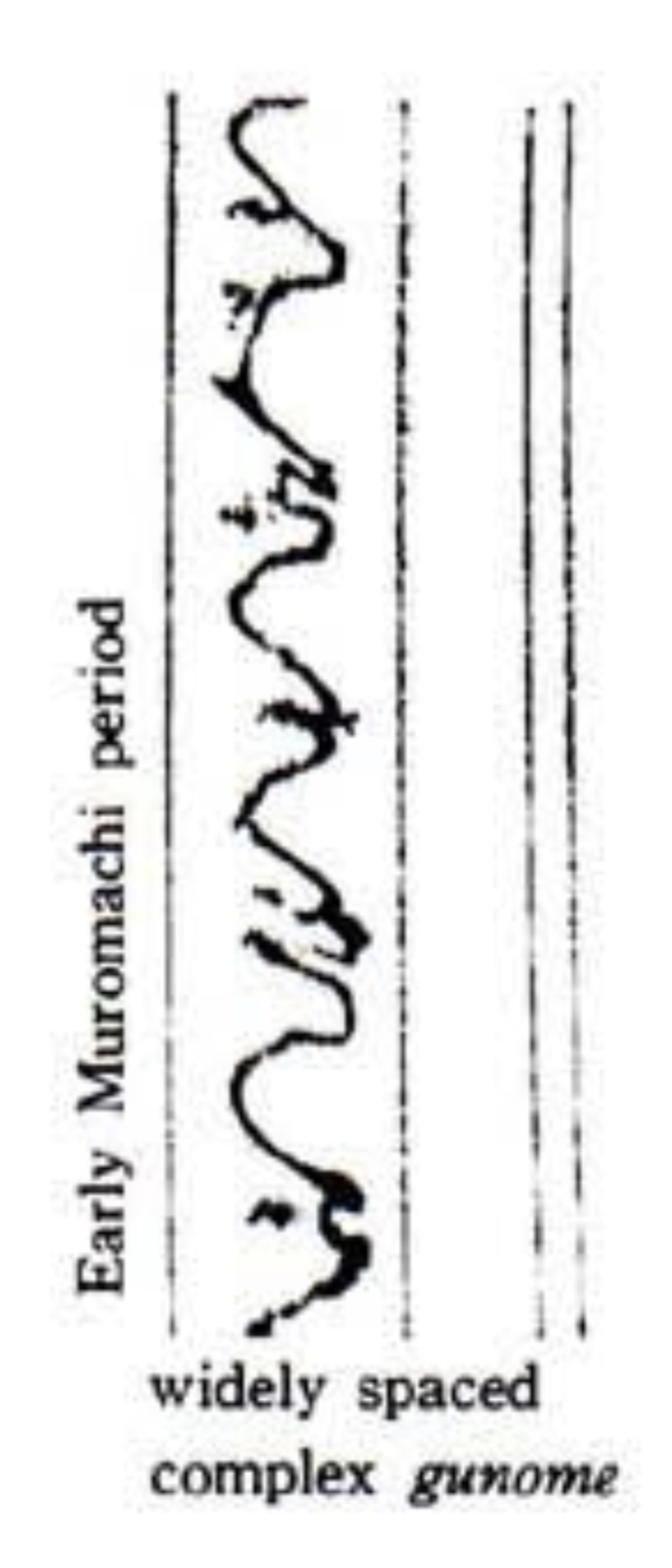

Nakago has more shinshinto (if not more recent) look - deep, widely spaced yasurime, light patina which is very patchy at the top.
However, if the drawing you made is correct, clustered choji with points looking towards each other is basically Muromachi Bizen trait. It was not really popular in shinshinto, you usually see there larger choji, and if clustered, then actually more spreading out rather than pointing towards each other.
I would check boshi, if its pourely straight then early Edo until about Joji it is. If its certainly not suguha, then conversely you can practically speaking cross over the early Edo as a possibility.

Exactly. The blade looks as old as Muromachi, but the nakago looks no older than 80-150 years imho (or like it may have been tampered with that long ago).
The yakidashi looks like it could be koshiba (though I can barely see it), and it is sharp at the ha-machi, which would suggest an older blade.
As someone younger than 20, I don't have the years of experience to know for certain. From the four showato, and at least one gendaito I have handled before, the yasurimei/file markings are deeper on the other gendai blades I've handle, and the rust is a little darker on this sword than the other gendai swords I have seen in person. Though, there is some red pitting spots on the nakago, like moisture got trapped in the handle, which may be why it looks the way it does.

As for the drawing, it is a cropped image of another sword, the hamon in the drawing is very accurate to what the pattern on the edge looks like in person.
