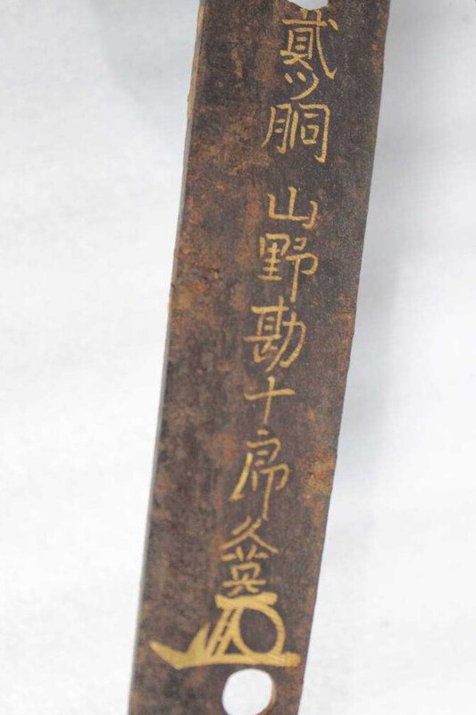

Greetings friends,
can you please help me with the translation of Saidan Mei?
Thank you very much for the advice.

三ツ胴重裁断之
Mitsudō kasane saidan kore
貞享五年戊辰十月十三日 鵣飼十郎衛尉義真
Jōkyō go nen tsutinoetatsu jūgatsu jūsan-nichi Ukai Jūrōe-no-jō Yoshizane
Three body cutting test
1688, October 13th. Ukai Jūrōe-no-jō Yoshizane
Presumably this is Ukai Juroemon who is a well-known tester. I don't know why his name is missing one of the kanji here (門).

On 9/17/2020 at 4:36 PM, SteveM said:
三ツ胴重裁断之
Ok, I believe it would be the smith's kao, too, but on this blade, the kao follows the cutting text ending in "Yoshizane", so seems confusing to me.  But it is a large kao, so maybe it simply wouldn't fit in the space following the "kore" of the smith's line of text.
One more question, if I may - the smith is Mitsudō kasane saidan?
Share this post
Link to post
Ukai Jūrōe-no-jō Yoshizane - the Yoshizane is part of the name of the tester.
The kao is the circular loop glyph after Yoshizane
The mitsudo part just means the sword cut through three torsos/corpses
I can't see a smith mei on this side

On 9/17/2020 at 3:28 PM, jelda44 said:
Saidan Mei
Thank you Matt!  I am completely unfamiliar with the testing topic.  Assuming there's no smith name on the other side, but simply the kao on this side, would it be normal practice to submit a blade, or some blades, for testing only, mumei?
Jiri,
Is there no mei on the other side?
Share this post
Link to post
Mei is not nakago. According to kanteisho, NBTHK is the author of this blade of Kuniteru with Satsuma.
Share this post
Link to post
Thanks Jiri, I'll add it to my Stamps Doc with it attributed to Kuniteru, but the plot thickens!  Reviewing my other kakihan (kao), I have another one at the end of a cutter's mei, who's name is Yamano Kanjūrō Hisahide.  Unfortunately, I don't recall where I found this, but the source said the kao was of the cutter.
Share this post
Link to post
Looks like the loop is a kaō that belongs to the tester. I couldn't find any other samples of this tester's work, so I can't say with conviction, but yes it looks like it should be Yoshizane's kaō
